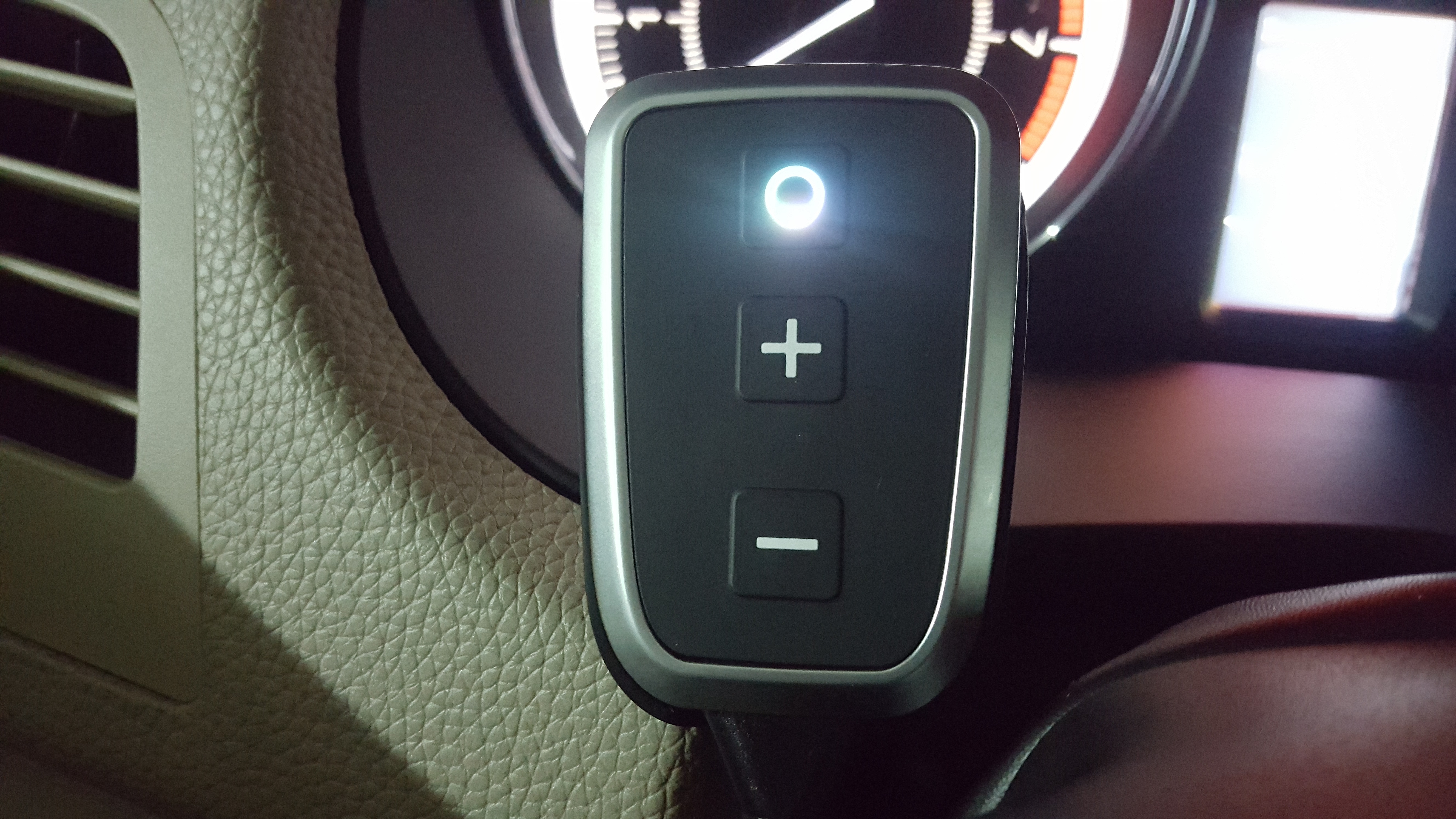

The one i like the most was the Pedal Box PLUS a new version. I order one a few weeks ago and arrives the last friday.

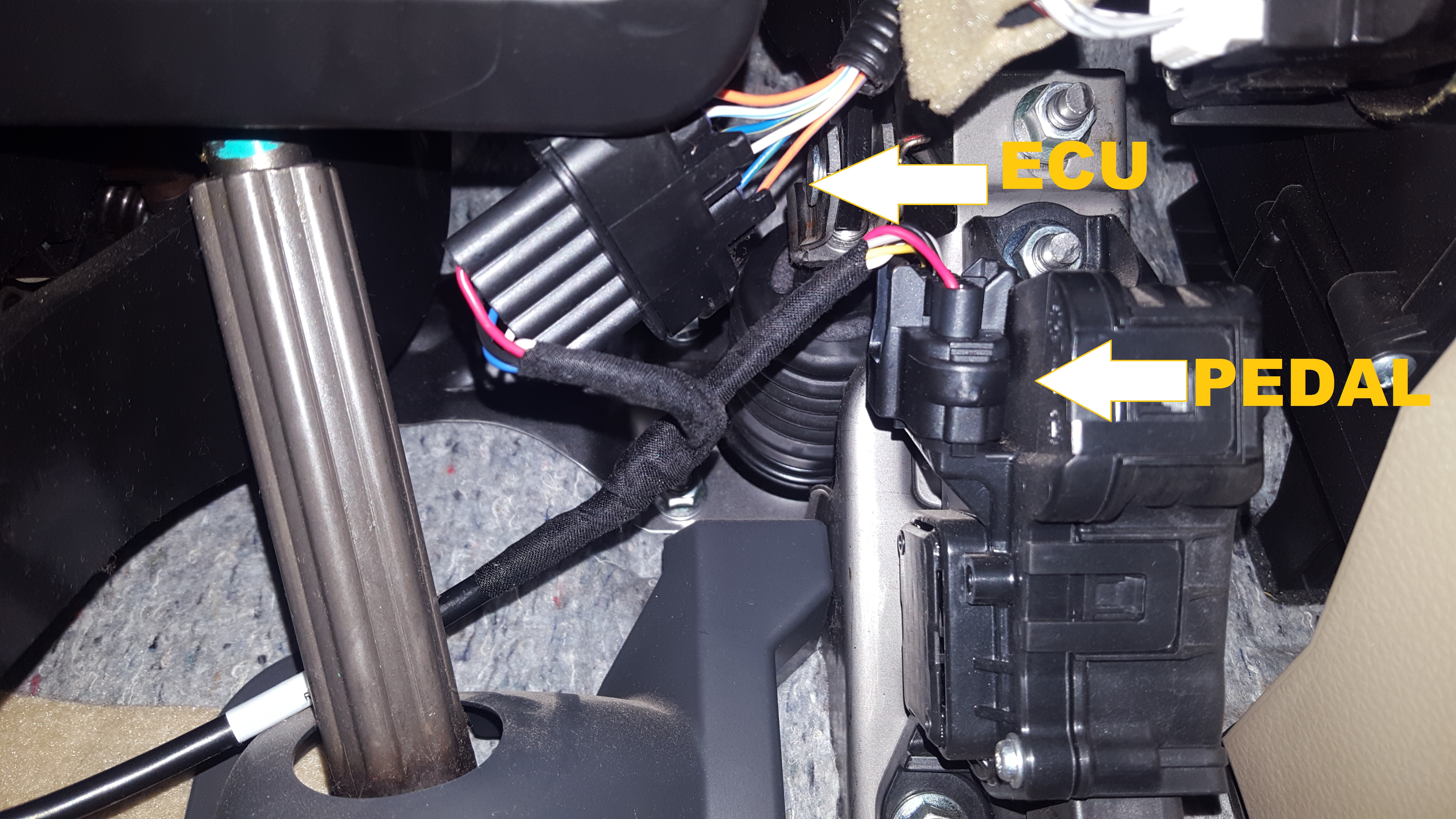

The installation is very easy, just unplug the battery (optional) or wait 5min since the last running, unplug the original pedal wire harness and connect it to the wire that comes from the module, then conect the other wire thats comes with the module to the pedal (plug and play) then run the wire module where you want to leave it.

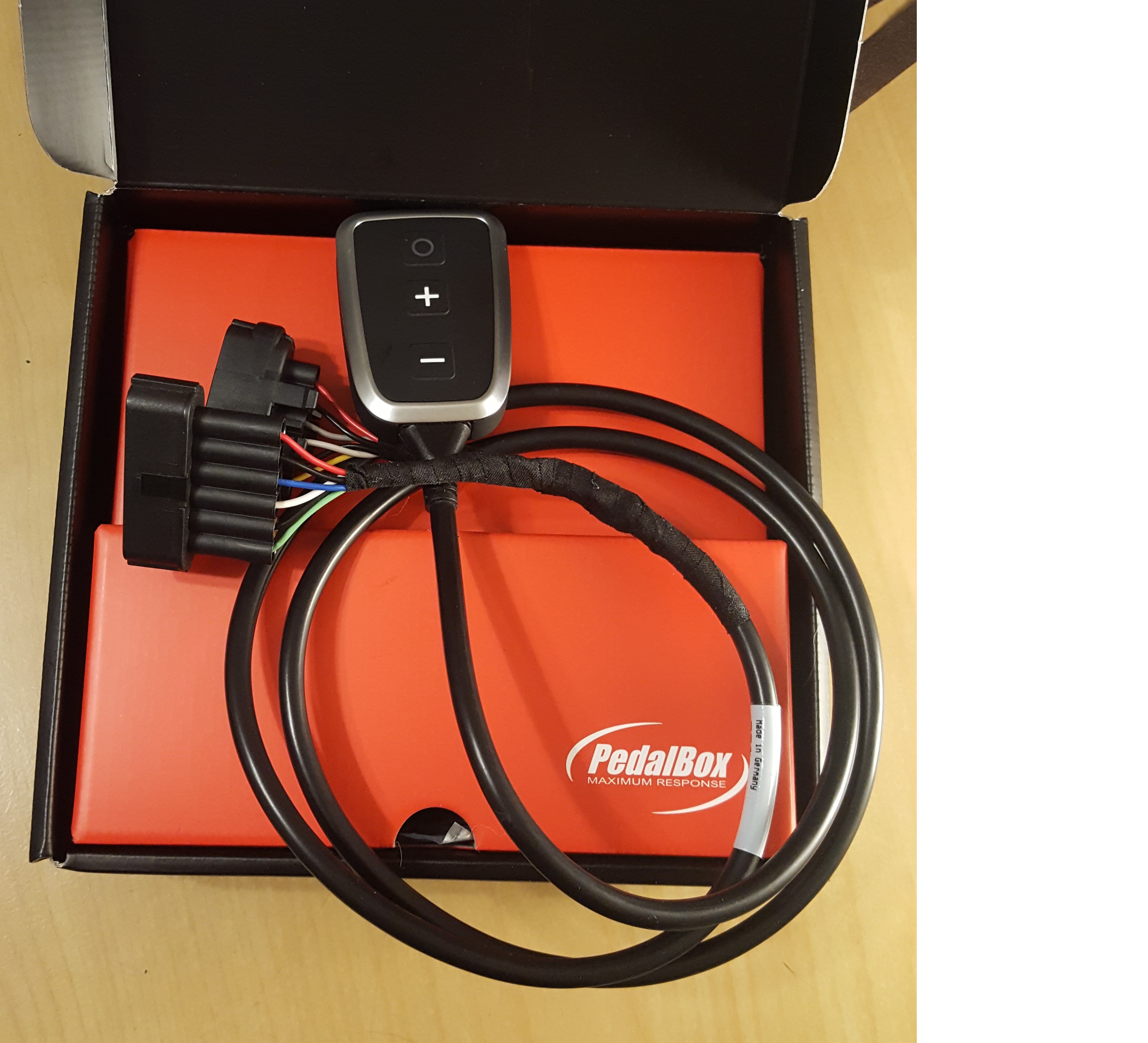

From the Box
From the Box
Sin título.jpg (2.1 MiB) Viewed 27724 times
Wiring
Wiring

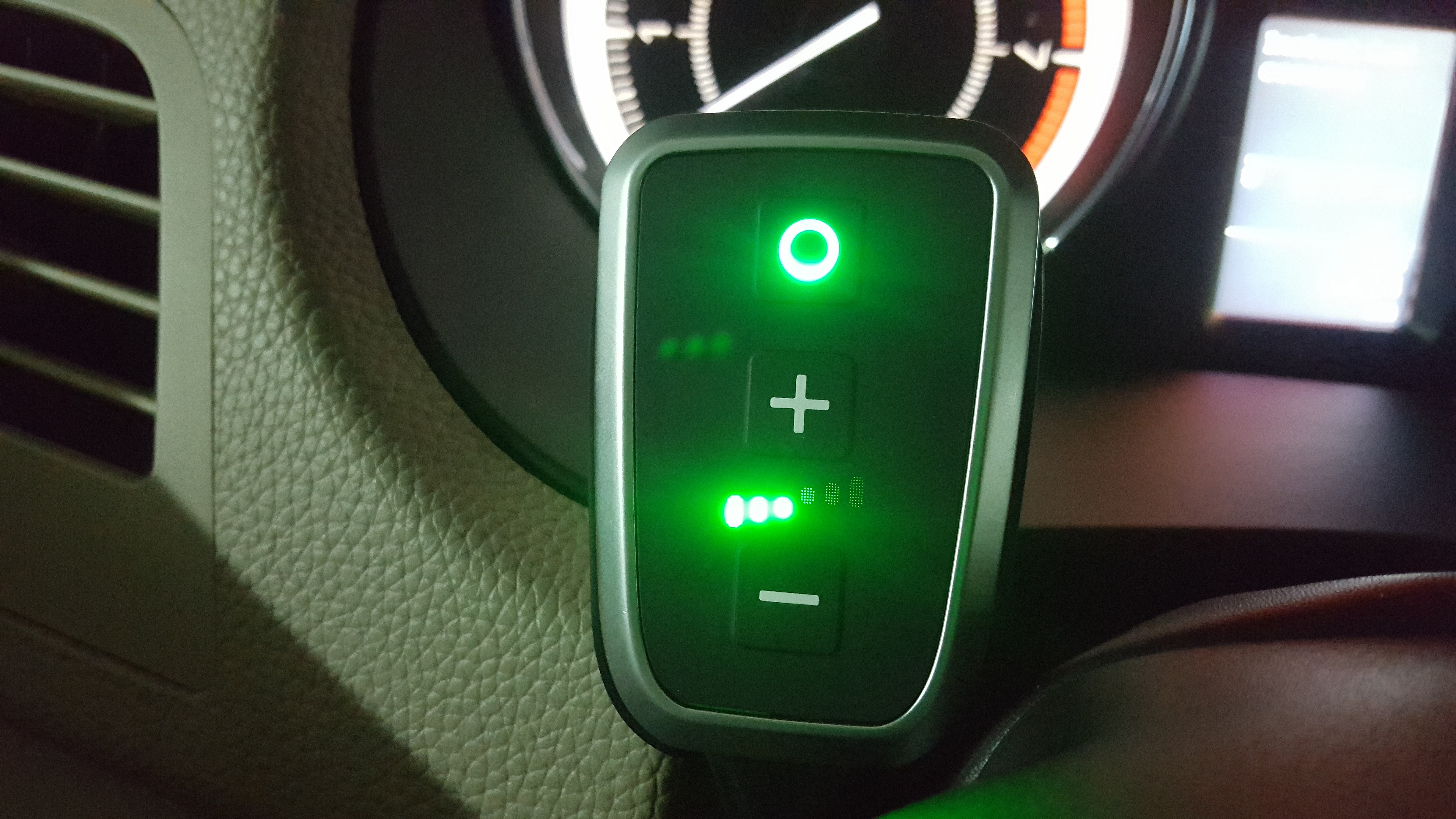

It comes with 4 programs, Stock, City, Sport and Sport+ and you can adjust the sensibility from 0 to +3 or -3.
Stock Mode
Stock Mode

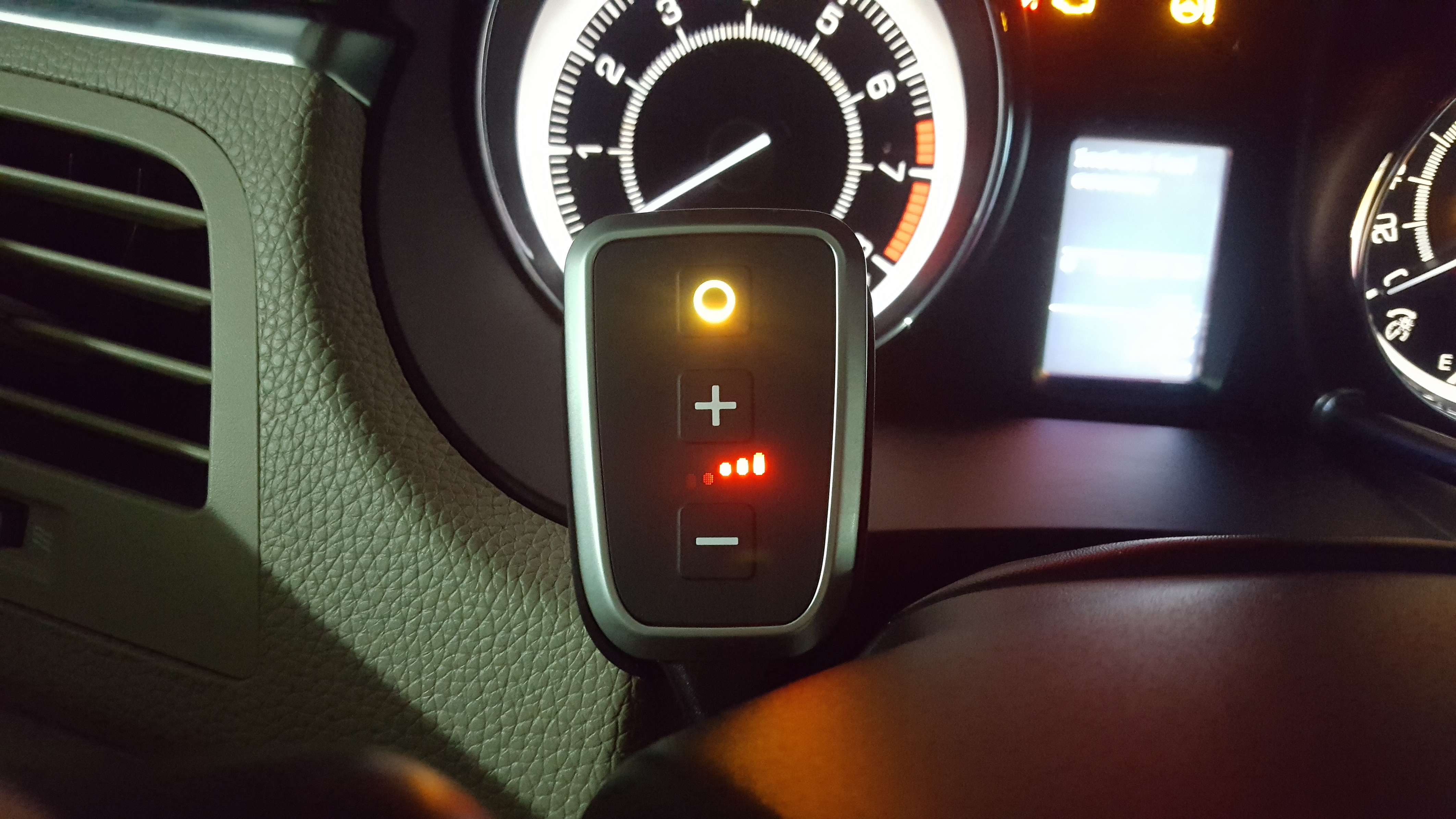

CityMode +3 regulation
City Mode
City Mode

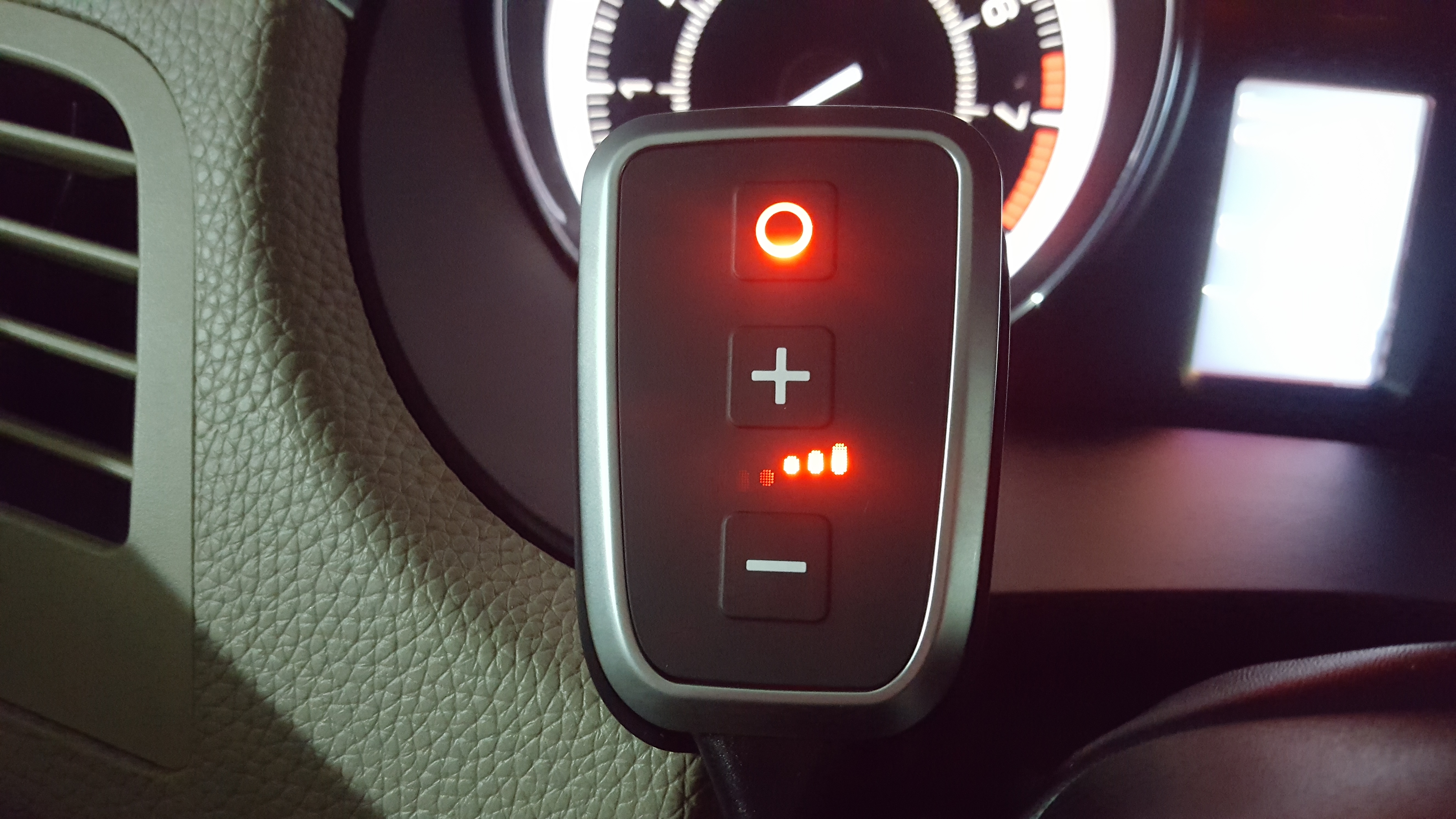

Sport Mode +3 regulation

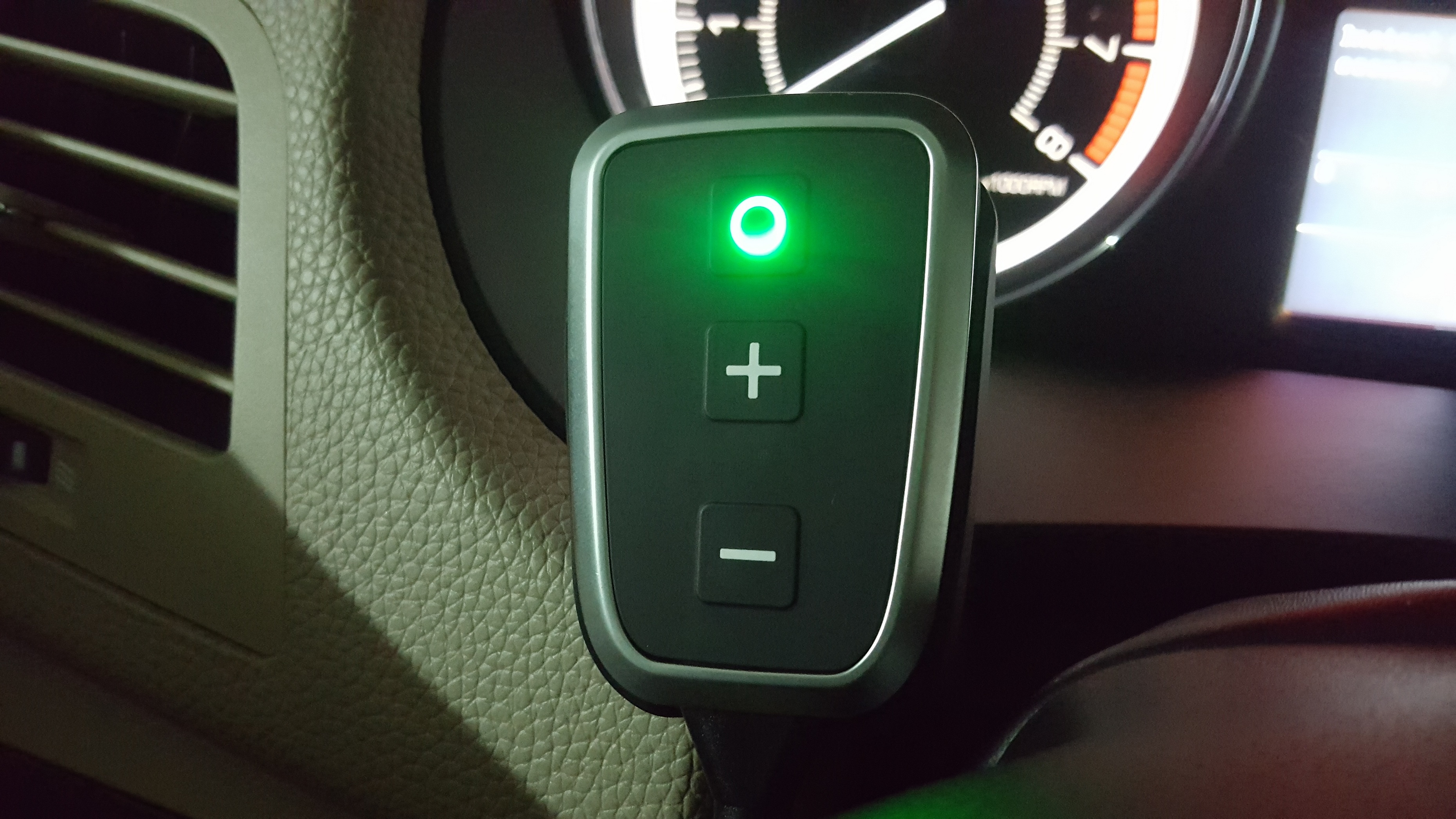

Sport Plus Mode +3 regulation
I run it in sport+ mode, the traction control comes on every time since the car just jumps from 0. I want to make some 0-100km/h to verify if there is any changes on acceleration. This module will not give you any extra HP, only will give you instant acceleration response. So the car feels a loooot better and a 100% more fun to ride.
By far the best 200euros that i ever spend on my car.
I hope you like it or find it interesting.
