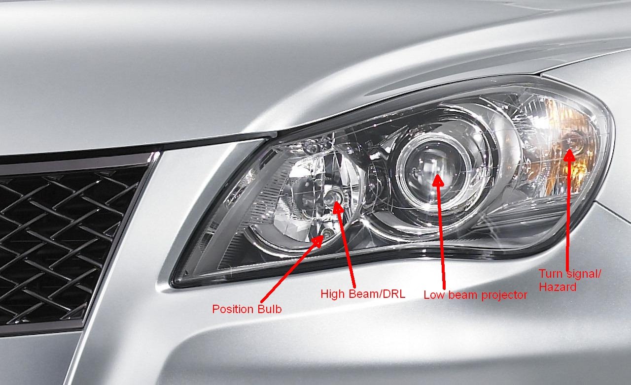

Your low beams aren't projector lenses in your Kizashi? I think all markets have low beam projectors. I am well aware that multi-reflector headlights (classic design) will shine the LED light differently than a projector lens. I just assumed you put the LED kit in the Kizashi's low beam projector.
Just to be clear, I've labeled the Kizashi's headlight in respect to their bulbs and what I'm referencing.
Labeled Kizashi headlight.jpg (155.36 KiB) Viewed 16460 times
