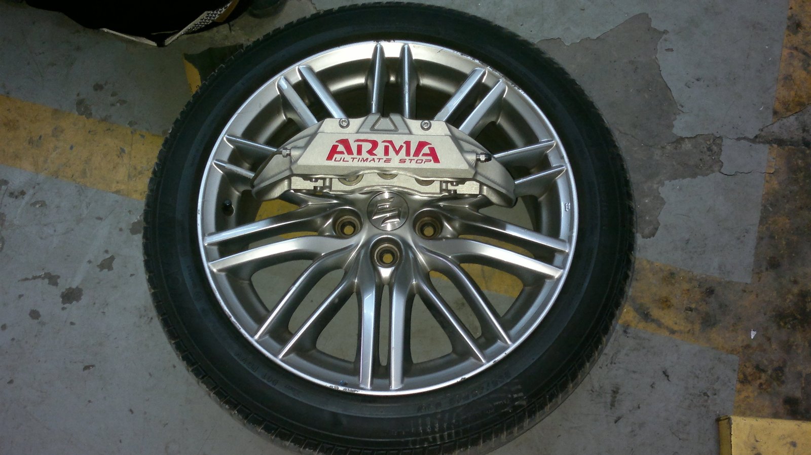

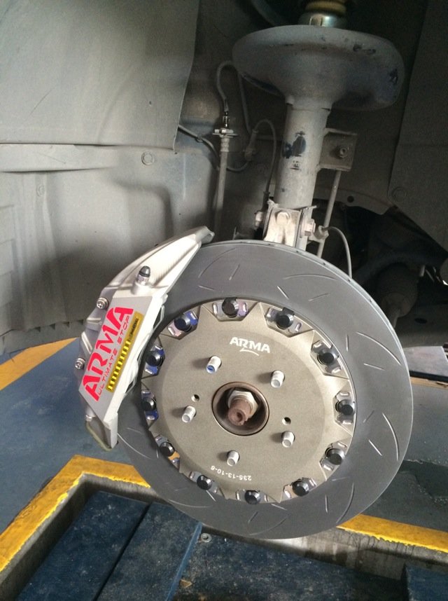

this is my $2000 :mrgreen:

Yo that looks sick!!

Love the kits guys! Is the Arma kit completely bolt-on, or custom?
I'd check the fitting at the end of the TRD caliper to see what type it is (banjo, etc.). Then you can see if the stock Kizashi line will work with the stock bolt in the caliper. Line length and clearance is usually the issue, but since the caliper is essentially in the same place, I don't see that as being that big of a problem.
What car is that TRD kit for again? If we can find a cross reference for a Toyota kit that bolts-on (even factory parts), then we could find an upgrade for that application and in theory it would bolt right on. That's how I found the kits for my Galant and Accord. :)
