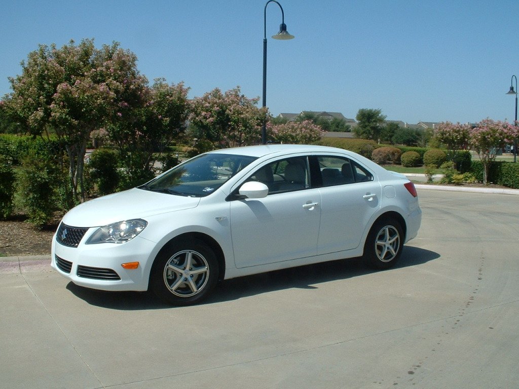

I have a 2011 S model manual transmission Kazashi and I am going to do BUDGET mods on it and report back each time. I want to AVOID doing anything that would cause the Check Engine Light to come on so the mods will be relatively easy and cheap to begin with.
So my Kizashi is STONE QUIET stock. You cant even hear ANY engine sound at all! Got to hear some sound from the engine but since I drive on the highway on trips a lot I dont want to be DRONED to death. So I am going to perform 1 step at a time, see the results, and then plan from there.
The exhaust system has: Cat Converter, 2 reasonators, middle muffler, 2 tip mufflers. I dont have the bucks for a CAT-BACK system nor access to a welder to install it AND I want to retain the stock exhaust tips at the rear of the car.
The goal with the exhaust is to take off the 2 resonators plus the muffler located in the middle of the car BUT retain the 2 stock rear tip mufflers.
FIRST UP IS THE MUFFLER LOCATED IN THE MIDDLE OF THE CAR
Your local muffler shop should be able to take the middle muffler off and put in a niece flared pipe in its place for $30.00 or less. Mine charged $25.00 to do it.
RESULT is there is a TINY bit more sound but you are replacing a 20lb muffler with a 2lb pipe. I honestly thought the sound would be louder but its not THAT big of a difference. The sound IS slighly noticeable. Easy & safe MOD.
My 2011 Kazashi Budget Build
