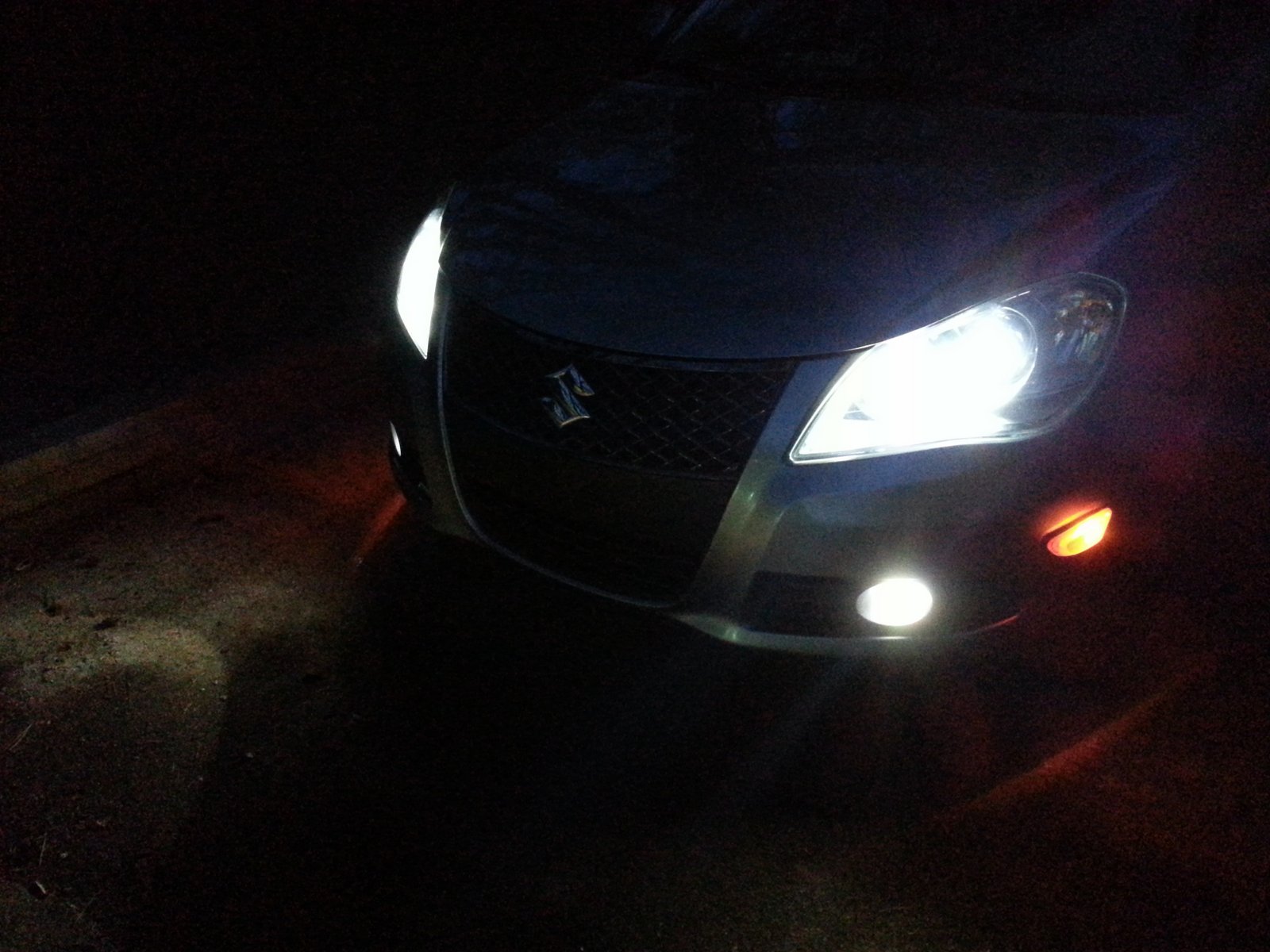

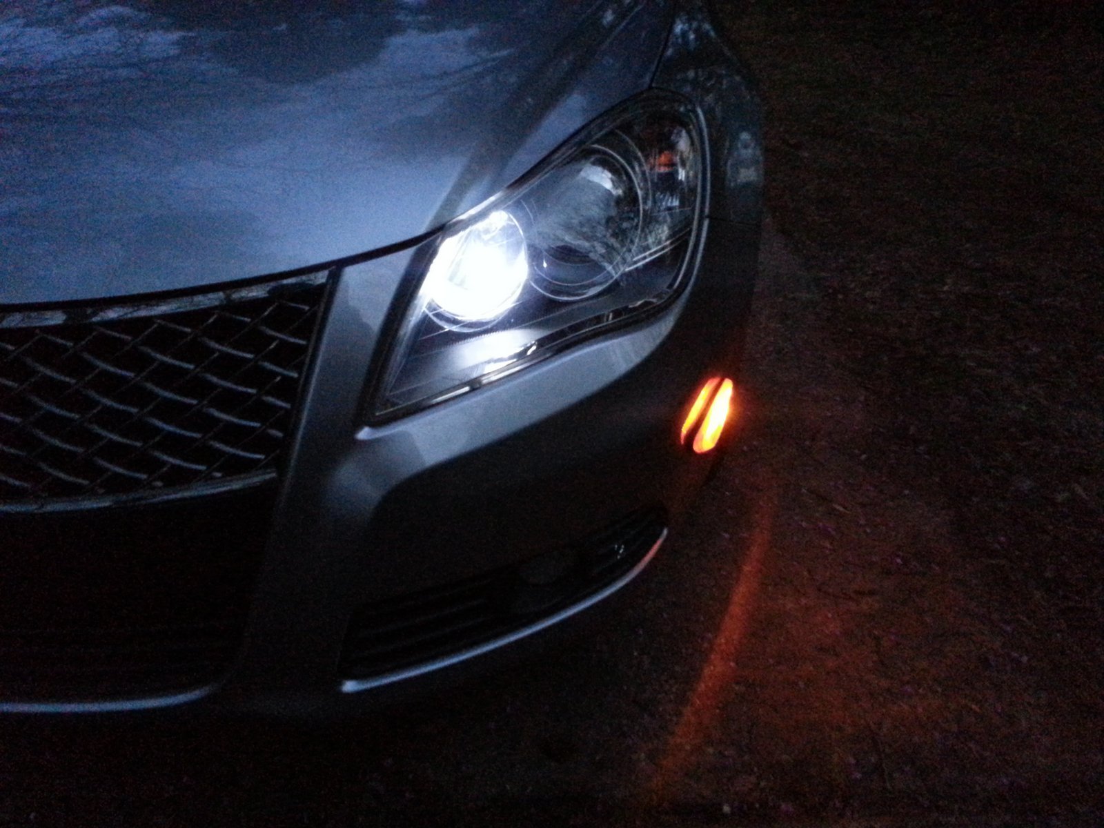

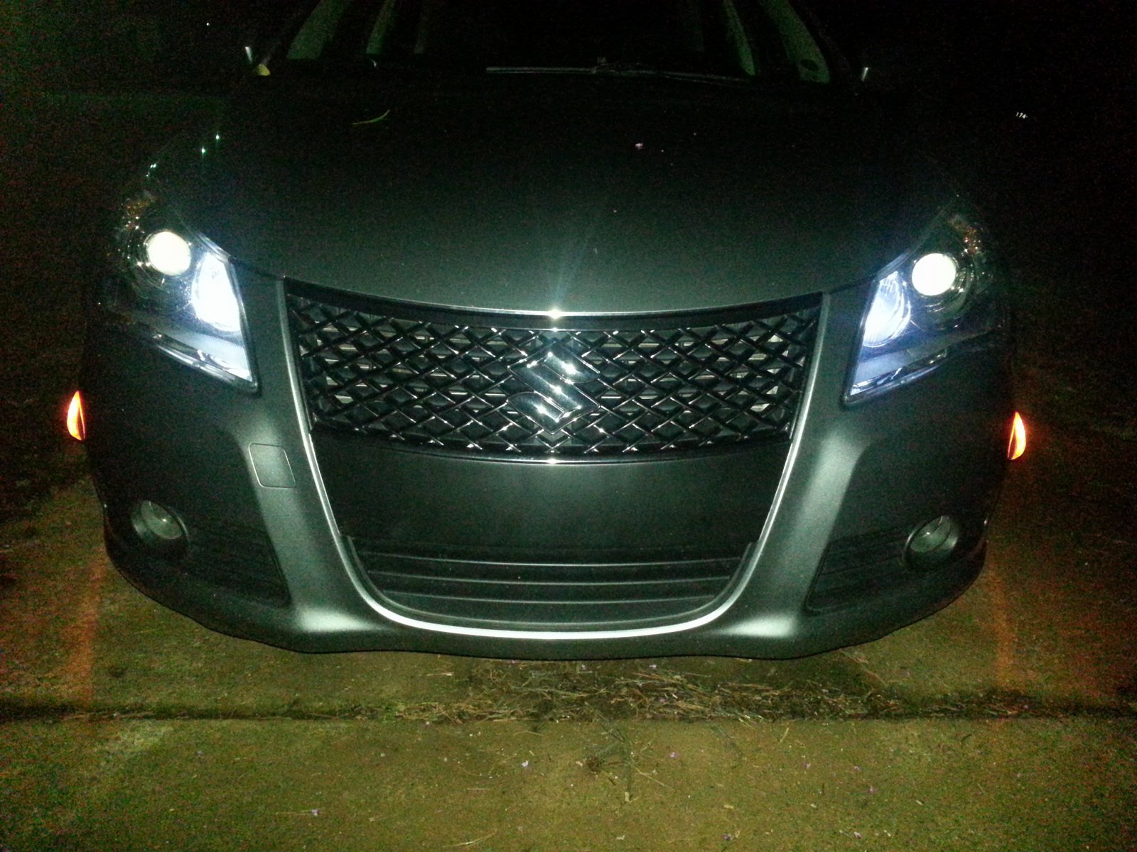

HID low beams and LED everything else. Blacked out bumper with plasti dip, and Led fog lights and position lights.

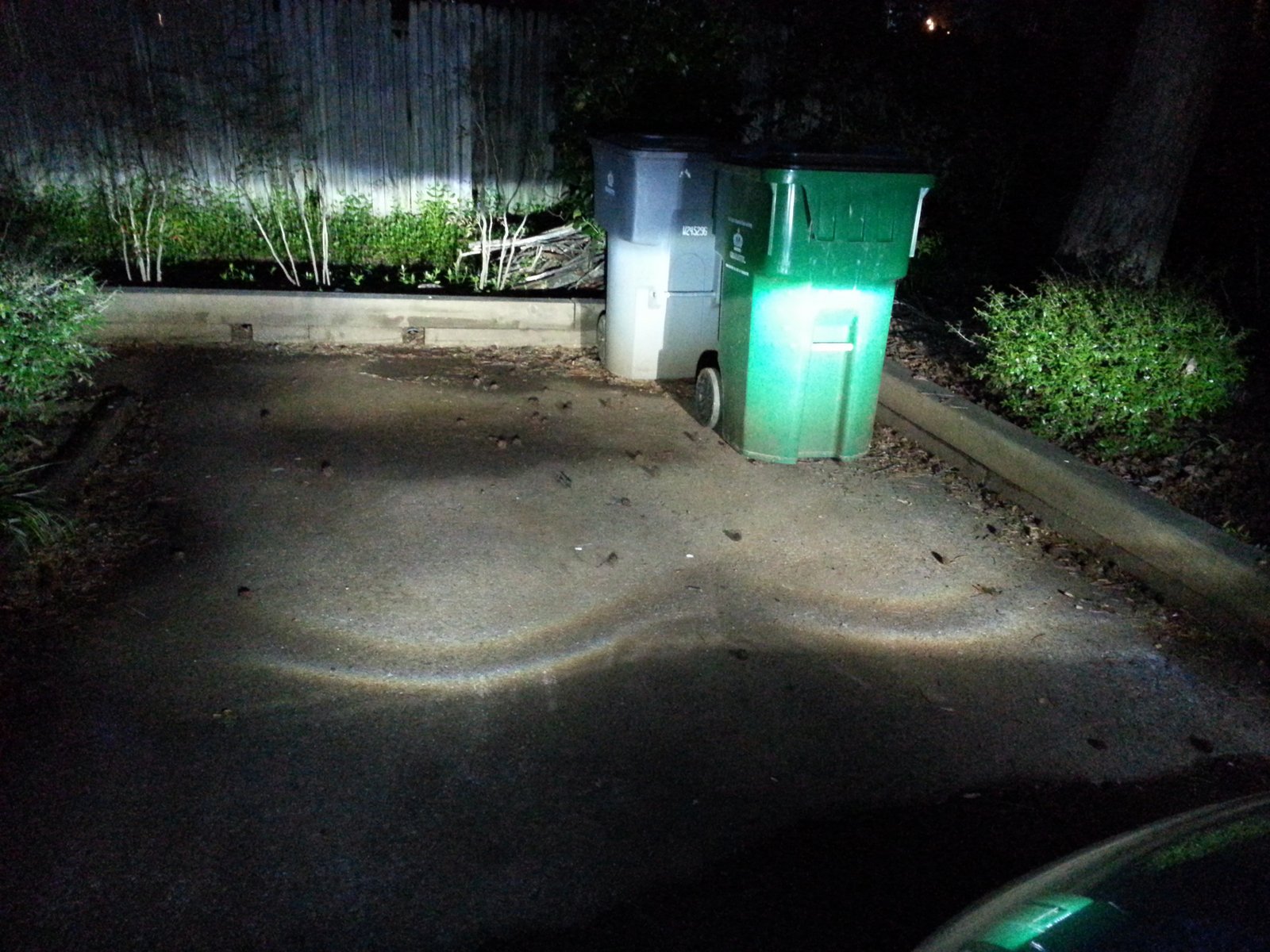

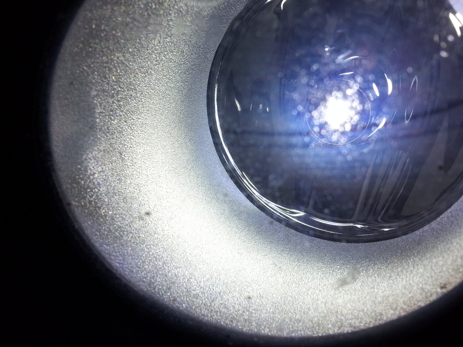

Low beam HIDs 6000k
- image.jpg (228.2 KiB) Viewed 8441 times
- image.jpg (338.36 KiB) Viewed 8441 times

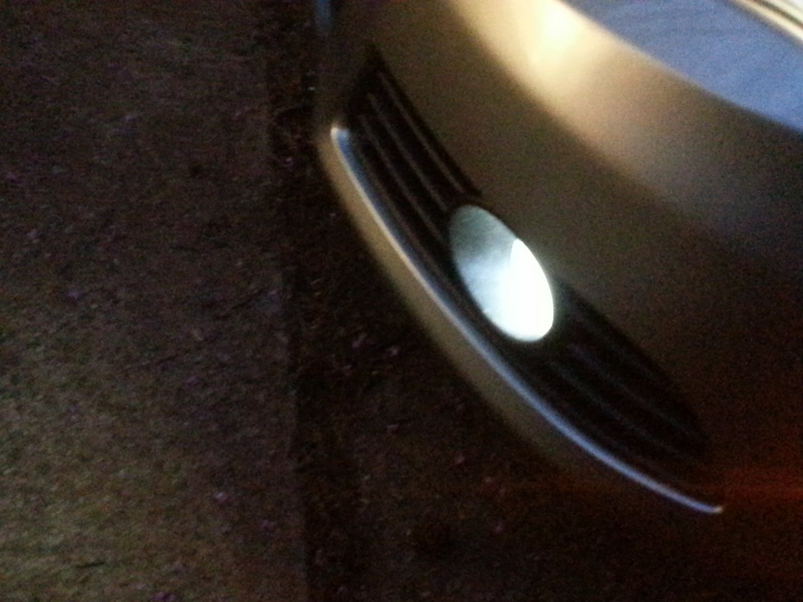

Are your fog lights still as functional as they were with LED globes? Ive been considering the same set up but I use my fog lights a lot, for some reason I imagine LEDS wouldn't be as affective in there.

Wonson if you need them as fogs I'd stay away from the LEDs. They are much much brighter than I thought they would be but the stream of light isn't up to par as traditional fogs. But they are pretty. Mine were pretty much plug and play and I got a relay as well so it would pull from the battery too. But i used alot of electric tape just to cover any open ends.
Special thanks to KuroNekkos tips - I wouldn't have tried if he didnt make sound so easy. I mounted the ballasts on the side of battery with the help of some wire ties and the other on the left is on the side the washer fluid lid.

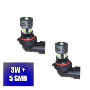

High beam/DRLs
Fogs

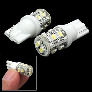

Positions and the interior/door lights If anybody wants links to them let me know. I got everything super fast courtesy of standard or free shipping.

High beam/DRLs
Fogs

Now it looks like I need to adjust the beams because they are a little too high for my liking after taking it on the road.

As for the fog lights, what rbulter said is right. LEDs just don't output much light to see, but do a decent job of being seen.
The good thing about the fog light housing is that it does not have a bulb shield that blocks the center of the bulb. This allows for maximum light output.

Position bulb: 6000K LED
