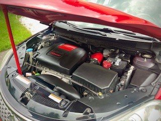

2011 Kizashi engine bay - custom silicone tube, WIX filter, TB coolant bypass

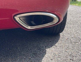

Stock the Kizashi has two cats and three mufflers - mid pipe replace with 24"" cherry bomb and two rear mufflers replaced with cherry bomb turbo mufflers - sound is deep, no rasp

Is there any way to see bigger picture or it is small because the way it was posted ?

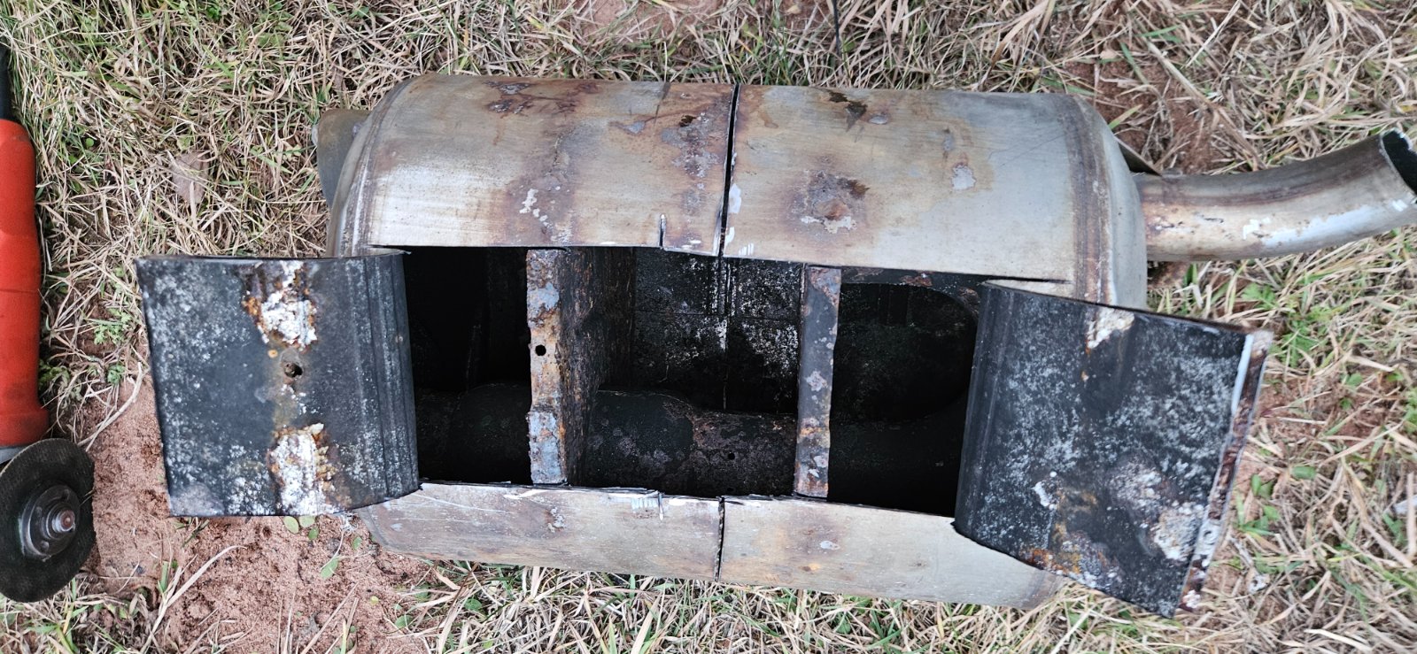

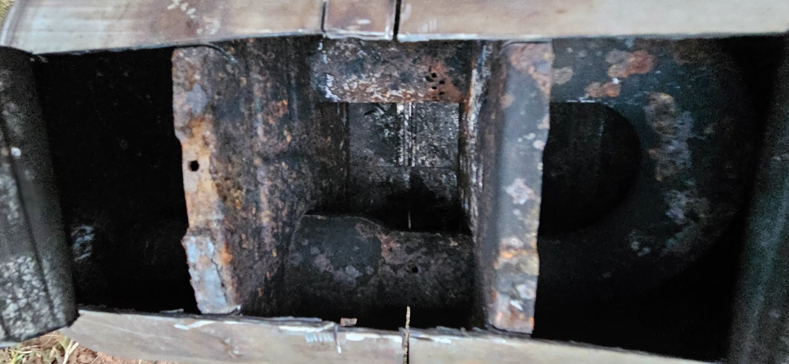

I sawed the rear muffler in half to see what was in it. I guess only the center muffler has the catalytic converter in it
