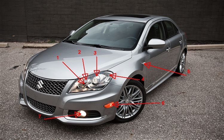

No, no Thats not what im talking about i know that bulb. The other side of the lenssorry about the confusion

Still a little too ambiguous as I was talking about the "other side" the first time.
Let's eliminate ambiguity and use the reference below.
1) Position Bulb
2) High beam/DRL (same bulb used)
3) Low beam inside projector housing
4) Turn signal bulb
5) Fender-mounted side turn signal bulb
6) Side marker bulb
7) Fog light bulb
Now which one are you talking about?
1) Position Bulb
4) Turn signal bulb
6) Side marker bulb
7) Fog light bulb

It is apparently the position bulb. I've always called it the Daytime Running Light. Online I found LED's for the bulb, but being called Auxillery lighting. So that should cover my problem. Thanks for you're help.
Suzuki Kizashi SE AWD
Great to clear that up. I did a write up on changing the position bulb if you want to check that out in the DIY section.SuzukiGirl14 wrote:It is apparently the position bulb. I've always called it the Daytime Running Light. Online I found LED's for the bulb, but being called Auxillery lighting. So that should cover my problem. Thanks for you're help.
Also, note: these only come on when the headlight control is either Headlight ON or the midway position (position bulb). They do NOT turn on while the headlight control switch is in the OFF position. When headlights are OFF, the DRL is what comes on. The DRL is the high beam at low wattage. If you drive with the midway position on, then you drive with position bulb on PLUS the DRL. The DRL ONLY goes off when the low beams are ON. When low beams are on, its low beam on PLUS position bulb.
If you have the midway position on and you pull the handbrake up, the DRLs will turn OFF, but the position bulbs remain on. This is why they actually exist. They are to mark the car's presence (or position) without using the headlights.
This is important in Japan (where our cars are from) because Japanese driving etiquette is for drivers to turn off their low beams while waiting at an intersection. To still have light to show that a car is present, this is where the "position bulbs" come in. They offer a low, pleasant light to show that a car is there without possibly annoying or blinding oncoming traffic. They don't have the same DRLs like we do so the position bulb does more in the JDM.
LED upgrades to position bulbs are very popular in Japan and I got my PIAA LEDs without even searching hard when I was in Japan.
