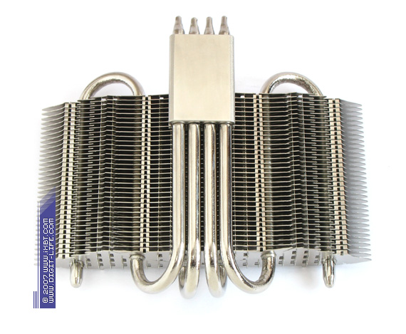

:!: Thinking outside the square for cooling methods that will remove the heat from inside the head light.:
Something like the remote "heat pipe" heat sinks used on PC graphics cards would work wonders. Run the piping from the LED module, through a waterproof seal to a remote heat sink in the engine bay.... eg. like this http://ixbtlabs.com/articles3/cpu/vpu-c ... part1.html
Or, a coolant based system like people use for CPU's. Like along these lines http://quietpc.co.uk/reserator1-v2 You could substitute the coolant radiator from an air to liquid intercooler.
Or use this as the remote radiator to get rid of the heat http://www.thinkcomputers.org/swiftech- ... reservoir/
There are all sorts of possibilities for an external cooling system to keep the heat down- if you're keen. :o
