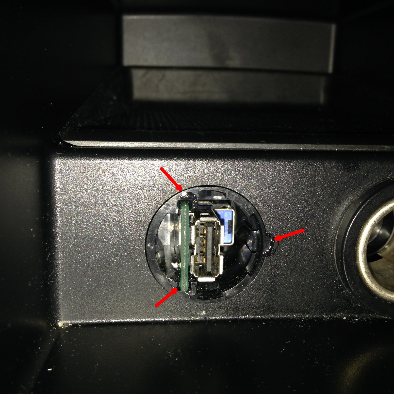

Thank you for the pictures on how to fix this! One way to avoid this will be to simply get a short usb extension cable. This will remove any load off the port in the car and avoid this issue in the first place.
So the USB housing plate broke again, although the USB port did not fall out, but only thanks to the USB cable in it.
I decided to redo the fix and superglue some critical points because the design of the apparatus is not good and very susceptible to breaking from normal use.
I removed the USB housing plate (square part with the USB logo) and re-superglued the broken hook on the rear (the actual reason why the USB port slips out). I then decided to actually superglue some parts of the USB's circuit board to its plastic housing that attaches to the USB housing plate.
This prevents the USB port and the circuit board from moving when the USB cable is pushed or pulled as the movement is what breaks housing plate's clip. I then also superglued the back of both clips on the housing plate and clipped it back on. Basically, the whole thing is reinforced with superglue at critical points.
Let's see how this holds up as I usually swap between USB devices that require different cables.
The photo below is of the USB port in its housing as it fits in the console. The red arrows indicate where I applied a drop or two of superglue to prevent unwanted movement when the USB cable is inserted or removed. I also applied superglue to the housing plate's clips which break easily (not pictured).
