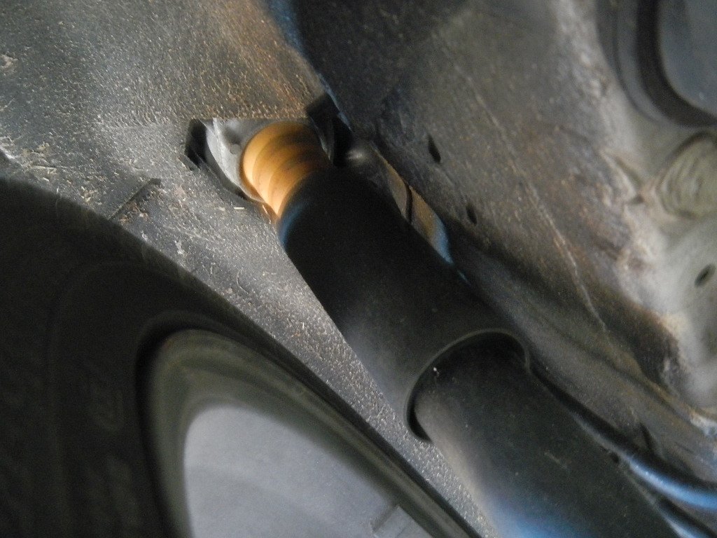

paininthenuts wrote: Mine is a late car. Do you think the design may now have been changed
I doubt it but you can go easily check yourself. Look into the rear wheel well and you'll see either a white, cream, or yellow plastic-like part behind the wheel. That's the bump stopper. If it has longitudinal grooves in it, you have the countermeasure part. If not, then you have the old one.

This is it, what do you think ?

Doesn't look like it has any grooves. Here are comparison photos: http://www.kizashiclub.com/forum/viewto ... 178#p24178

bootymac wrote:Doesn't look like it has any grooves. Here are comparison photos: http://www.kizashiclub.com/forum/viewto ... 178#p24178
Excuse me for being stupid. Apart from the colour they exactly the same to me
It looks to me you have the older type. I don't see the groove. Yours is also the same color as the older types seen on Kizashis all over the world including mine until I got them replaced.
Here is a picture of the groove we are talking about.
http://www.kizashiclub.com/forum/downlo ... hp?id=1739
The Technical Service Bulletin discusses in detail how the grooves are intended to channel water out of the bump stopper.
