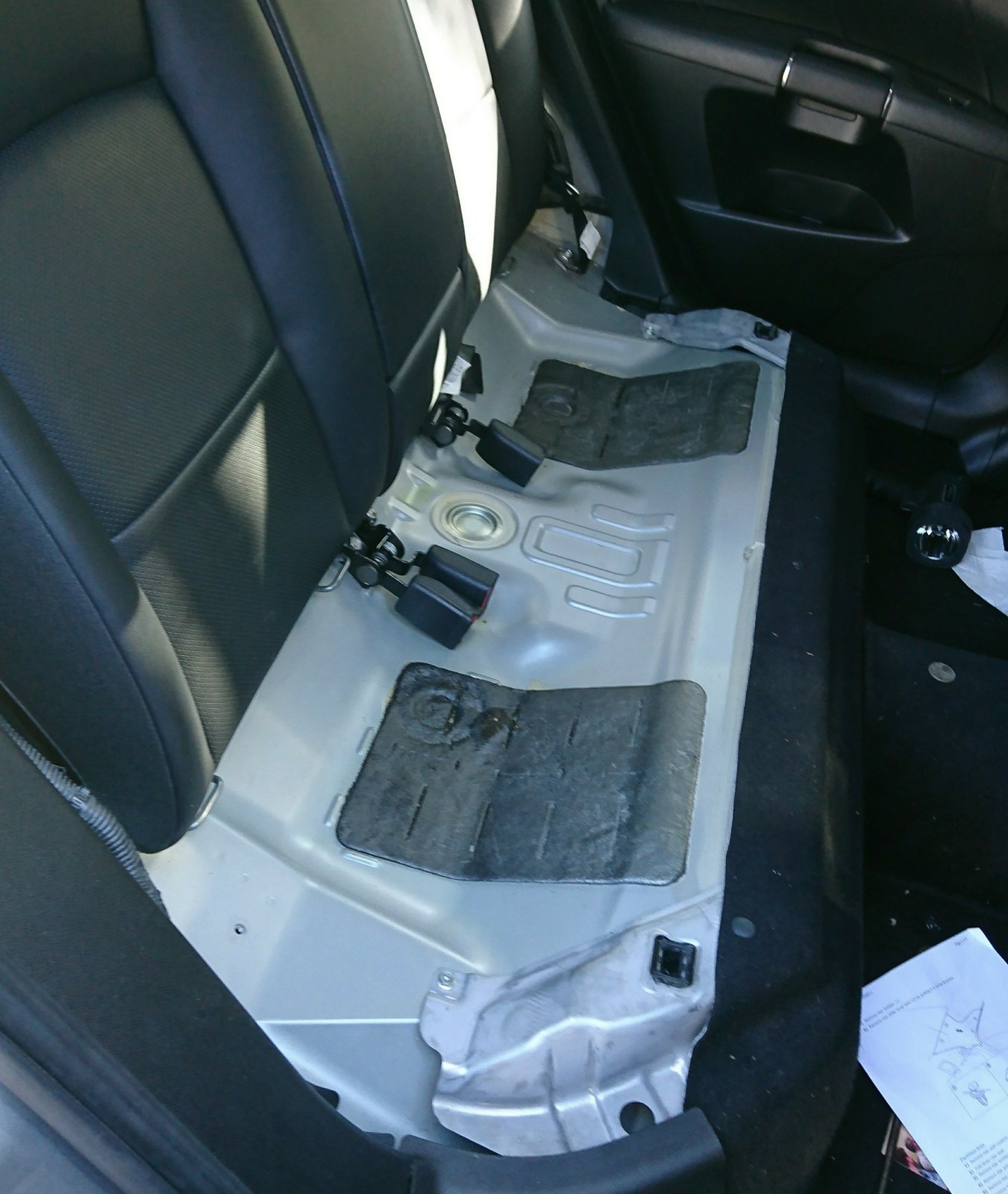

Had to remove a fair amount in order to get the parcel off, also did a fair amount of cleaning - turns out the previous owner's kids were absolutely disgusting. But managed to do it.
Figured out it was the cone. Ended up contact gluing it back on - just to help protect the magnet from dust and etc. If it happens again at least I'll be able to remove everything easily and chuck the cone. But I'll leave it for now.

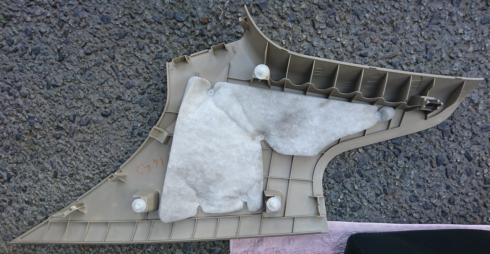

Late reply, but sort of. Found a very basic removal guide. From memory I had to remove, not in this order, rear seats (flat seats, not back/foldable seats), c pillar, some plastic covering on either side and the arm cushions beside the door. Plus lots of screws/clips.

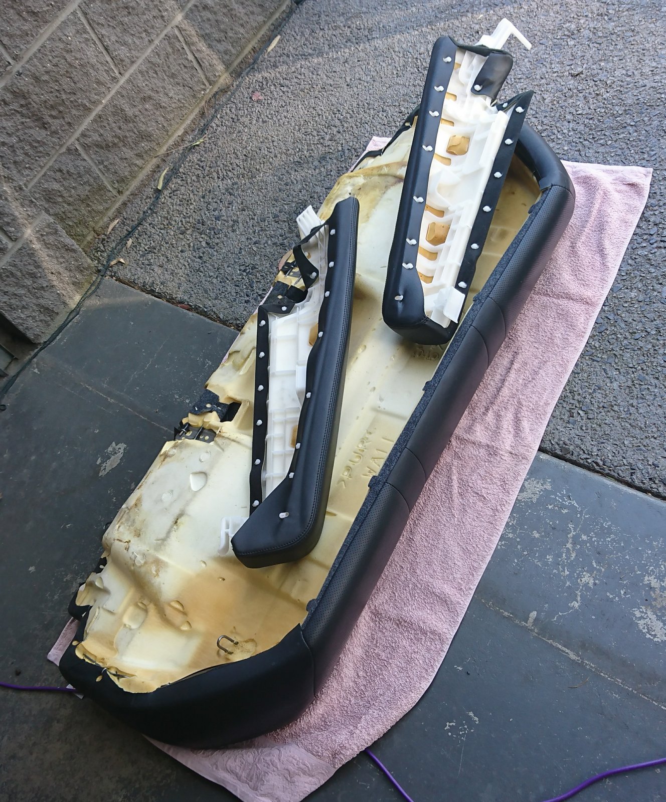

P.S. notice the discolouration on the bottom of the seats? It was a hundred times worse before this photo.
