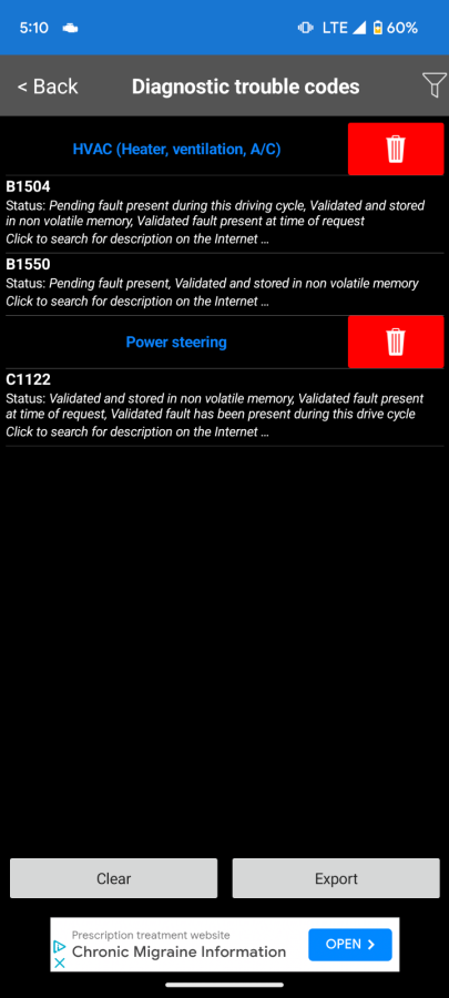

These were the codes pulled from the car. Is it worth buying at $5500? Or should I just wait for something else to come along?

These codes are actually normal. The power steering throws this code when the codes are checked with the engine off. If you start the car check the codes, this goes away. The other codes are with the automatic air and I see them often there’s no problem.

old tech wrote: Tue Oct 10, 2023 7:58 pm These codes are actually normal. The power steering throws this code when the codes are checked with the engine off. If you start the car check the codes, this goes away. The other codes are with the automatic air and I see them often there’s no problem.
I figured as such. I ran the codes in accessory mode, which is what I'm used to doing. The AC worked fine, so until it becomes an issue I'm not gonna bother. Overall, is this car a good buy?
