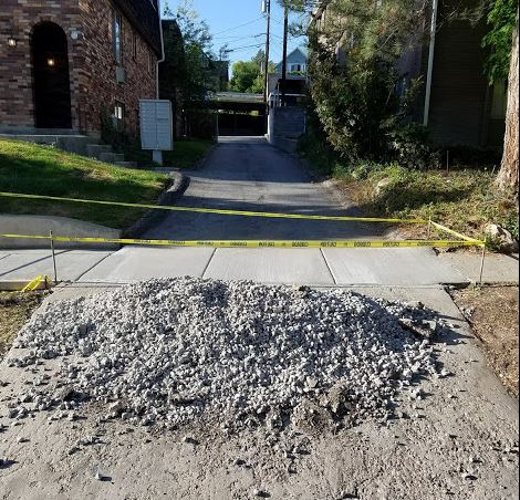

My Kizashi has been sidelined for the past two weeks. I went on vacation for six days and came home to a cordoned off driveway and a pile of gravel. The city required some sidewalk work at my apt complex while I was gone.
No problem...it should be gone in a day or two right? Wrong...the city took down the tape but left the gravel. My property manager didn't know about it either. So while they all point fingers at who should clean it up, I'm stuck riding the motorcycles everywhere.

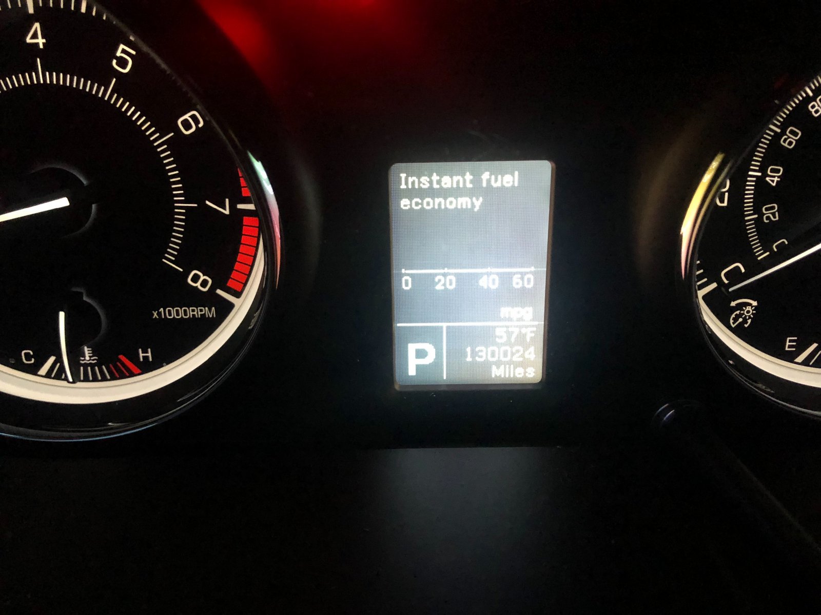

Passed the 130,000 mile mark about 30 minutes ago on my way to work. Still the best vehicle I’ve ever owned.
