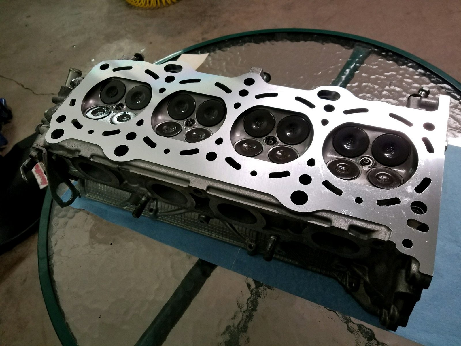

It's progressing again. I've been balancing working on the white car and the black one. I took the engine off of the transmission and took it to the machine shop to verify flatness. They measured the block to be within 1.5 thou and the head was out by 9 thou. I decided to have them clean, machine, and vacuum check the head. They ended up taking 10 thou off. So it's on the way back together. I'll have it done soon and we'll see how it runs.

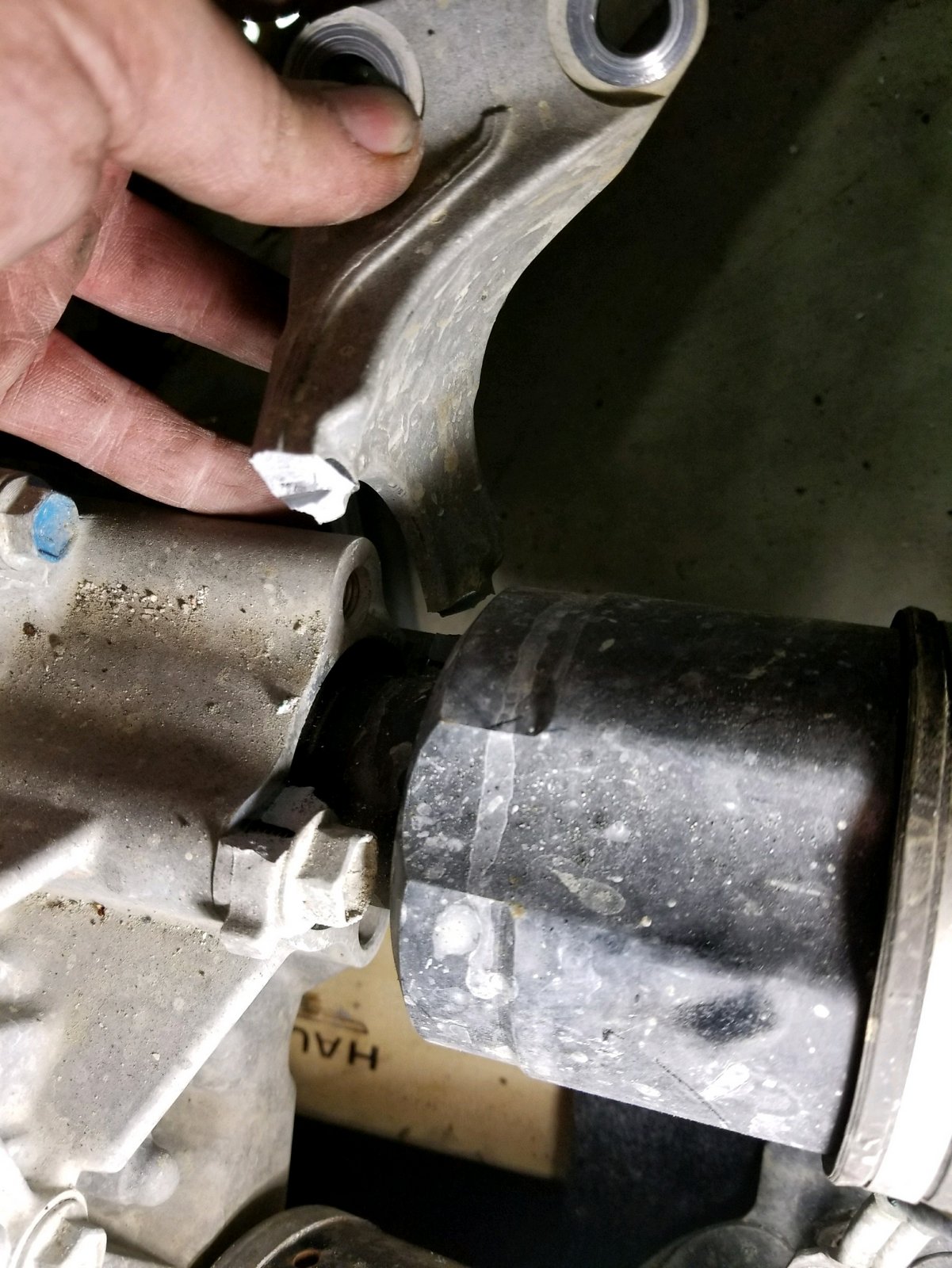

I broke this bracket that is fastened to the engine block and transfer case, near the passenger side axle. I've been having a hell of a time finding a replacement. It seemed to break very easily. Still working on getting a replacement.

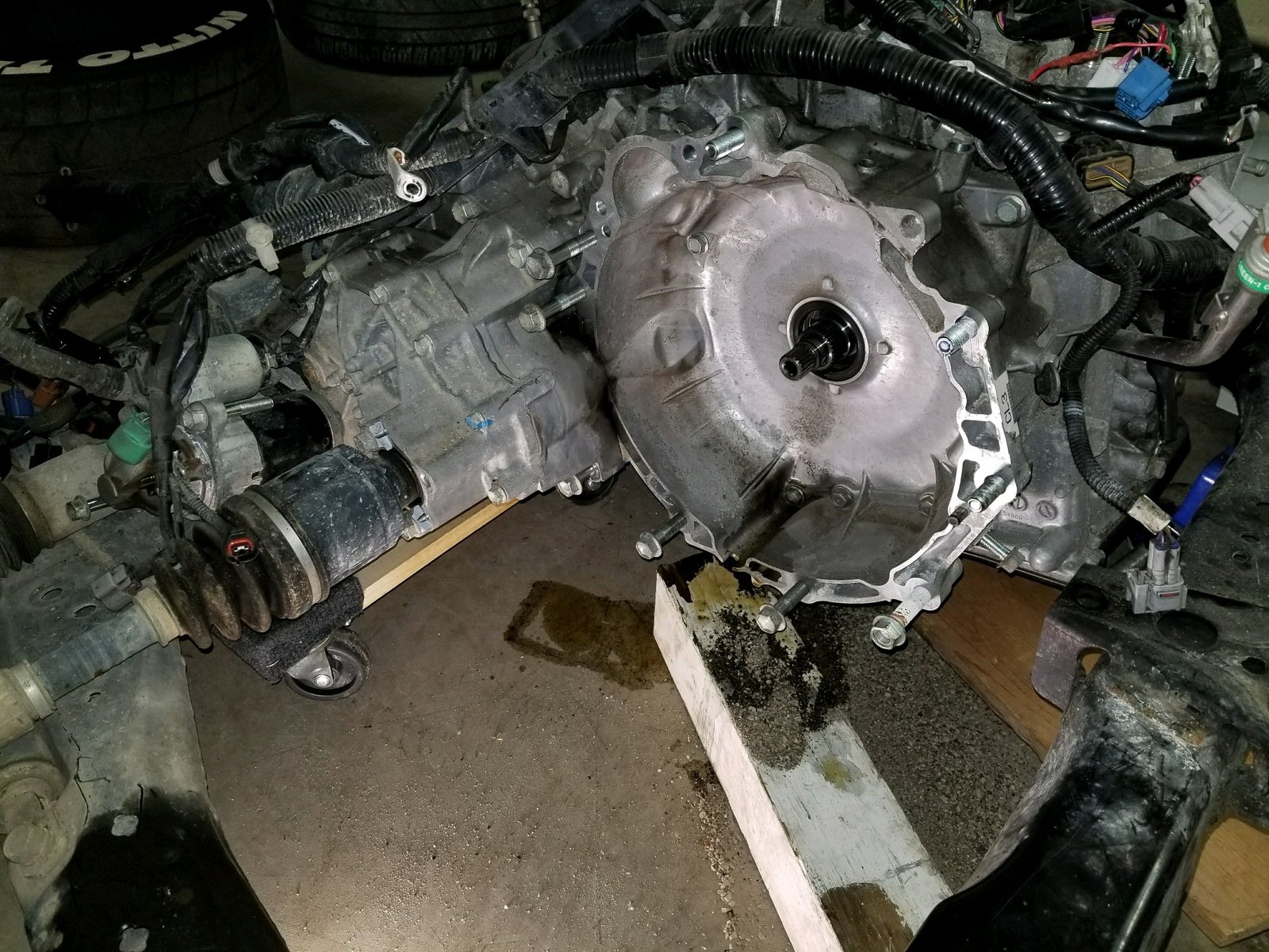

Here is a shot of the transmission with the engine removed. You can see all the bolts sticking out that I had to remove. They are different lengths so pay attention to where they go back into place.
Here is a shot of the head that was resurfaced. In the lower right, its says 010 indicating 10 thousandths was taken off.

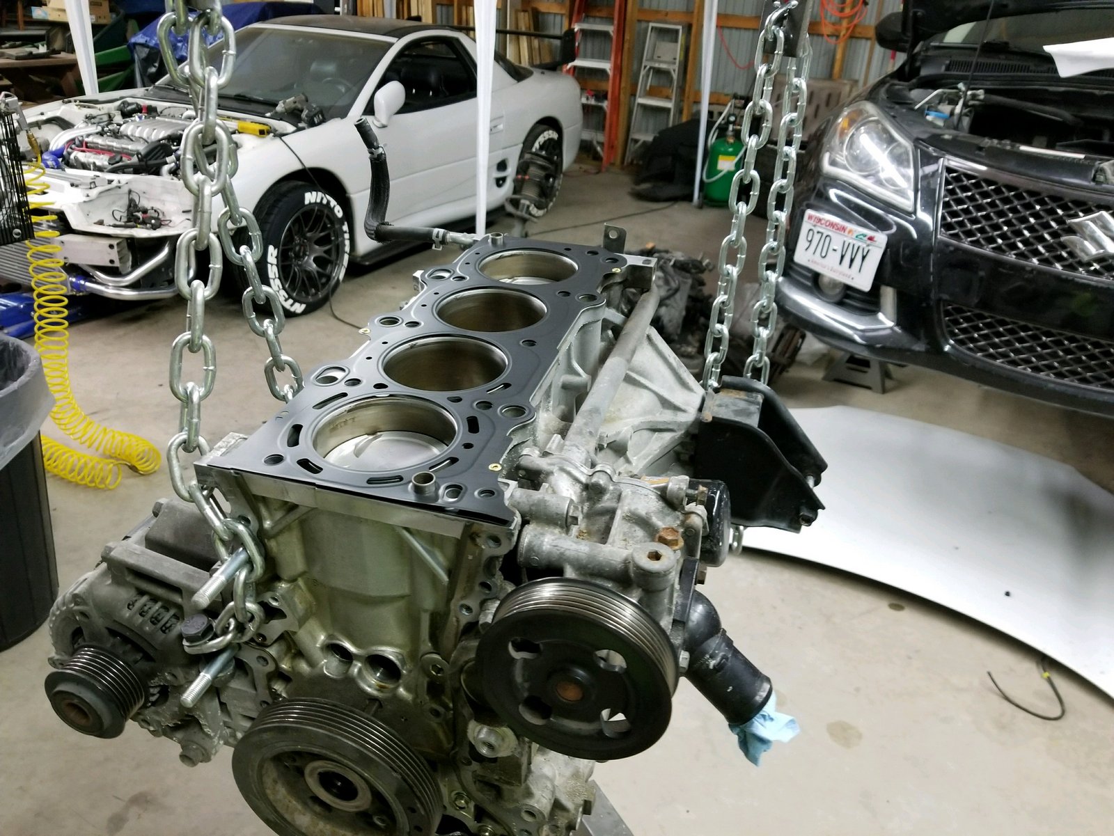

The two dowel pins are reinstalled and the new head gasket is placed. There is a right and wrong way to put on the head gasket. It needs to go on as shown in this photo or the photo in the service manual.

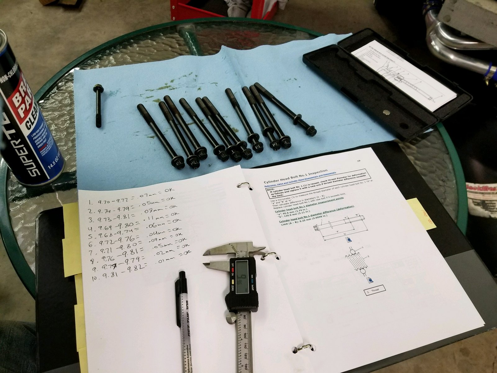

I could not find replacement head bolts so I checked for deformation per the service manual. All checked out OK and I reinstalled them. The torque spec on in the service manual calls for degrees of rotation so I had to buy an angle torque wheel to finish torquing the bolts. I think it was 15lb lb ft -> 29.5 lb ft -> 60 degrees -> 80 degrees.

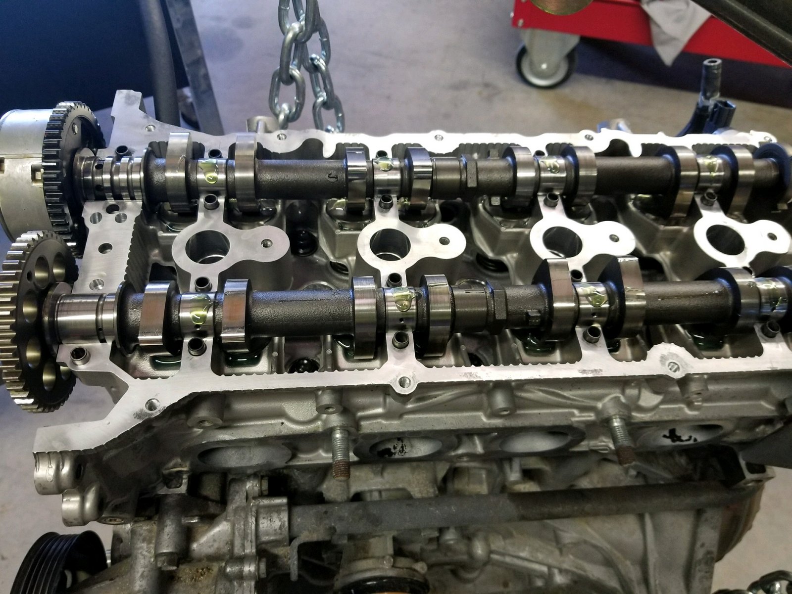

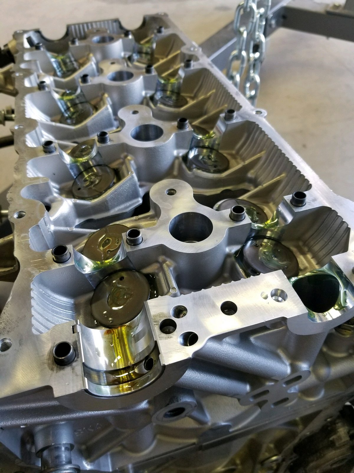

Apply lubrication to all the rotating parts that come into contact with each other. I had some assembly lube left over from a turbo rebuild so I am using it but I have also just used new, clean engine oil as well. Apply it to all the cam journals, the bearing, the outside and inside of the tappets, and onto the cam surface before the cam caps get put in place. Don't apply oil or lube to the bottom side of the cam bearing. That should be installed free of any oil on the bottom. Also lubricate the cam cap bolt threads with oil before torquing them, just like you did with the head bolts.

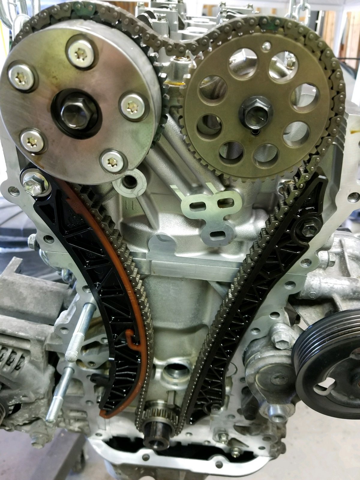

There are blue links in the timing chain that line up with the timing marks on the cam sprockets and the crank sprocket. I installed the chain, then the black chain slide, then the chain guide with the orange piece. The slack in the chain between the gears is taken up after the tensioner is installed. I had to manually turn the sprocket a little to take up the slack too.

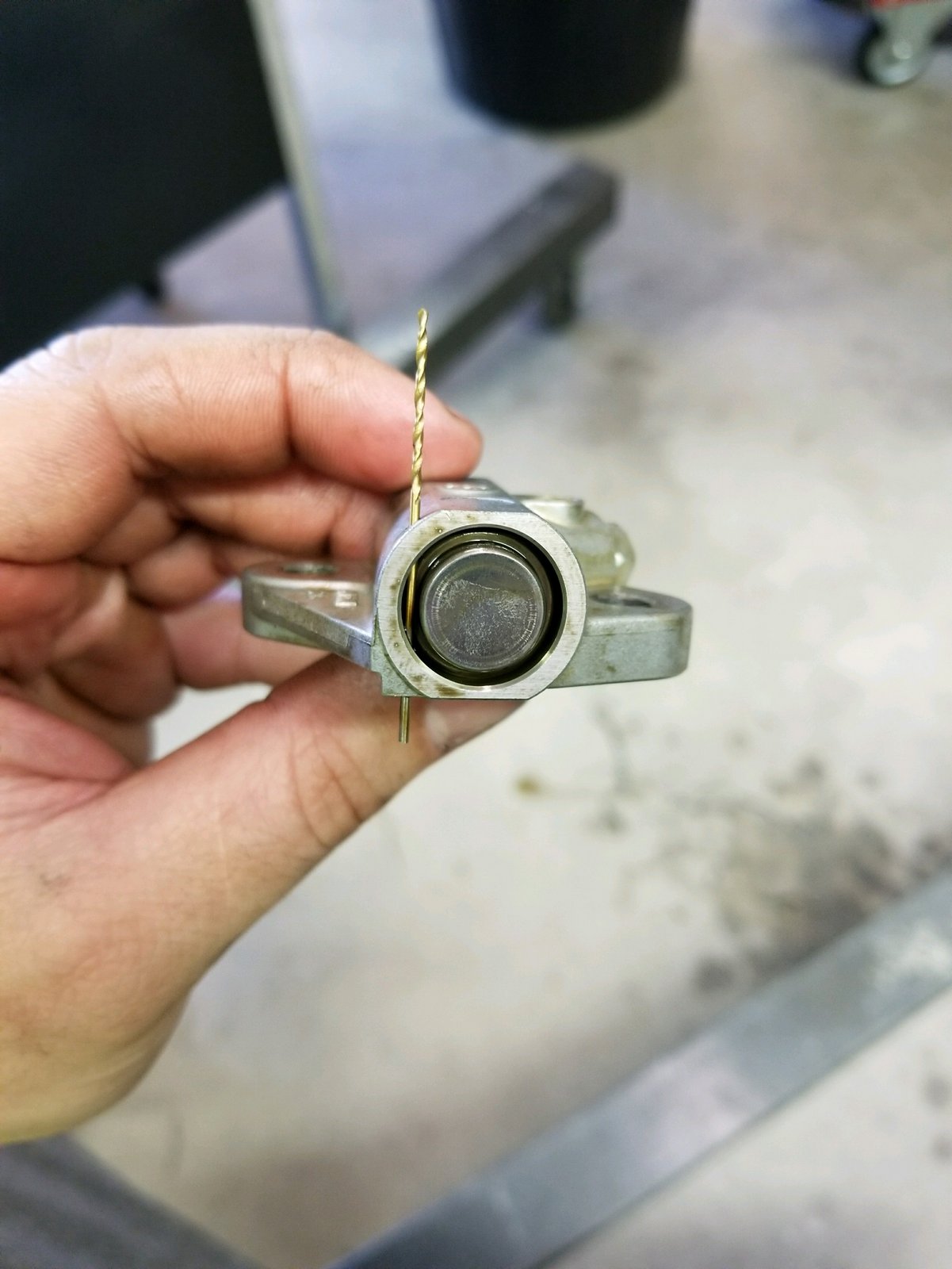

Rotate the tensioner piston clockwise and push in at the same time to retract the piston into the bore so that a drill bit can be inserted to retain the piston until it is installed.
Here is the tensioner installed. The pin/bit can be removed when the chain is properly aligned, the guides are installed, and all the bolts are torqued.

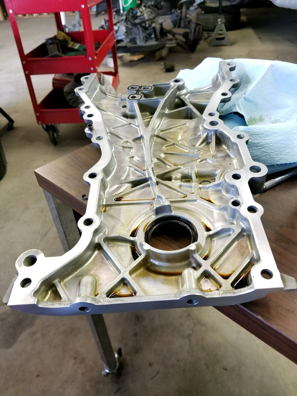

This is the timing cover cleaned up and ready to have sealant applied. I applied it to the left and right edges and around the bolt hole to the right of the rubber gasket near the top of the photo, per the service manual. I also applied it to the bottom where it mates to the oil pan as well. The sealant needs to go to the inside of all the bolt holes, not closer to the outside of the cover. I used the "right stuff" just like any black RTV sealant.

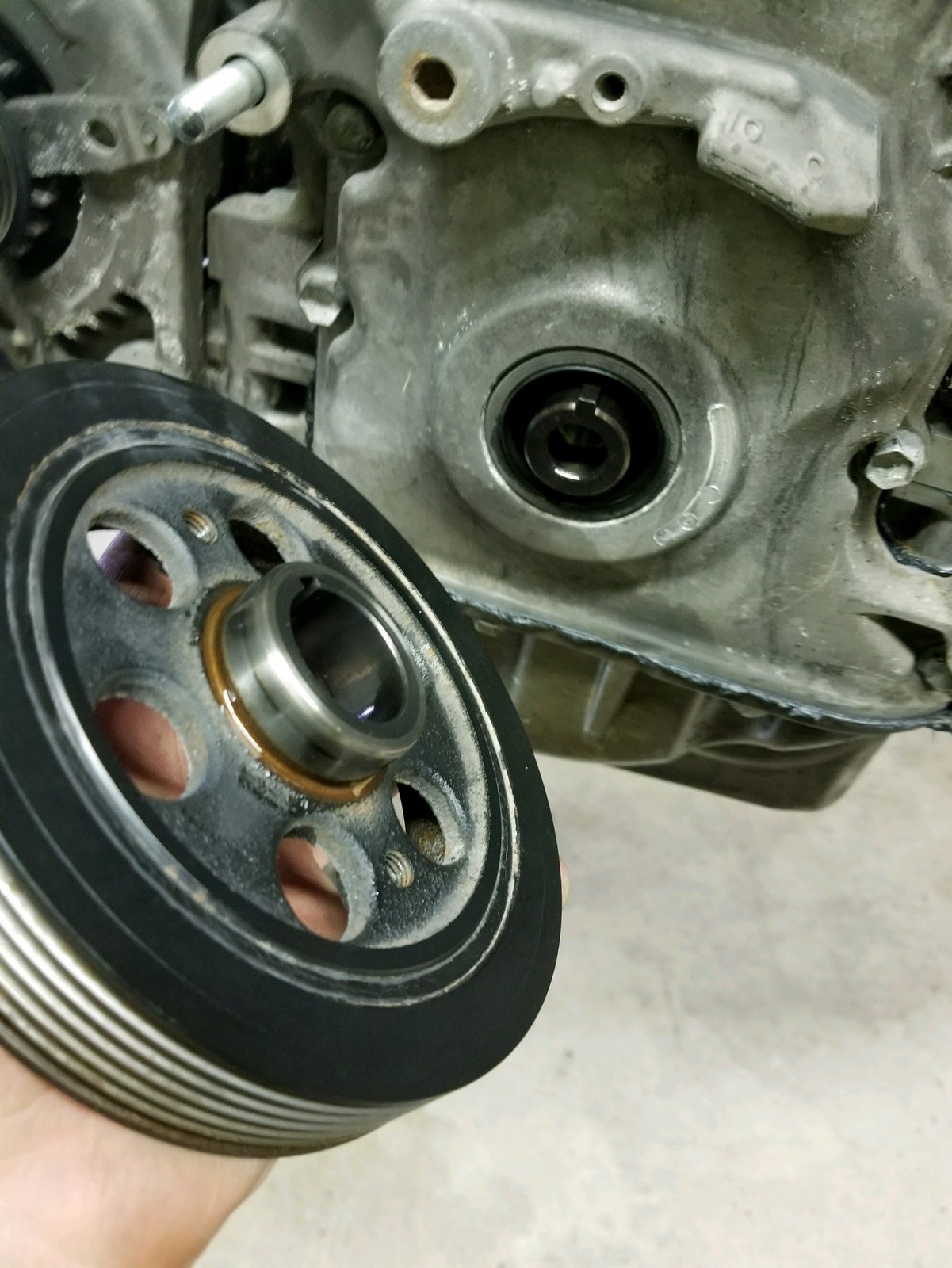

This just shows the crank pulley mates with the front main seal. So clean off this surface and apply oil before pushing it onto the shaft and into the seal.

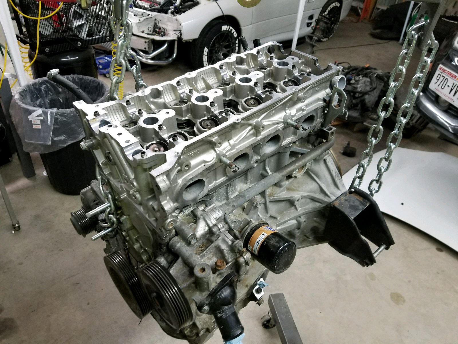

This is probably the last update I have with photos. The engine and transmission are back together in the cradle now and it's ready to go back into the car. I'll update you all when I get it buttoned up and have a few miles on it.
