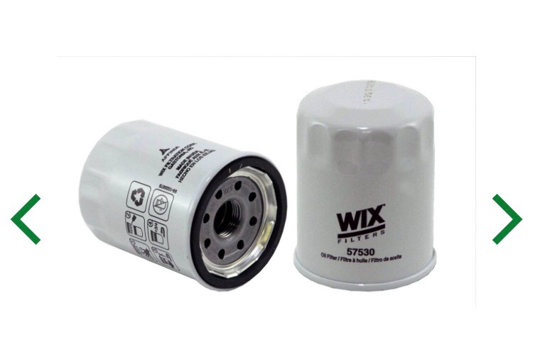

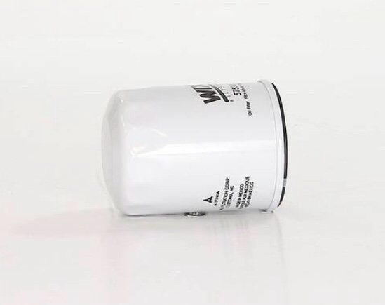

On Friday I put cardboard on the ground at work where there were some drips, to see if the mount was still leaking after I had tried to tighten the filter (some time before I left for work). After four hours (I work part-time), there was an oil dot 1.5 inches in diameter. I think I tried to tighten again and then went on my way. Put the cardboard down again at home (9pm-ish), and checked around noon, so a lot longer of a duration. Once again a small dot. I took the heat shield off this time and tightened the filter again (screws are 10mm like the underbody panel screws, if anyone didn’t know); it moved by like a few millimeters. Also took a pic to see if it was a double gasket situation. Apparently it’s not, so that’s a relief. I’m thinking that it could be the mount area wasn’t as clean as it needed to be, and/or I didn’t tighten as well as I needed to during the oil change. For a minute I was worried it was a double gasket situation because some angles of the pictures of the Wix filter don’t show the black gasket, making it look like it’s flush with the metal, rather than a layer on top of it.

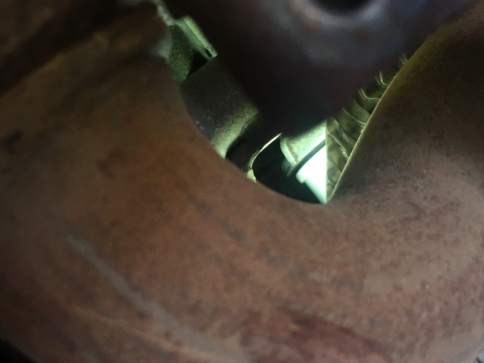

Side note, some of the stuff under the heat shield seemed a bit rusty? Such as the engine cylinder piping thing seen in my picture. Like even one of the screws was rusted and took some force to loosen. Is this normal? I’m in SoCal, not the rust belt, for what it’s worth.

As far as the rust--it is perfectly normal for the iron manifold to be rusted as well as the bolts. On my Altima that never left the SE us, when I replaced the header with a performance one, everything was rusted on it--and what was interesting is that after 24hrs the pb blaster that had dripped on it from when I applied it to the header bolts actually restored the surface back to metal. That pretty much sold me on how good pb blaster is. :mrgreen:
