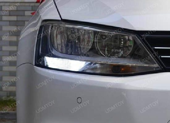

Regardless, I like what VW did for DRLs in the Mk VI Jetta. They basically gave it its own independent bulb and reflector in the headlight cluster. This way, you can do anything you want without compromising other functions. The picture below is one that converted the incandescent bulb to a LED.
