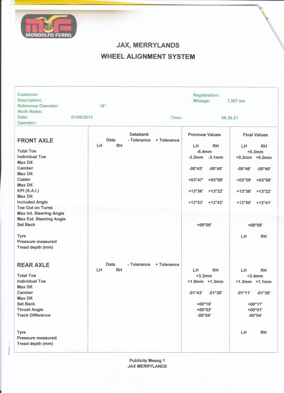

D3lusion
Posts: 50
Joined: Thu Jan 10, 2013 11:40 pm
Location: Sydney, Australia
Alright guys, please see below for the wheel alignment print out
Wheel alignment.jpg (153.17 KiB) Viewed 13800 times

I'm guessing you have got 18" wheels? A lot of those traits will become more obvious with larger diameter wheels and lower profile tyres.
Do you have the current alignment specs also- it would be worthwhile comparing them to what other people have their vehicles set to. There is also a post on here with a Suzuki USA TSB that gives updated alignment specs. I'll try and find it....
