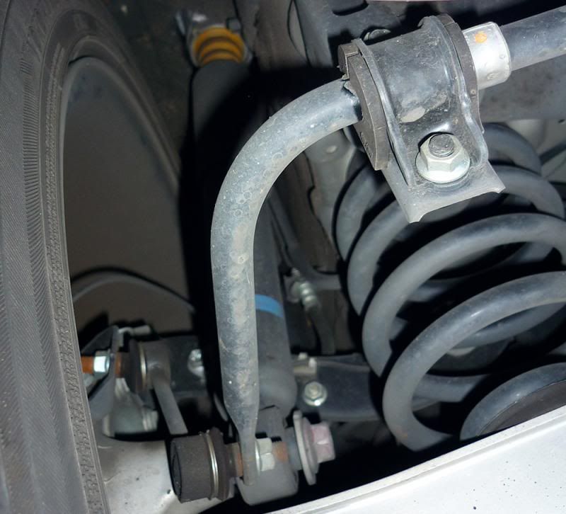

My Kizashi has had this squeak from the rear for a few months now.
Sounds like it's coming from the rear left (I've done some troubleshooting, like driving over a speed hump on one side only etc)
It seems to be getting worse in the past week.
I've taken 2 videos. See if anyone has similar issues, or know something.

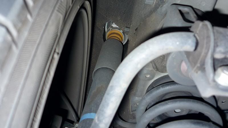

I've also taken a few photos under the car, but everything seems ok.
Any feedback/ideas, greatly appreciated.

Try lubricating the rear sway bar D bushes, they're often to blame for such noises (but usually with aftermarket polyurethane type bushes fitted.)
Silicone spray (or something similar) would do for a quick test.

I could see some lateral movement on the sway bar bushes, but others suggested it could be normal. I also see similar signs on the right, but without the squeak.
I'll try to get some lithium/synthetic grease and spray on a few areas.
