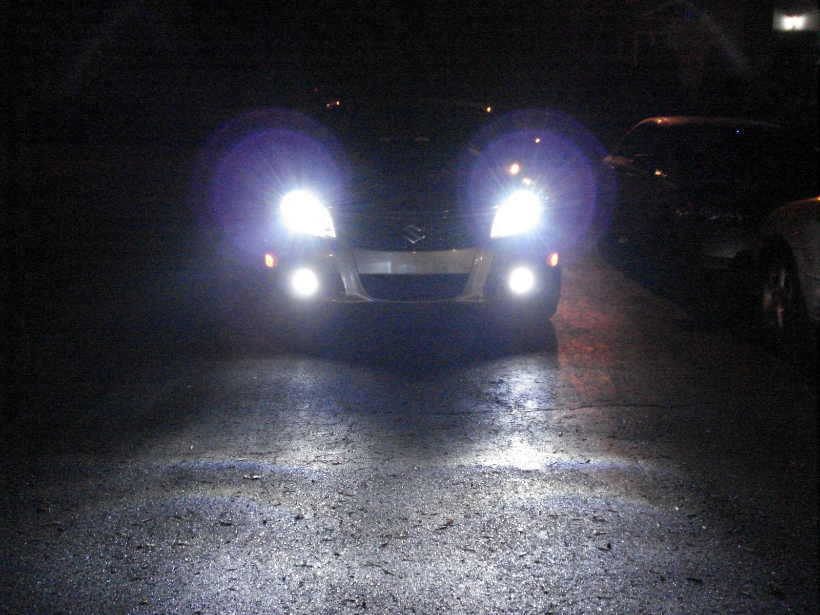

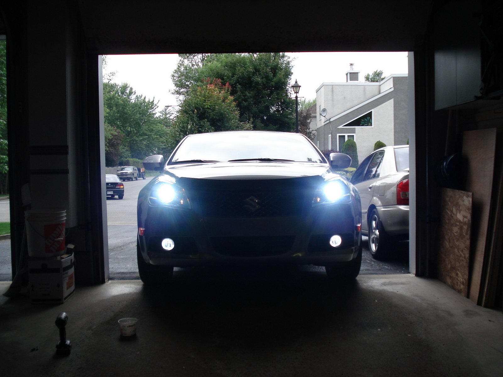

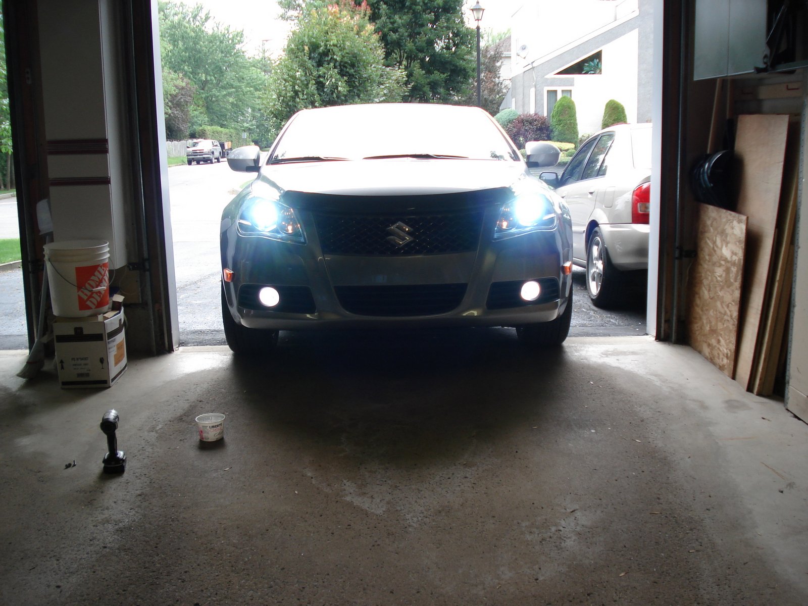

I'll have to get some more shots of the procedure, but here is the result.
I'll get a couple of nightime shots and post them too.2011 Kizashi SX - AWD

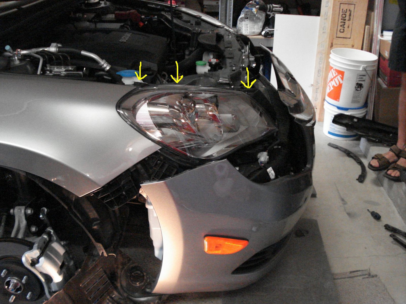

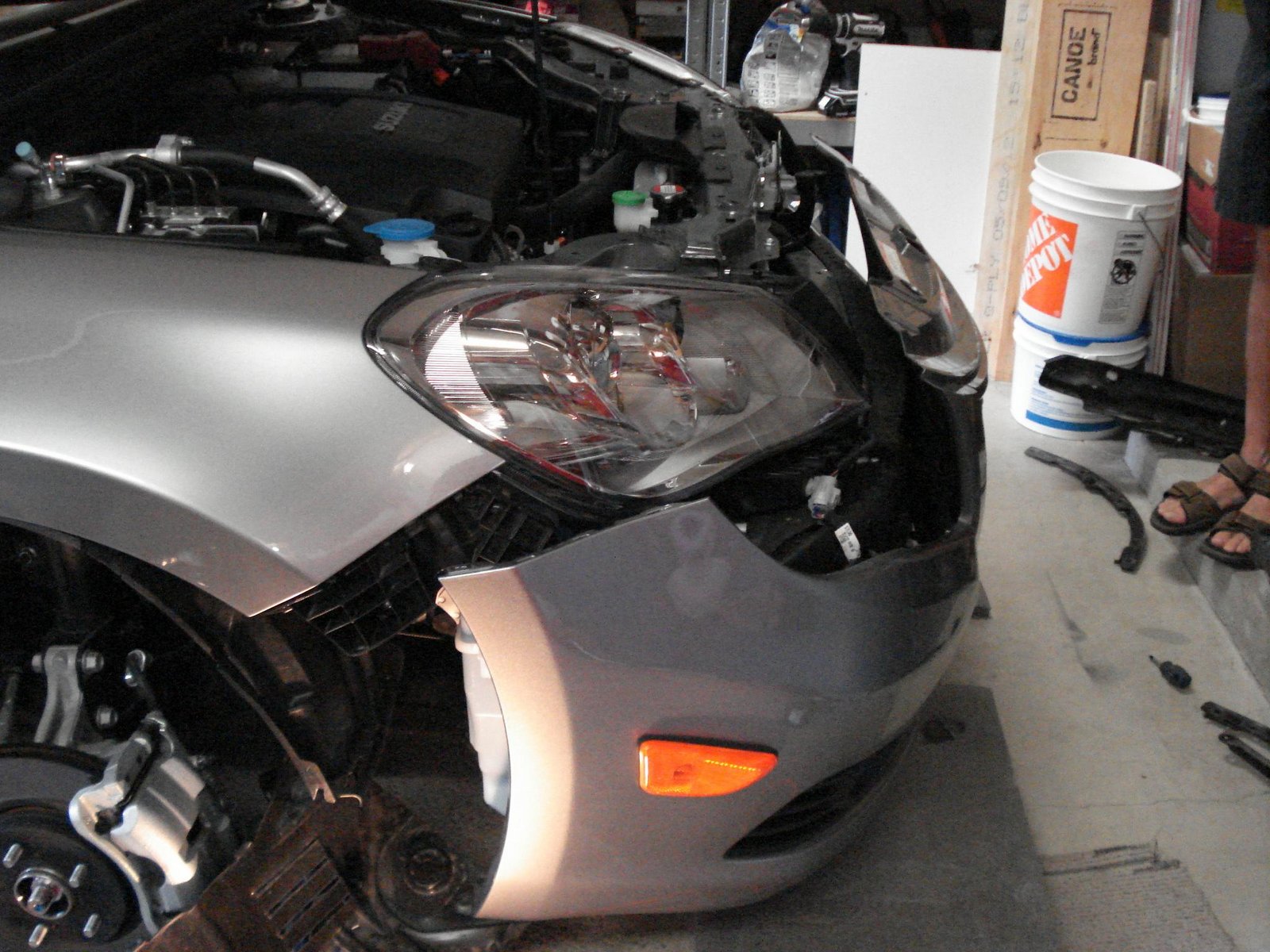

OK, here is the procedure as I documented it. I actually took many many more photos but then determined that some of the procedures weren't needed so I'll just post the relevant points. I missed a few pictures in some sections but I'll describe them as best I can.
Start with removing all the screws holding the bumper on underneatht the front of the car, including the small plactic wind deflectors (I didn't bother to take pictures there, it's pretty easy to figure out this part).

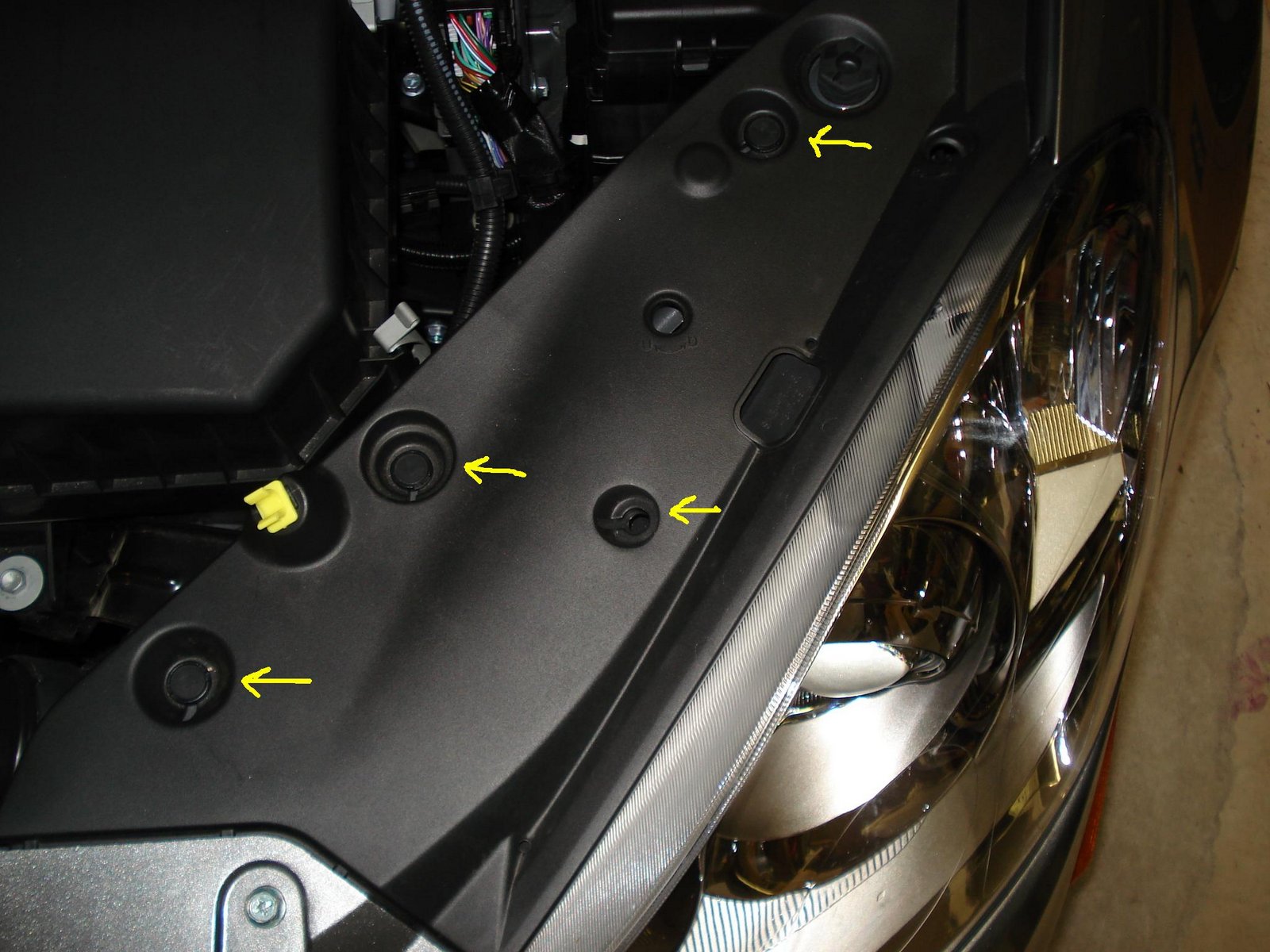

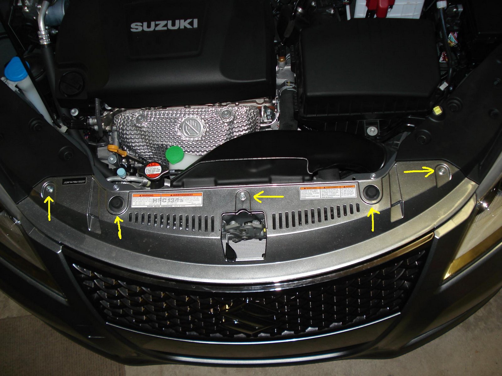

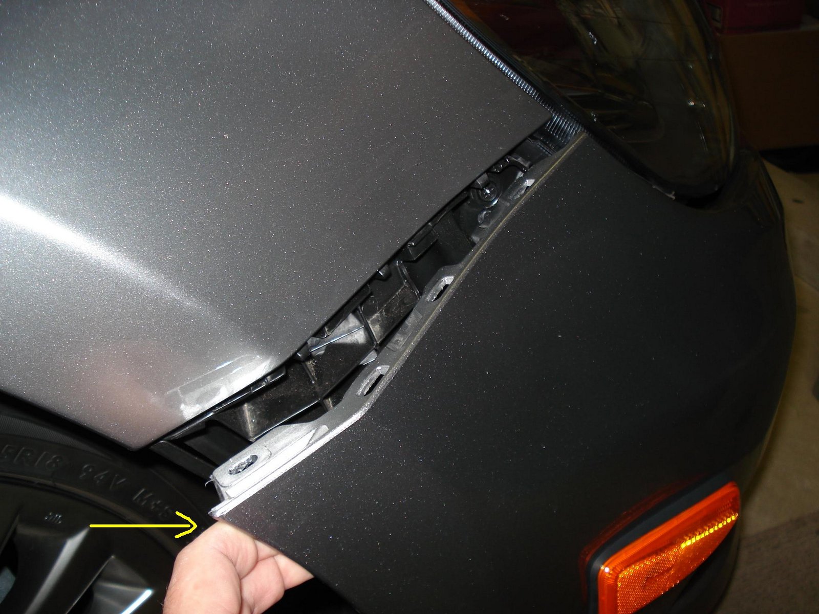

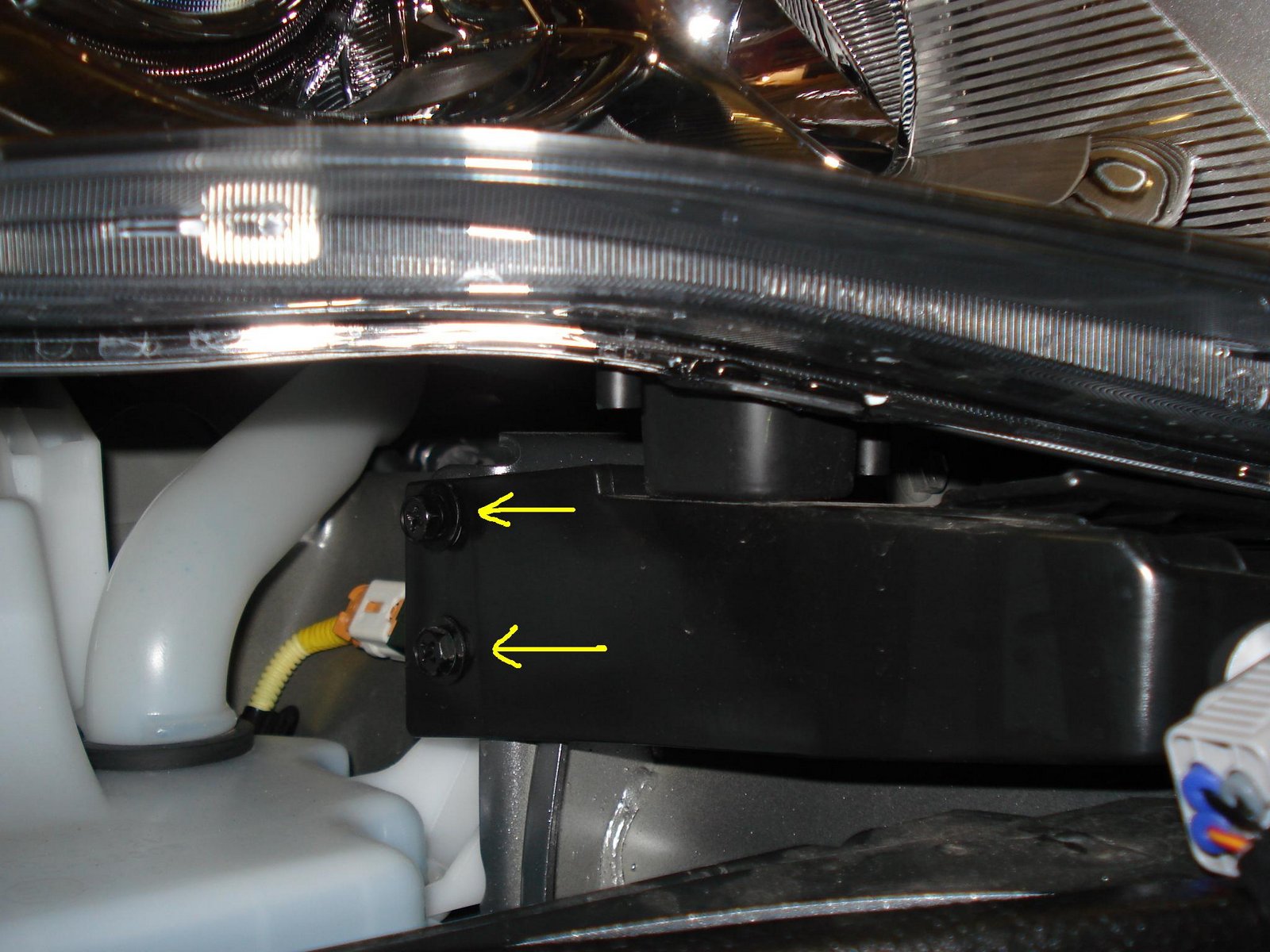

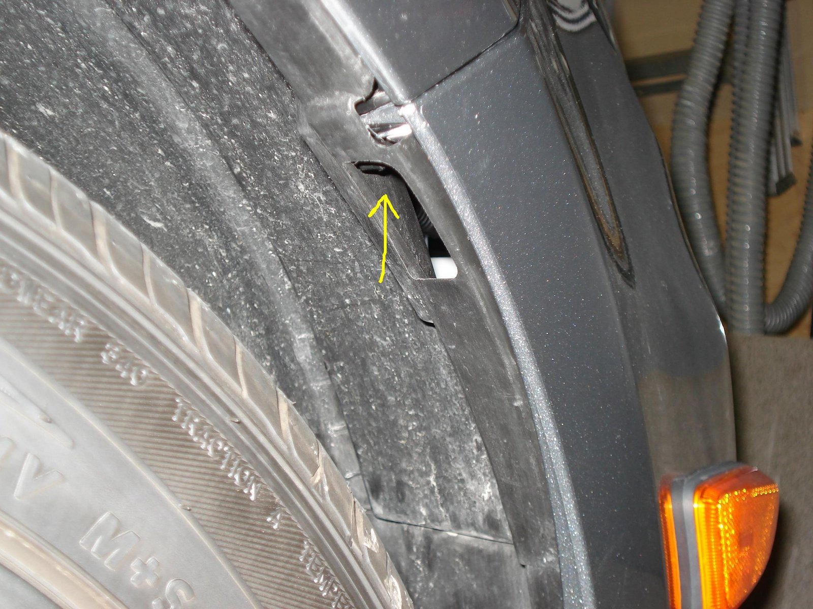

Now with the hood open, remove the plastic covers behind the headlight by popping the pushpins up and taking them out. Then just flex the cover a bit to remove it. This will give you access to the screws and pushpins that hold the headlight in at the top. (you'll remove them later) Now, find the slot in the front edge of the Liner of the wheelwell and remove the screw that goes up into the fender.

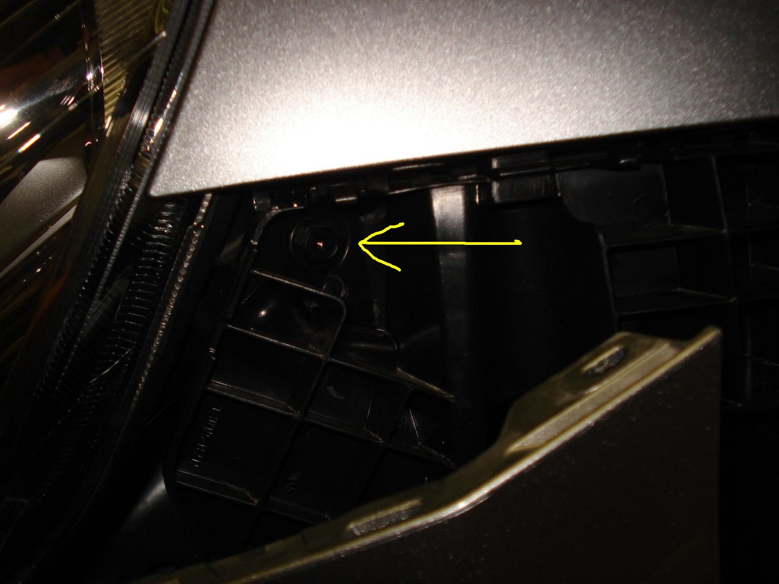

Just turn the wheels a bit to allow extra access room if needed. With this screw out you only need to add a good tug outwards to release that edge of the bumper. Next remove the 3 screws holding the front of the bumper on the top, and the rubber bumpers (these just pull off) Pull up on the top of the fender and slide it back, it should drop down enought to complete the rest of the job.

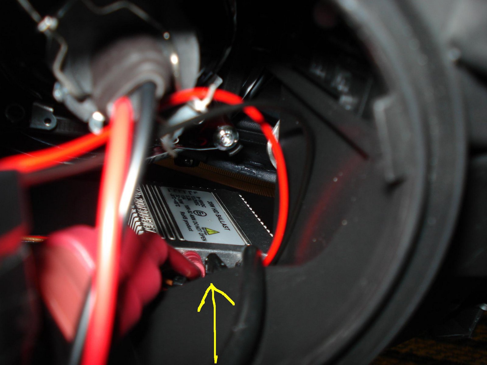

IMPORTANT, put something under the bumper to protect it. I released the wire harnesses for the Fogs, allowing the bumper the drop right to the ground where I had a couple of pads waiting. Now you should have access the all the screws holding the Headlight assy to the car (don't forget to unplug the headlight at the rear) This is where I missed a few good picture opps, but basically we flipped the headlight over an found a good, slightly recessed flat spot on the bottom, directly under the low beam. So we took a ballast and used it to mark the location for the screws (make sure the wires are towards the rear opening). We drilled the 3 holes, I think using a 1/8 drill bit (just slightly larger than the screws) We then placed the ballast inside the headlight assy and played around until it lined up to get a screw started from the outside. Finished putting in the screws, stuffed the rest of the wires inside after making the connection to the original plug (wrapped that well with black electrical tape), and that was it. We now had HID headlight assemblies that still looked completely stock.

No holes for wires needed. I stuffed the ballasts and all the wires right inside the headlight assy. Nothing outside at all. I drilled holes in the bottom of the headlight casing that matched the screw holes on the ballasts so I could secure the ballast from outside with screws to keep it from moving around in there, but I guess you could skip that if you are not comfortable with drilling holes in your headlights.will2k wrote:Did you drill a hole in the plastic headlight cover so the cables for the HID's fit through?
