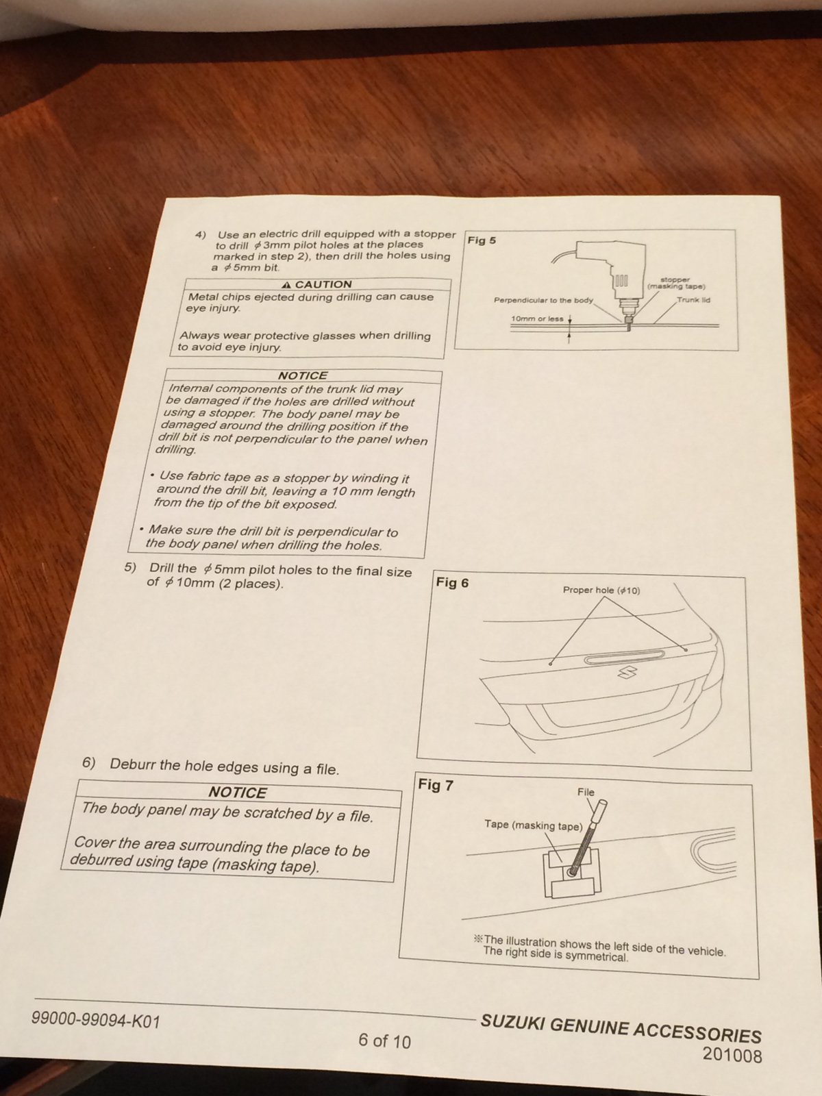

Kit from suzuki comes with template to drill 2x 10mm holes for nuts and bolts also in kit and double sided tape have concerns with water leak and rust u

I wouldn't be too concerned about drilling the holes if Suzuki has designed it that way. But that being said, they probably made it to be installed by a body shop, so they may expect some body working knowledge.

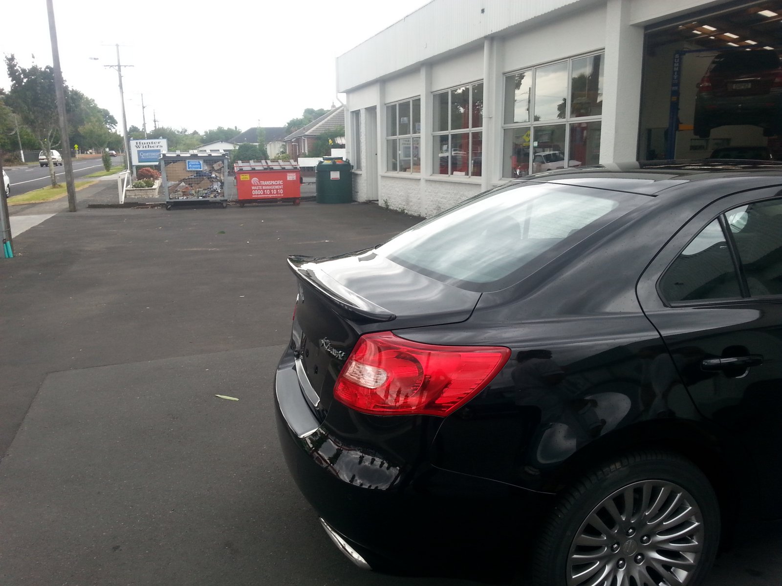

I have one mounted, and Holes were drilled. Apparently they can fall off with just the tape.

Nice spoiler , the oem one I have comes with a replacement rear light which attaches to the spoiler , then the spoiler attaches to the trunk , probably will have to drill holes , as it seems to support the light , lkit also comes with new trunk lifting rods, didn't think there was that much extra weight , will see first how trunk operates before changing those out
