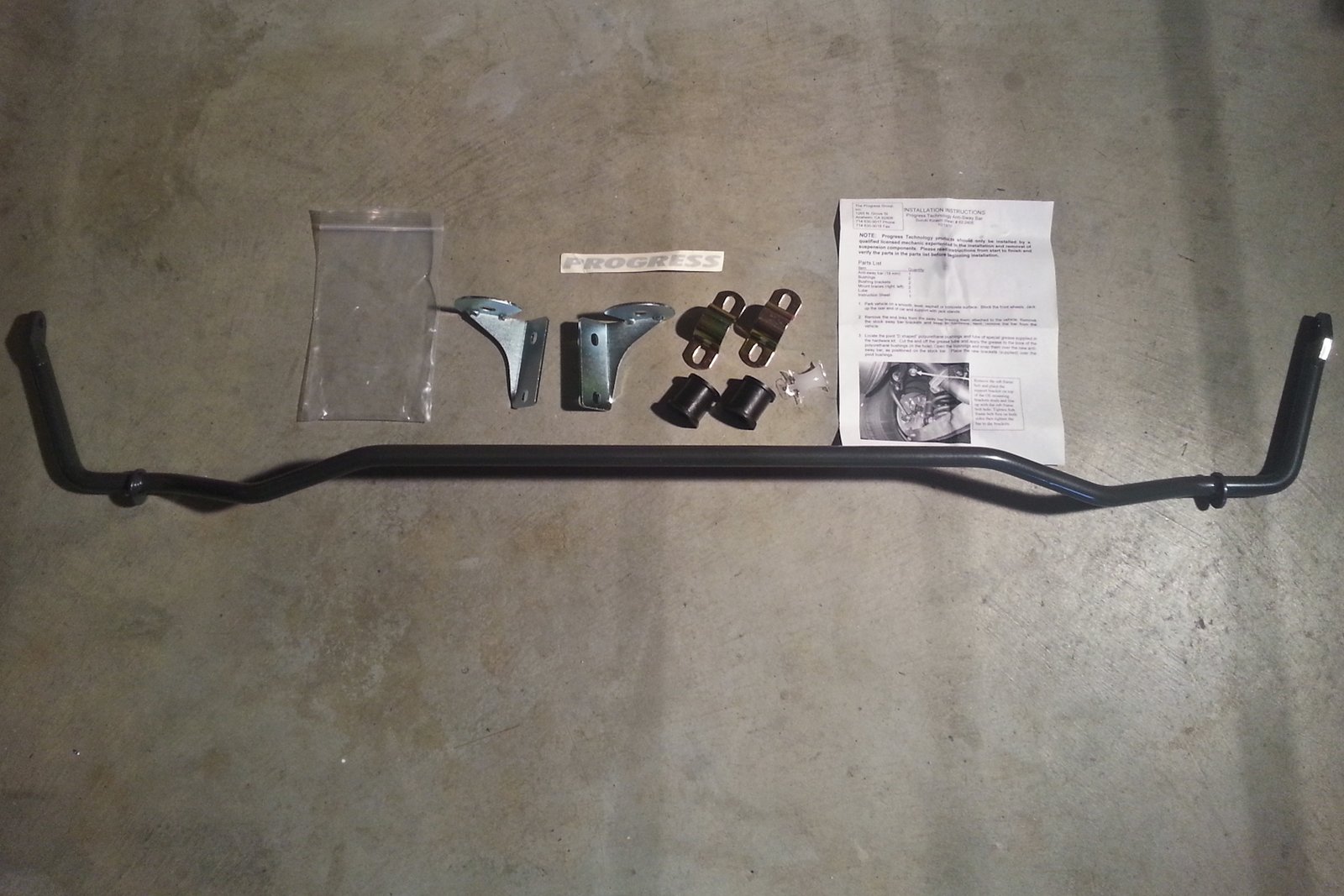

Package contents: Standard sway bar stuff. Note that the stock mounting hareware is reused. The little tube of grease was sufficient to lubricate both D bushings entirely.

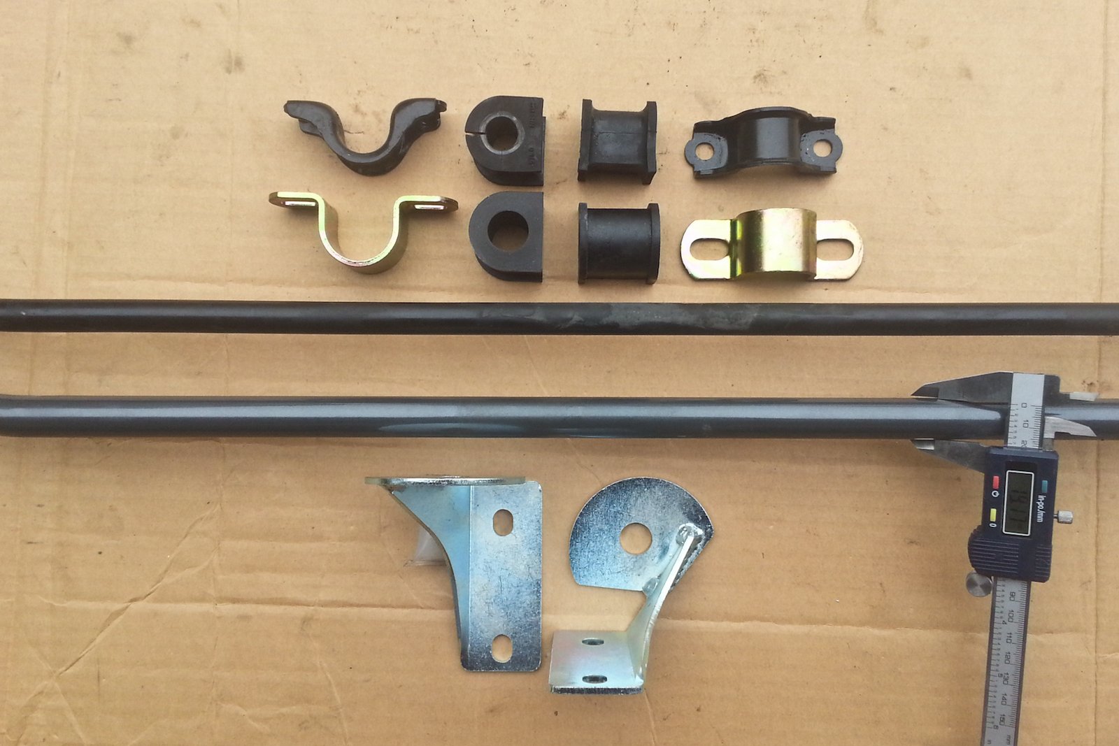

Stock versus RRM. RRM includes thick gauge braces to reinforce the factory sway bar bracket mounting points.

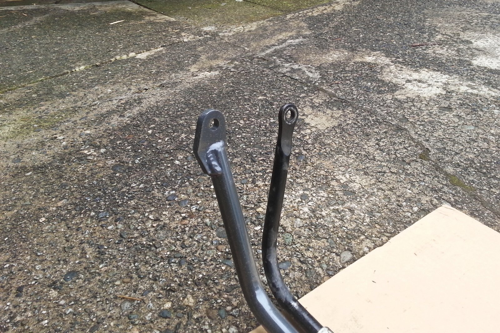

Also worth noting is that the RRM bar is non-adjustable.

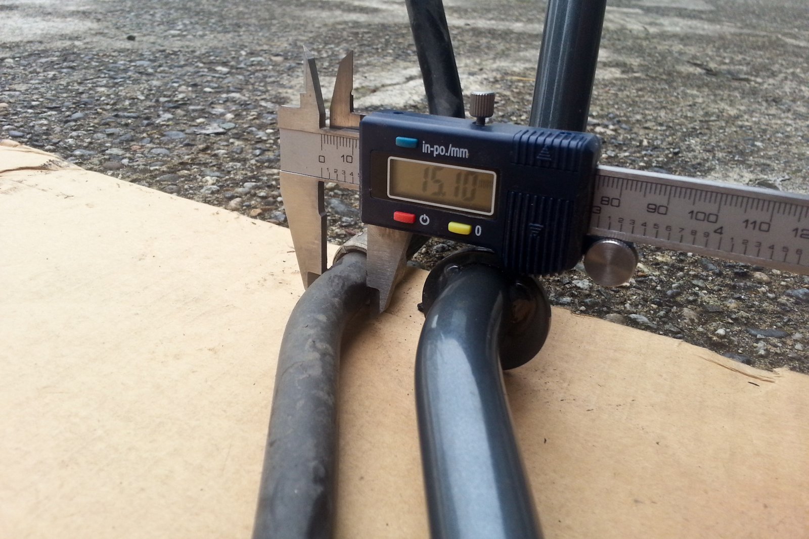

The stock rear sway bar on my S iAWD model was 15mm compared to RRM's 19mm bar.

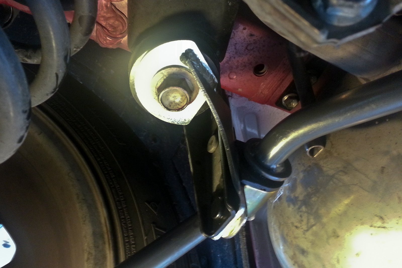

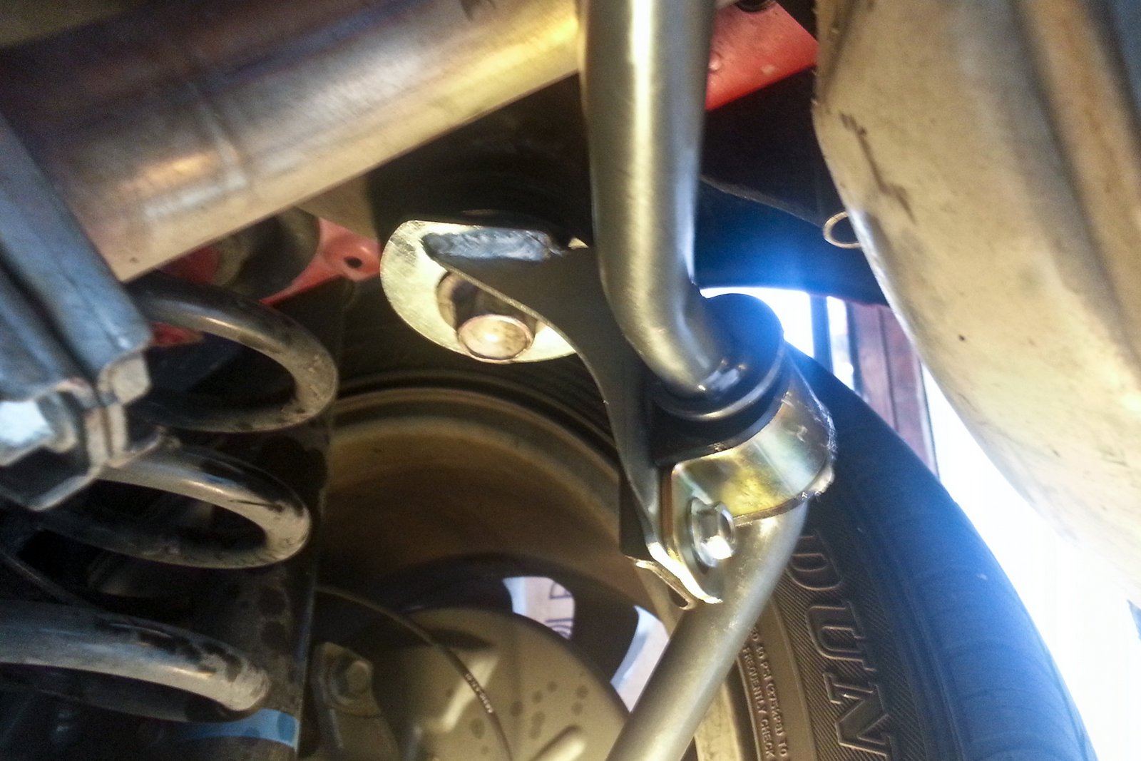

The braces reinforce the sway bar bracket mounts by connecting it to the rear subframe mounting point.
Another shot of the reinforcing brace.
I'm very happy with the RRM/Progress bar. It seems well designed and it installed without any problems. I also really like the idea of the reinforcing braces for the sway bar brackets.
