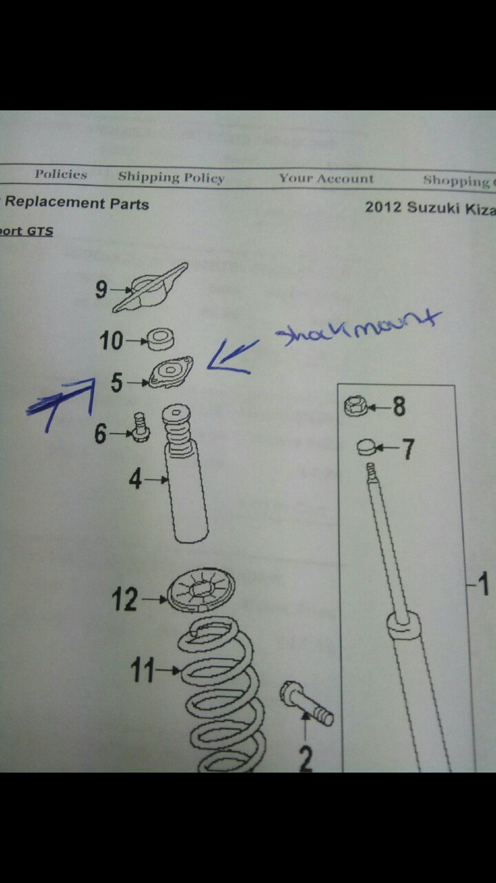

So after replacing my shocks and stop bumpers for the second time, I continued to have a rattling noise coming from rear drivers side. It turned out to that the top strut mount was not staying in place. Possibly damaged when shock went bad? I ended up ordering parts 5,9, and 10. Hopefully this will take care of the rattling issue until my shocks go bad again...
