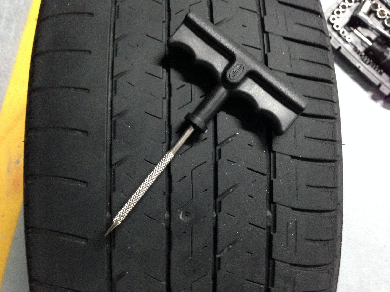

- A puncture repair kit. The kit contains tire plugs and the tools needed to install them.
- A knife or razor blade.

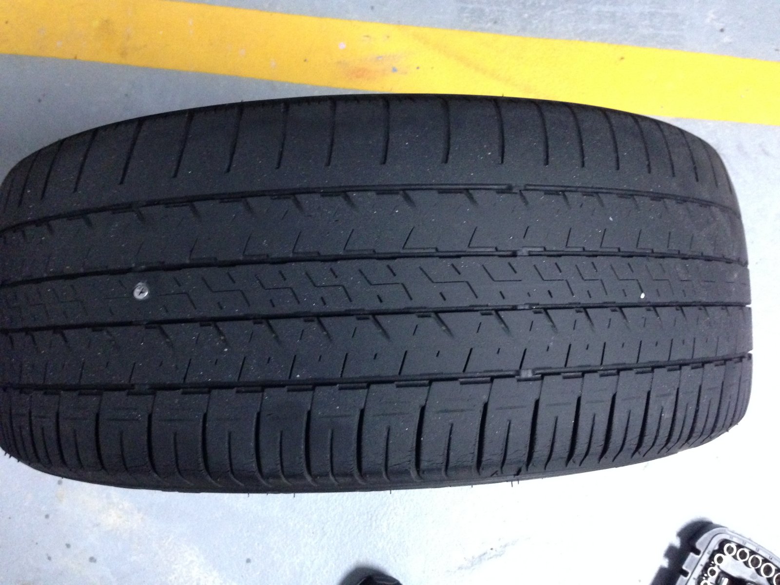

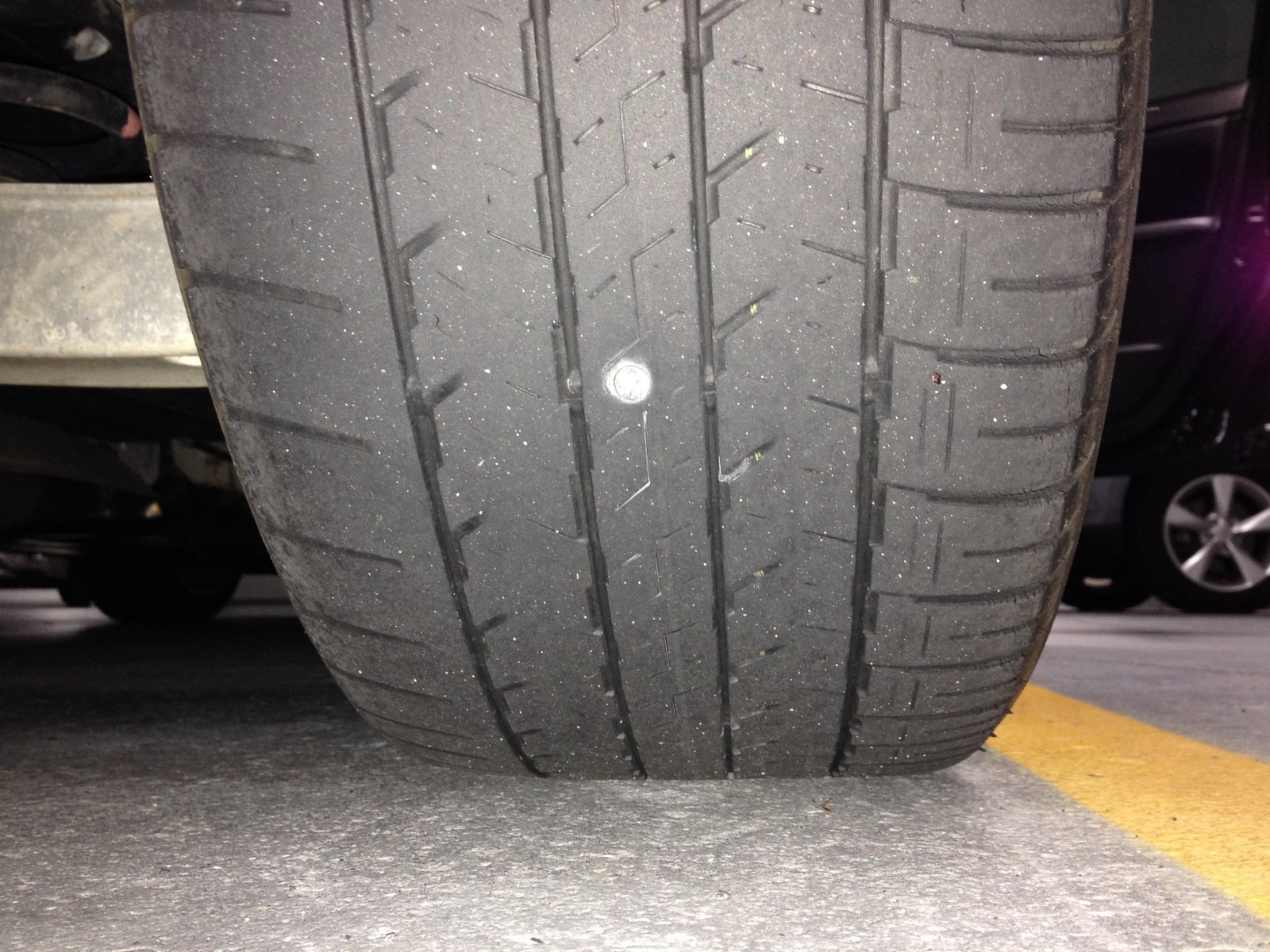

Step 2: Locate the nail or screw in the tire that is causing the flat tire.

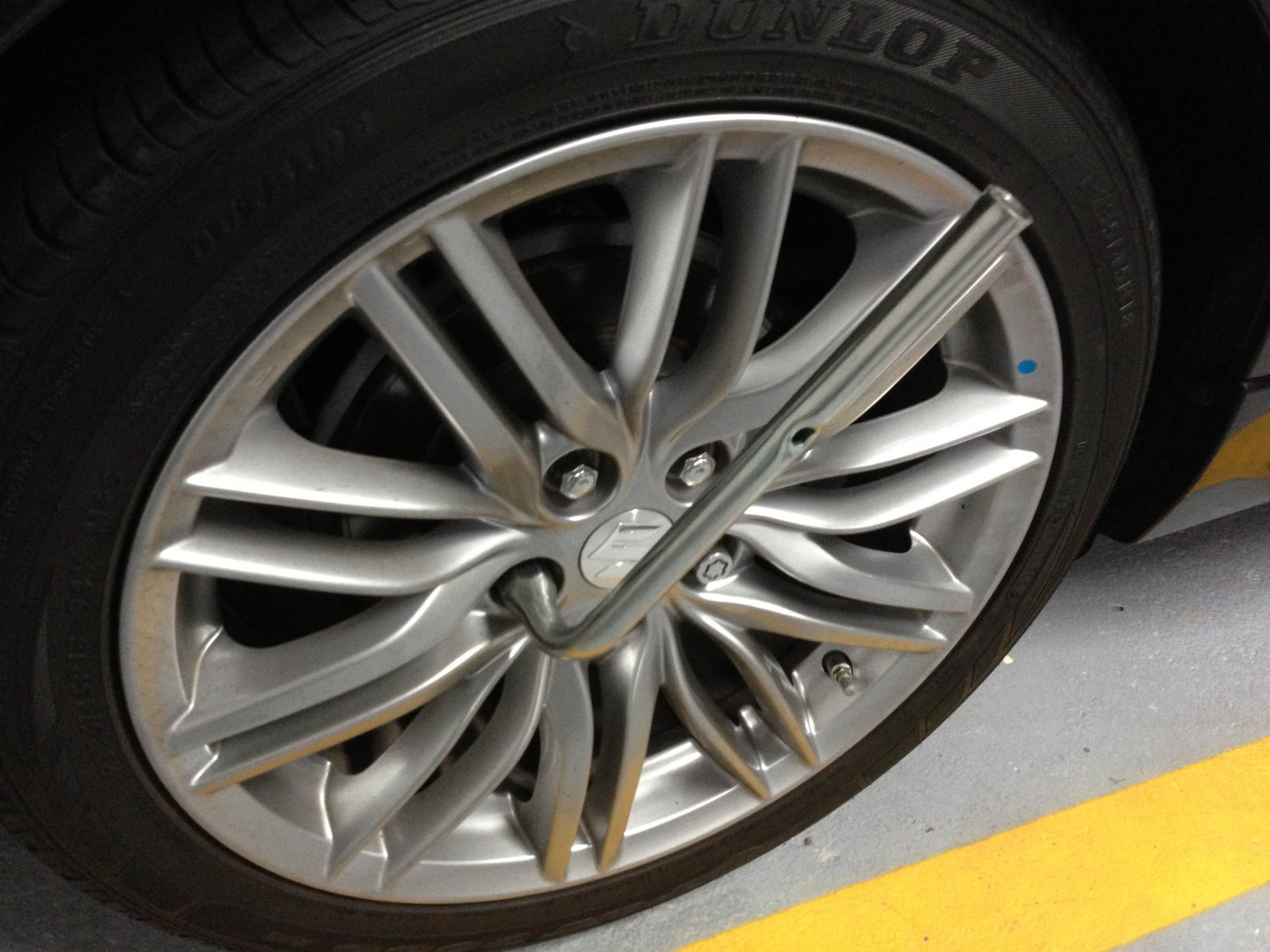

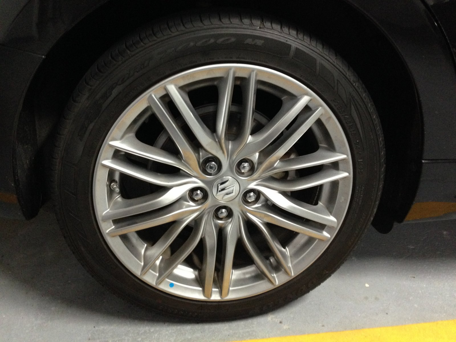

Step 4: Using the emergency lug nut wrench, loosen the lug nuts, but do not remove them. Do this to all lug nuts before jacking up the car. Use the key if you have wheel locks.

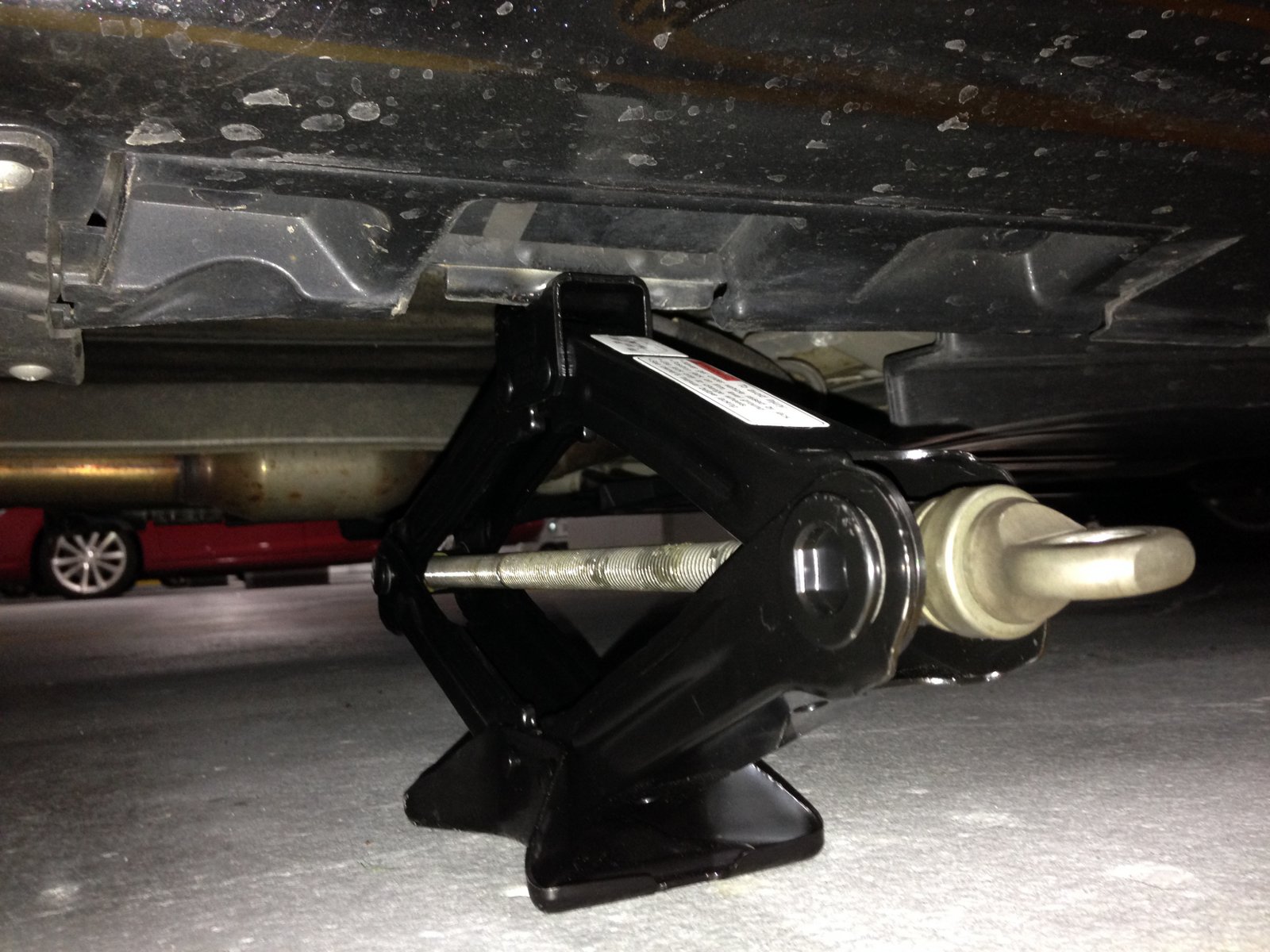

Step 5: Place the emergency scissor jack under the jacking boss location. Twist by hand until the jack meets the boss.

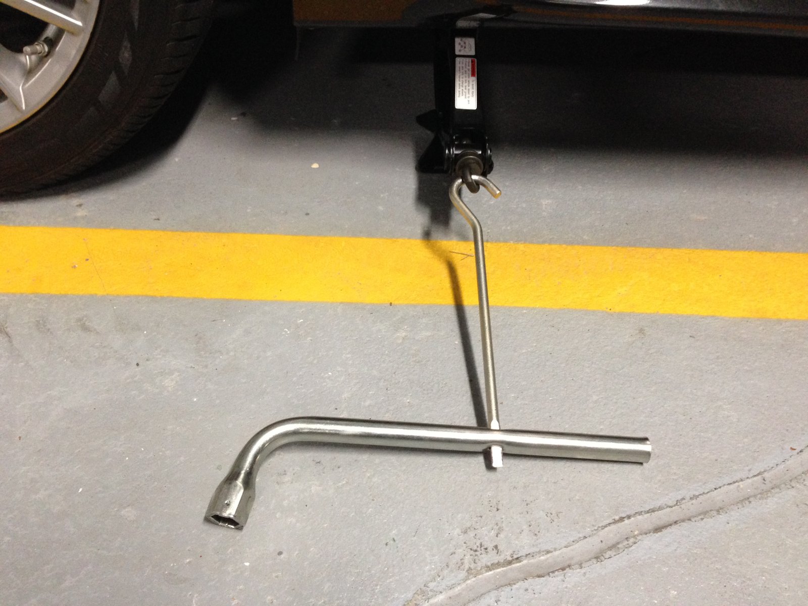

Step 6: Attach the jack crank tools to the jack. The Kizashi's kit uses the hub cap pry tool and the lug nut wrench joined together as the jack's crank.

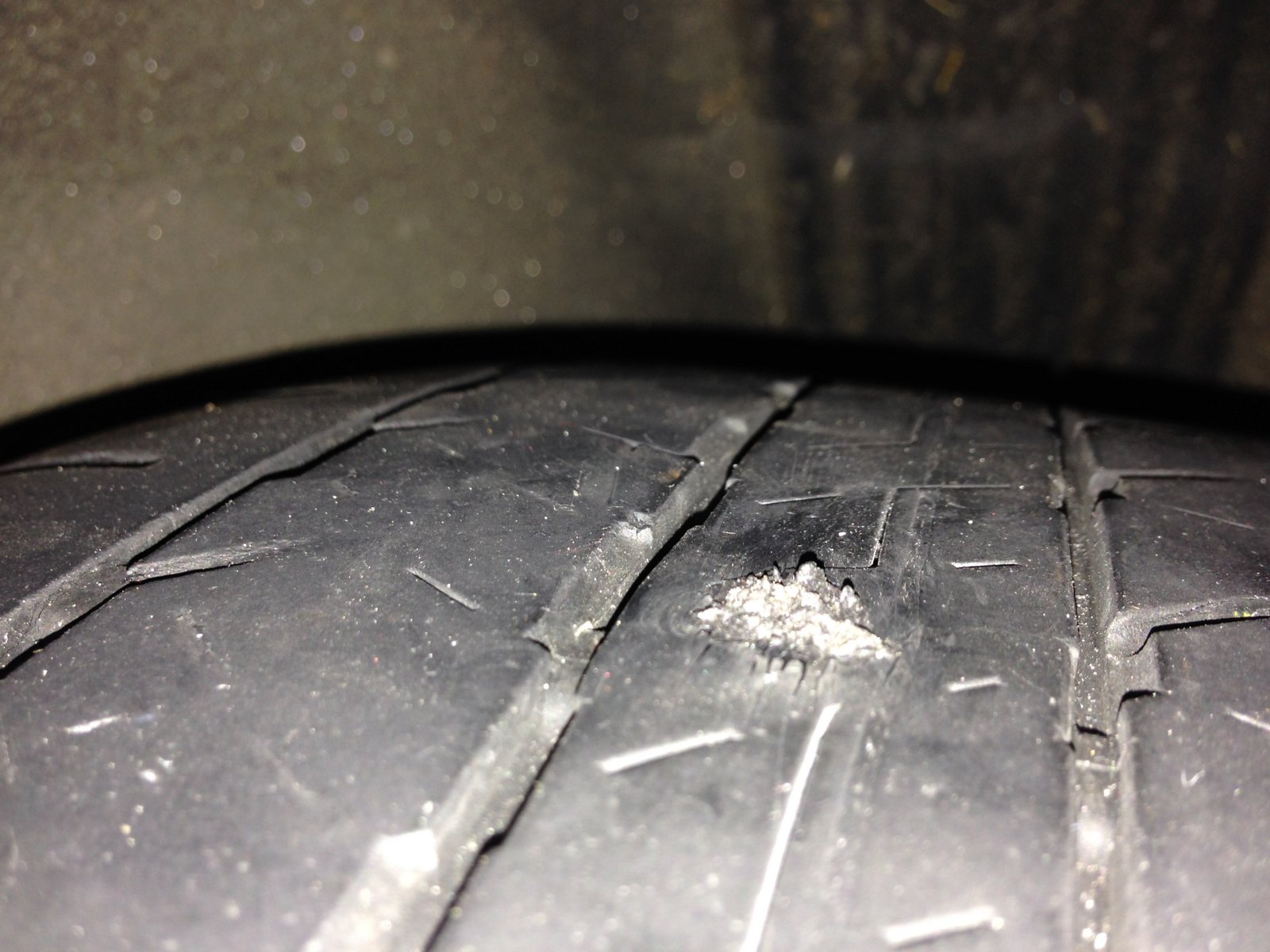

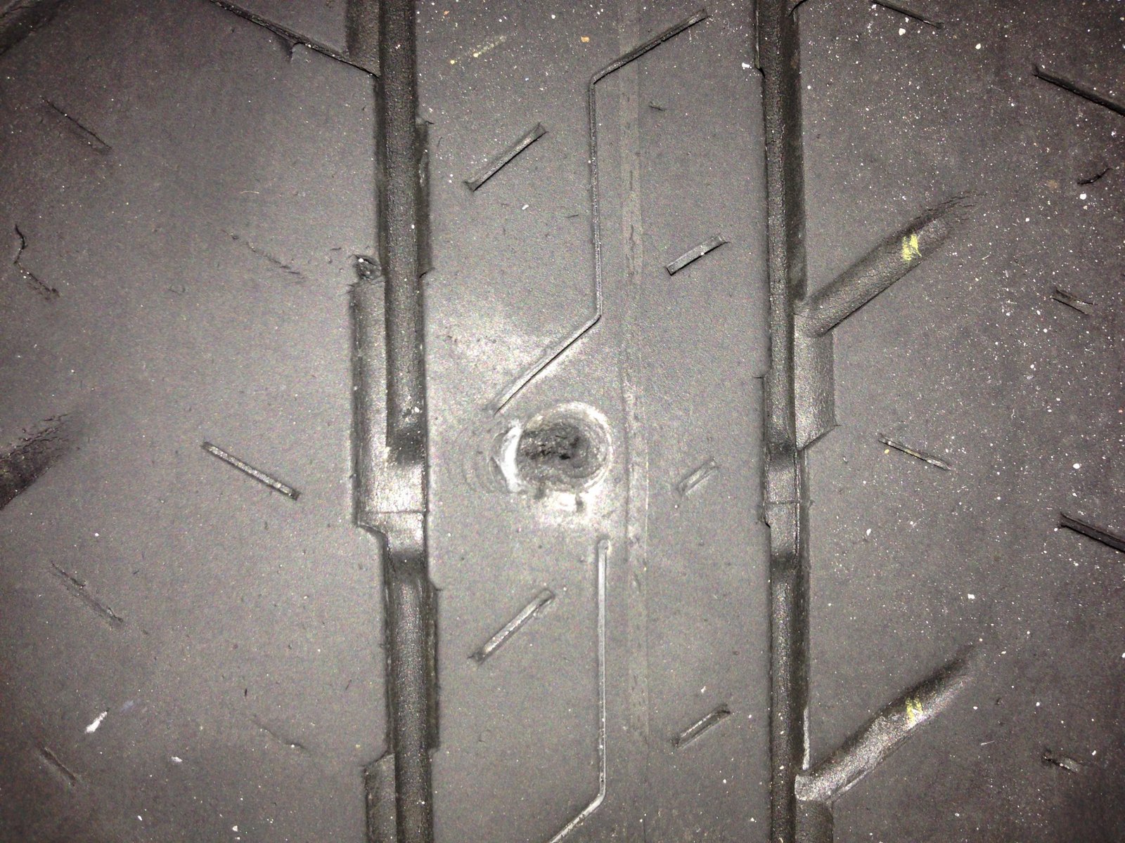

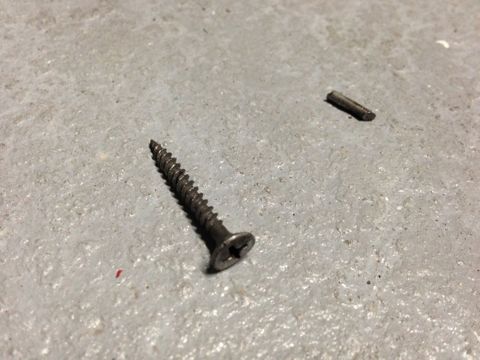

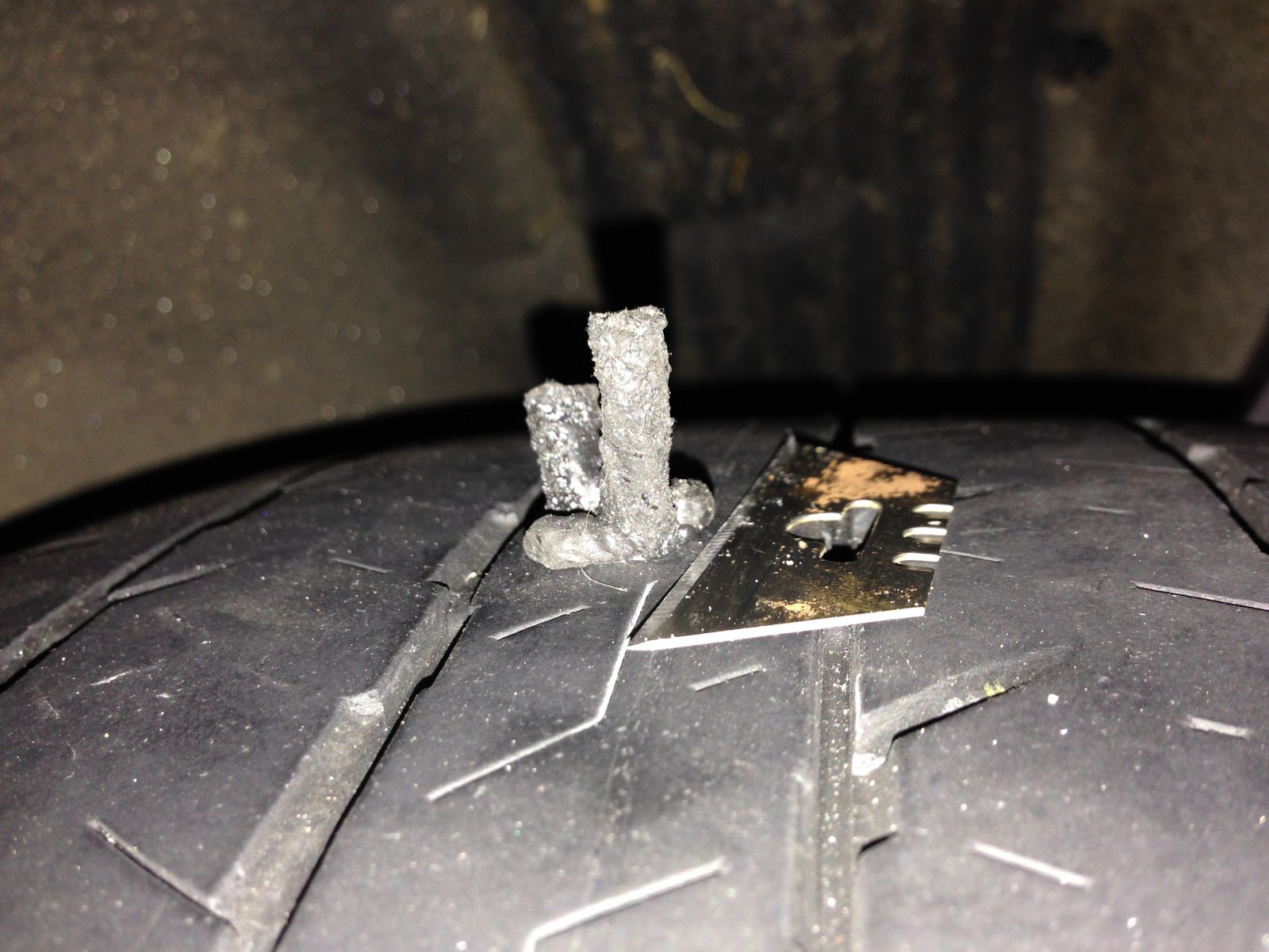

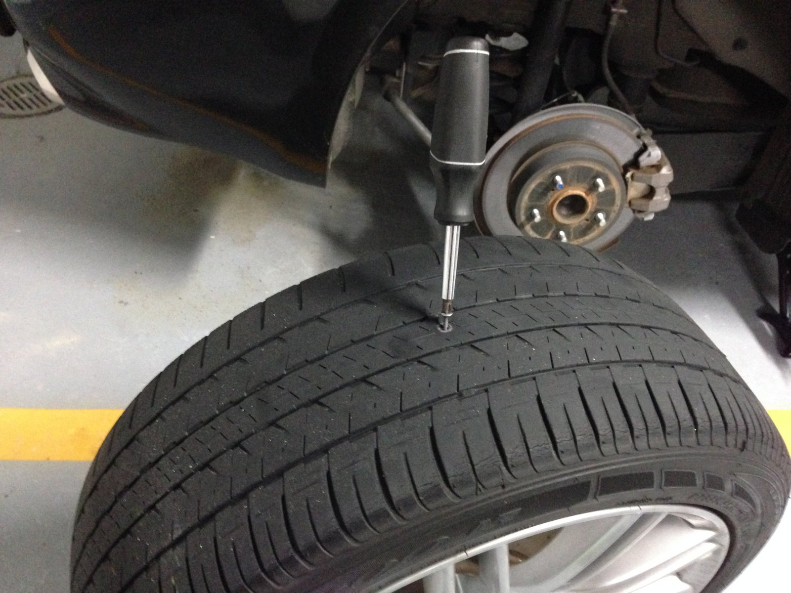

Step 9: Inspect the tire and locate the puncture object. In my case, I located 2 objects. One was a screw and the other was a fragment of a nail. The nail was too small to cause a leak, but the screw was in there in all its glory.
Step 10: Using the appropriate tool, remove the puncture object carefully. Screws like this one may come out easily by unscrewing them with a screwdriver. Nails can be pried out with a knife or flat blade screwdriver. If you have pliers, you can work the nail out easily.
Step 11: Check the puncture hole to make sure it's cleared and clean. Allow the tire to deflate if it's not already flat. Flat tires are more flexible and easier to repair.

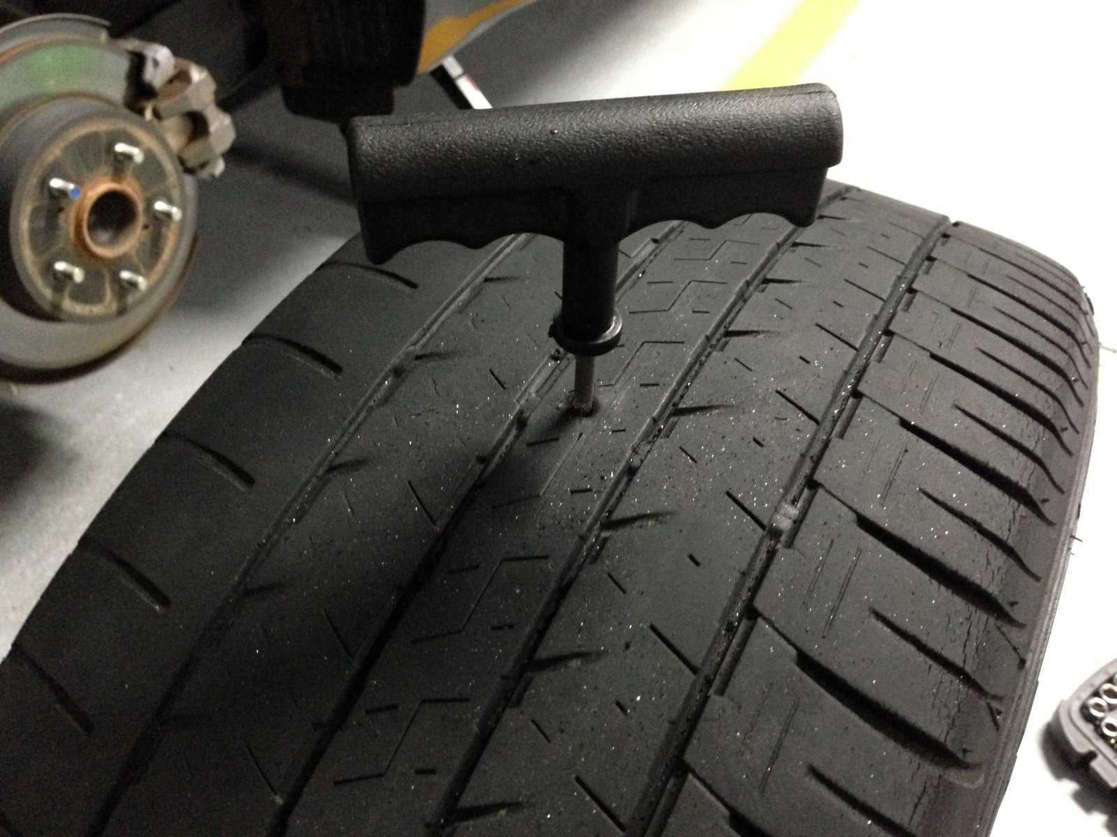

Step 12: Insert the rasp tool into the puncture hole and move it back and forth a number of times. Make sure you can push the tool through the tire. This process cleans the hole and makes the hole bigger. It may seem counter-intuitive but the point is to make the hole bigger for the sake of the plug.

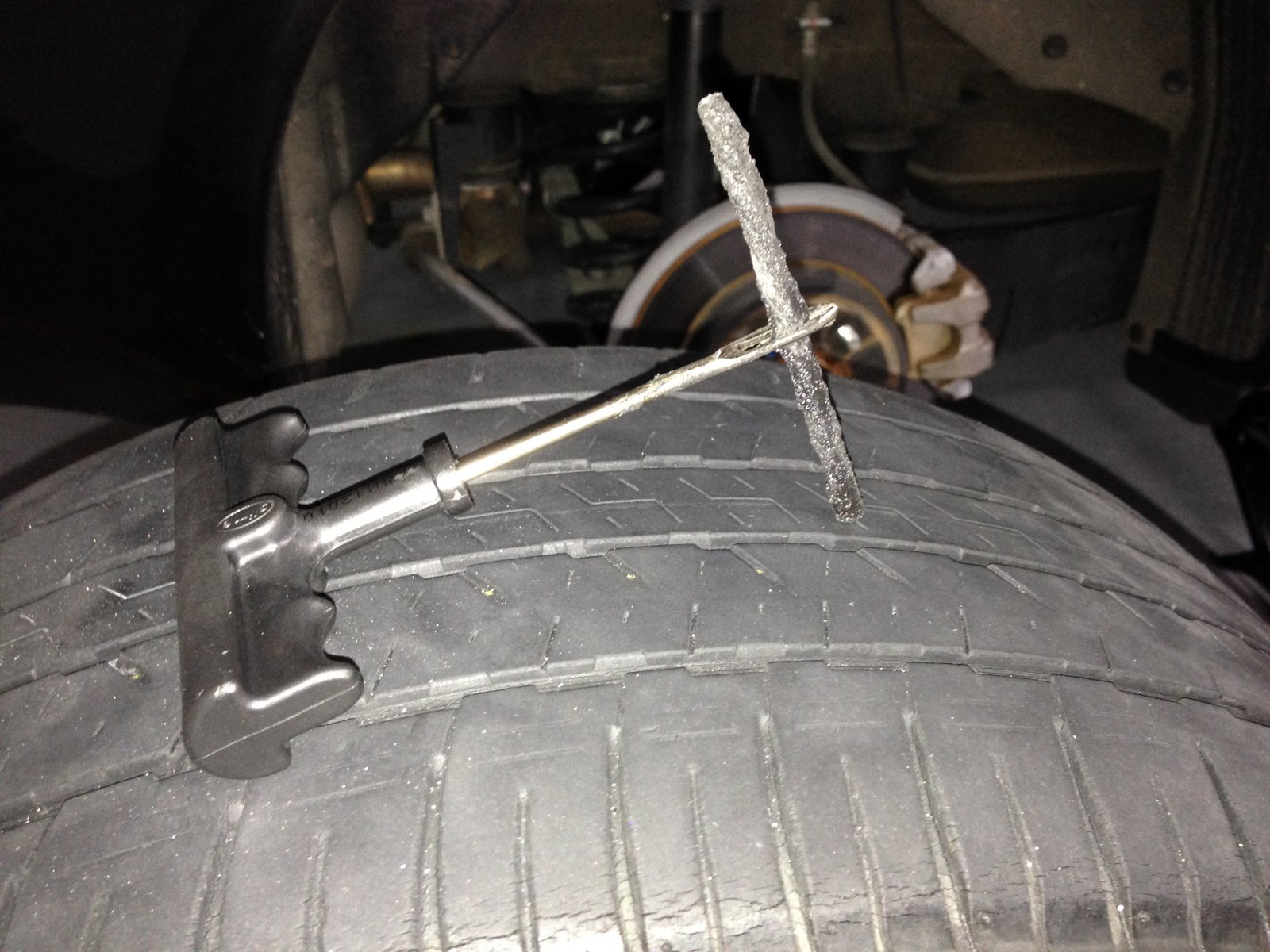

Step 13: Remove a string plug from its packaging and thread it through the eyelet of the needle tool. Have the plug centered on the tool.
Step 14: If you have cement in your kit, coat the plug with cement. My kit did not include cement so I did not do this step. My string plugs are super sticky with a tar-like coating so cement may not be necessary. I've used this kit numerous times before with no cement and it fixed the punctures fine every time.
Step 15: Push the needle tool straight into the hole. The plug should enter the hole. Do not twist the tool. Push until 2/3 of the string plug is inside the tire.
Step 16: Pull the needle tool straight out. Do not twist. The needle tool's eyelet features a slit for the plug to slip out of. The remaining 1/3 of the plug should stay outside the tire once the tool is removed.

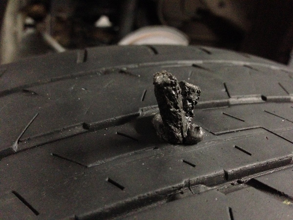

Step 17: Cut off the excess plug with a knife or razor. Don't worry about getting it perfect as the road will smooth it out.

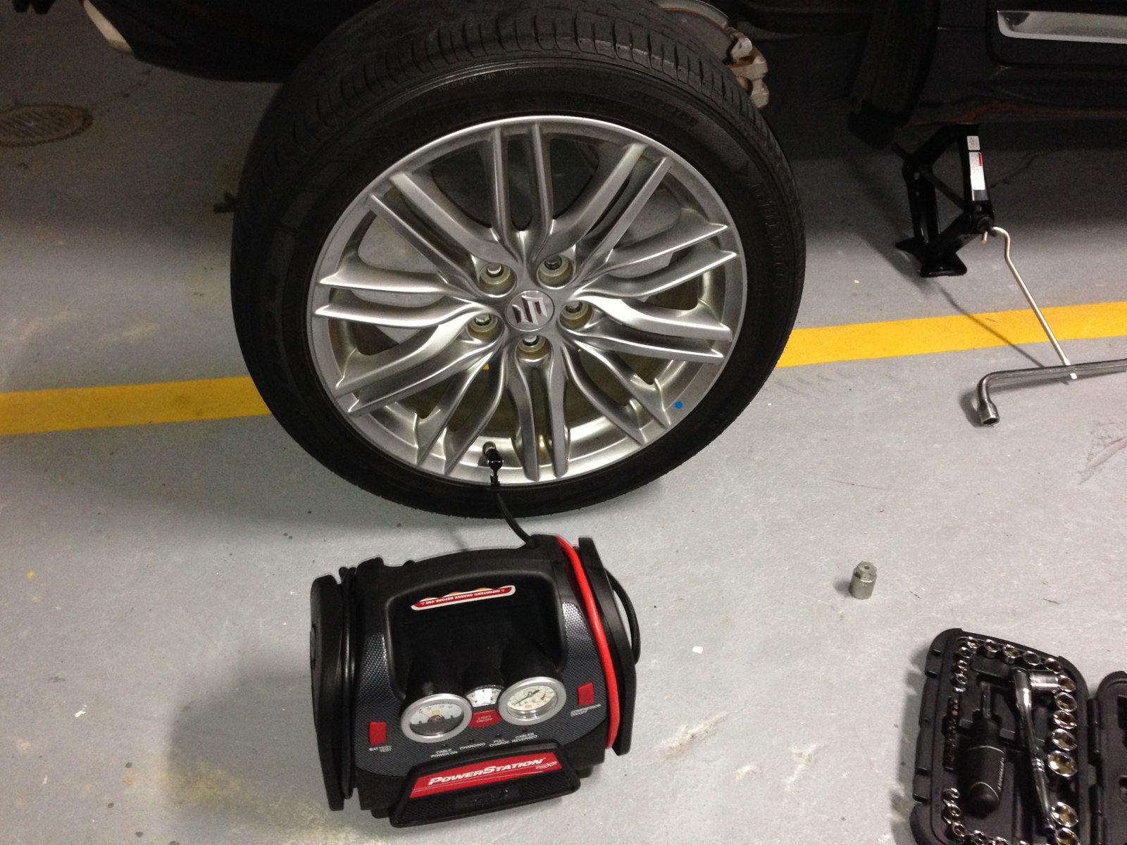

Step 18: Inflate your tire to the correct pressure. It's 38 PSI for my Kizashi. For emergency roadside repairs, having an inflator is key. I'm using my jumpstarter/inflator I got from Costco that I always have in my Kizashi.
