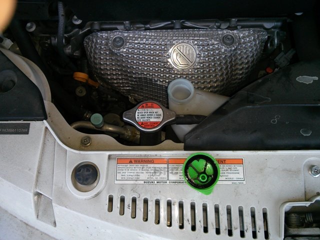

We made it all the way to our destination in one piece, and a couple of days after our arrival, I decide to check on the engine coolant. Apparently, I was in such a hurry to get on the road, I found the coolant reservoir cap in front of an intake like so:
Somehow, the cap made it the entire trip without falling out of the engine compartment, which was awesome I suppose. The reservoir was also about half full now, still well above the "Low" line. I put the cap back on figure it'll be alright until I get home.

Nothing to freak out about. I doubt any damage was done at all. However, you can't mix the 50/50 Zerex coolant with the "Super Long-life Blue" coolant used recently by Asian car makers. You need to only use this blue coolant with the existing coolant.
From the sound of things, it appears that the 50/50 Zerex coolant did not circulate the cooling system. When the engine is cold, open the actual radiator cap and see what the coolant looks like. It should be blue. If it looks mixed with the 50/50 Zerex coolant and the color now off from blue, then you should get the cooling system flushed at the dealership and replaced exclusively with the blue coolant.
If it's not mixed in the radiator, then you can either siphon out the reservoir or remove the reservoir and pour the mixed coolant out of it. A siphon would be the easier method and these are sold in auto parts and hardware stores.
