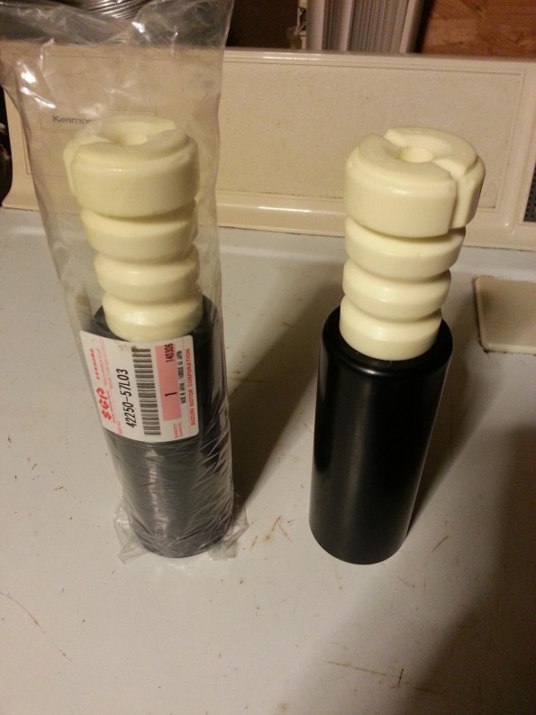

Images stolen from another thread on the subject for your convenience. The part number can be seen in the second.

I bought KYB brand replacement bump stop and the foam upper part looks exactly the same. The bottom is a bellow type that can compress and i think that is better than OEM.
Foam?
That off white upper bit is hard plastic.

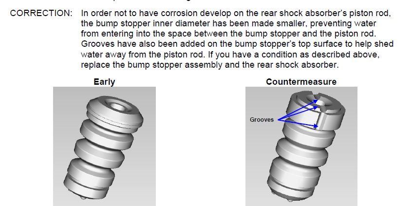

It same type of material like the original. It have to be able to compress to absorb the bump. Its pretty common material for bump stop.
I just realise the KYB one does not have the slit on the side. The inner diameter is the main problem. The original are loose and allow dirt and moisture to collect and rust the shaft. This KYB one fits tight to the shaft.
I also have to scrape the inside of the upper mount for the new bump stop to be able to slide back in. There was soo much salt like build up inside the mount.
Kisazhi wrote:It same type of material like the original. It have to be able to compress to absorb the bump. Its pretty common material for bump stop.
Is this picture of the KYB bump stops (SB113) accurate?
You could always file/cut the slits into the side

Yes. That is the one.
