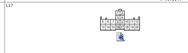

Actually bdleonard I wanted to ask you about your new power seat wiring. Suzuki must add those fuses and connectors for future upgrades I guess.
please correct me if I am wrong 'so in order to upgrade manual seat to power seat beside those maxi fuses in Relay Box No.2 you need additional connector under each seat (L17 Connector)'
New Bitmap Image.jpg (10.87 KiB) Viewed 9272 times
