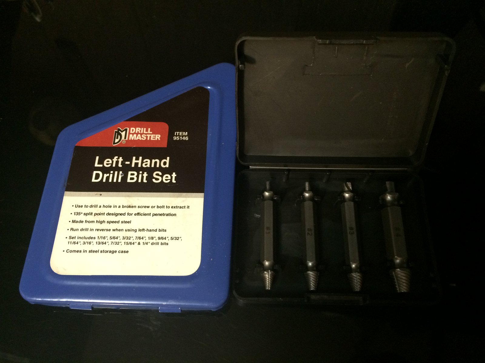

- Drill. Cordless is ideal.
- Left-Hand Drill Bit Set.
- Screw/Bolt Extractor set.

A few words on the special tools:
A Left-Hand Drill Bit Set is very useful in drilling out broken bolts. What makes them special is that they cut going the opposite direction from other bits; counterclockwise. This allows them to drill into something while actually rotating to make them come out. These are hard to find in my experience (Home Depot, Lowes, and most hardware stores don't have them readily available) but are found easily at Harbor Freight Tools. This is the very set I used: http://www.harborfreight.com/left-hand- ... 61686.html
The other special tool is the extractor set. Again, they work by cutting and extracting counterclockwise, much like the LH Drill bits. While you can get them at places like Home Depot with fancy names and higher prices, I found mine for very cheap online and they worked great. I got them here: http://www.gearbest.com/other-tools/pp_ ... tml?wid=21
Together, the special tools cost me about $10 from two of my favorite low-cost stores for my hobbies.

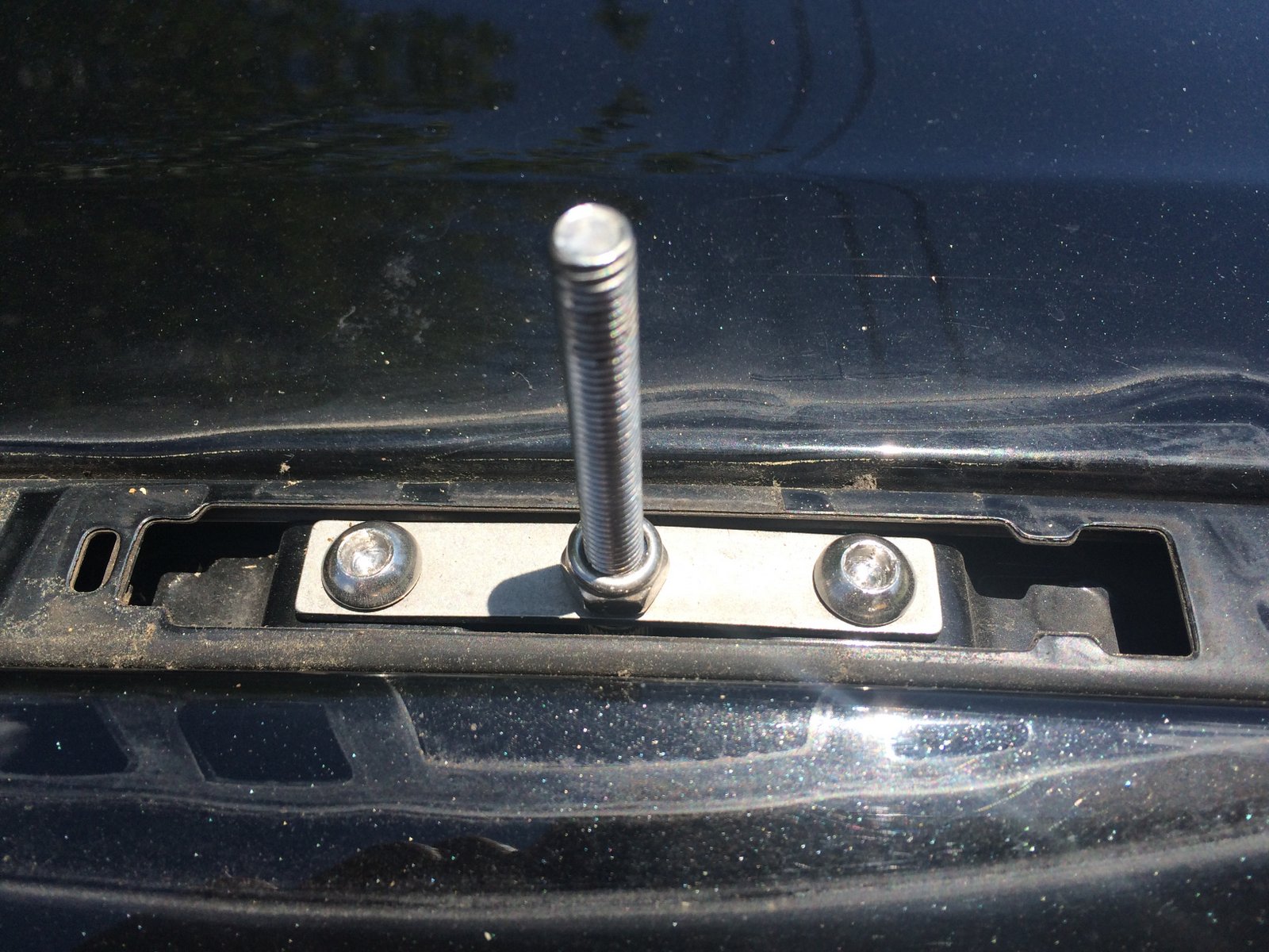

Step 1:

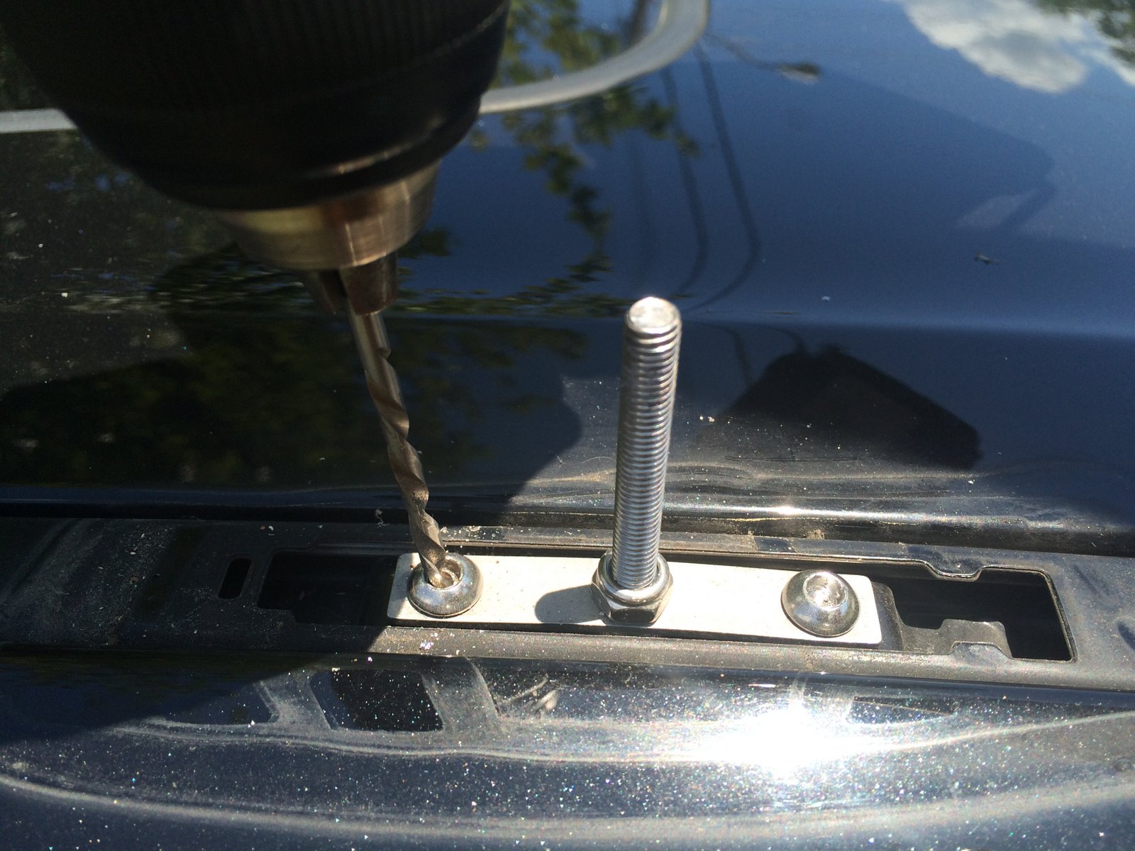

Get direct access to the stripped bolt. In the case of the OE accessory roof racks, remove the racks so the mounting hardware is accessible. Set your drill to Reverse so it rotates Counterclockwise. This is crucial and the drill should remain in this reverse rotation the entire process. For using the drill bit, also set the drill to the highest torque setting for drilling and higher speed setting. Insert the drill bit size that is suitable. In my case, I used a 9/64 drill bit. Make sure to always wear eye protection when using a power tool like a drill.
Step 2:
Center on the rounded Allen head and drill in high speed. Use light to moderate pressure and make sure that the drill bit is biting into the bolt and cutting into it. You'd see metal swarf (the shavings from the drilling) if it's cutting properly. Make sure to drill it straight and deep enough for your extractor bit to get into. In my case, I drilled about 4mm into the bolt.

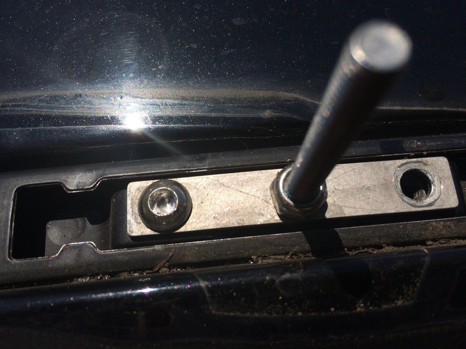

Using a vacuum or compressed air, clean out the metal swarf. Be careful in removing them as they can scratch the car's finish. Make sure the drilled hole is clear.
Step 4:

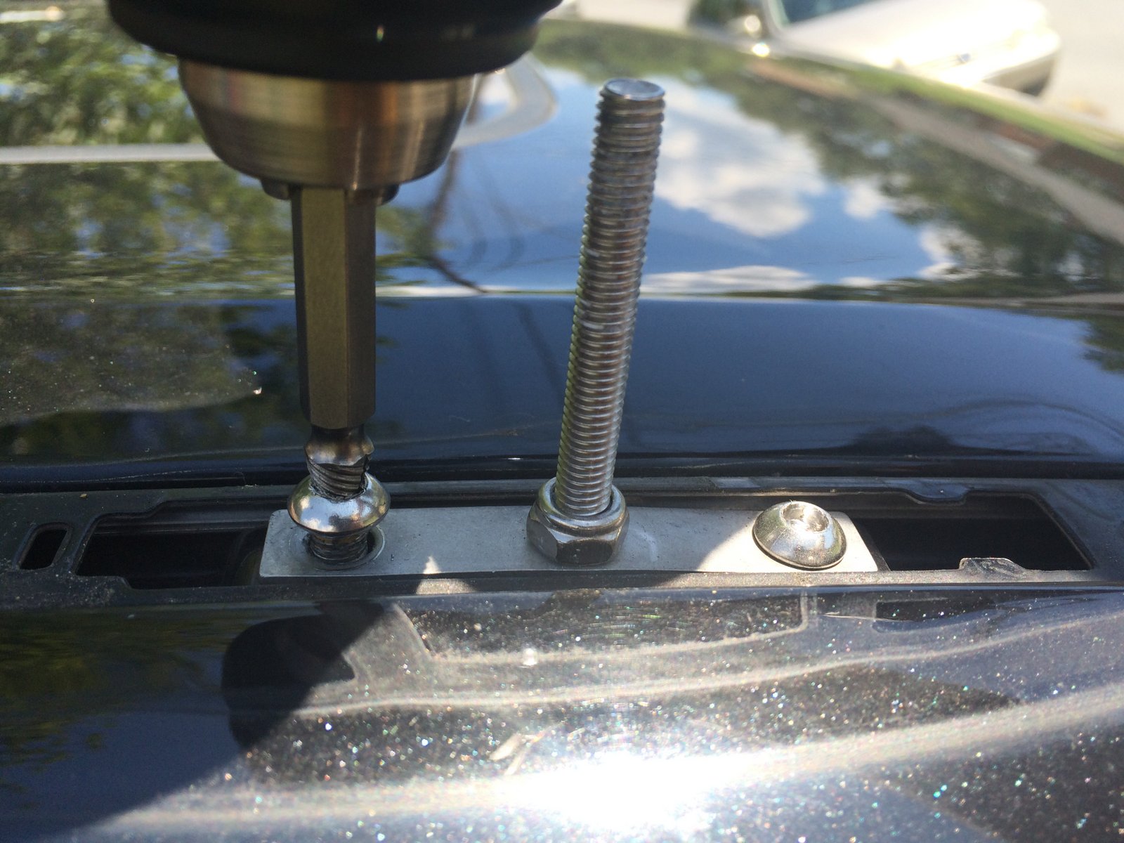

Remove the drill bit from the drill and insert an extractor of the appropriate size into the drill. Use the extractor head (swirled cone side) if it's double-sided. In my case I used a #3. Set the drill to the low speed setting.
Step 5:

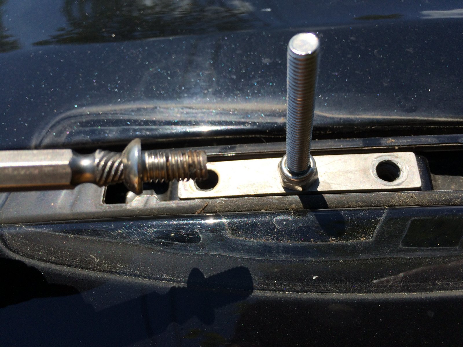

Insert the extractor head into the hole you drilled. Make sure it fits snug. Slowly start rotating counterclockwise. It's important to keep the drill speed slow. The extractor should bite into the bolt and start turning it loose, extracting it out.
Step 6:
Remove the bolt from the extractor bit. Sometimes it will require pliers to be removed.
You should have then successfully removed the damaged bolt at this point. In my case, all five rounded Allen bolts were removed with this technique and I was able to put my mounting covers back on. My Kizashi now looks odd, akin to seeing a man with hair one day show up to work completely bald. Regardless, I'm looking forward to the quieter freeway ride and better fuel economy from removing the roof racks when not needed.
