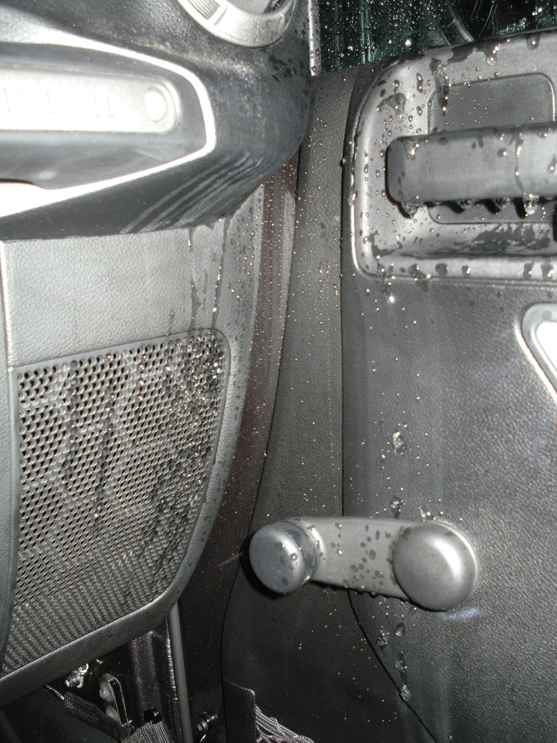

:lol: It's pretty obvious where the Heep's musty stink was coming from ...poor bastard that bought the thing with all the rain we've had this summer!
53400452 (Large).JPG (280.53 KiB) Viewed 5081 times
