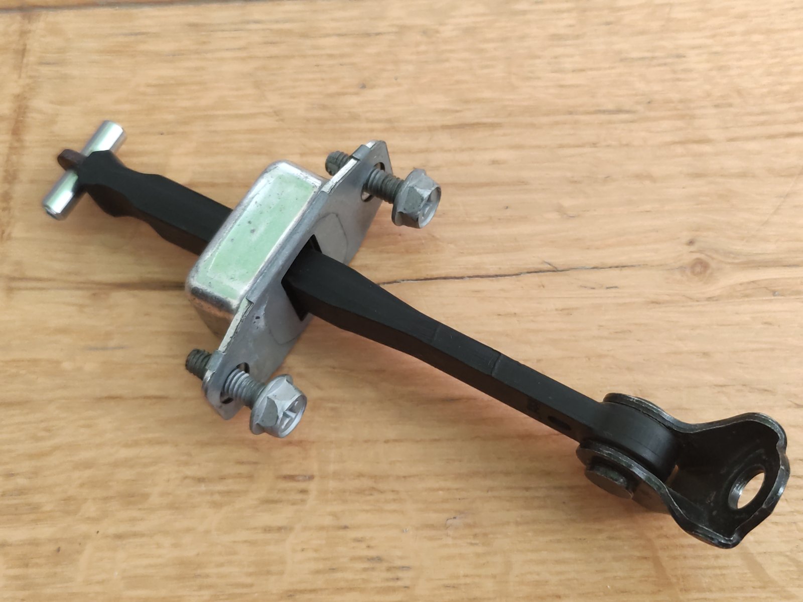

You just need to replace door limiters. Just did this on mine. Now doors are holding its position solid as a rock.

There are also two other options:
1) replace only 2 worn out plastic pads inside each door limiter.
2) add a 0.5-0.75 mm shim between plastic pad and rubber cushion . Just remove 2 screws, unfold 4 metal tabs, and you will see central plastic rod squeezed between 2 sets of plastic pad and rubber cushion. Repair is easy, took about 30 mins per door.
