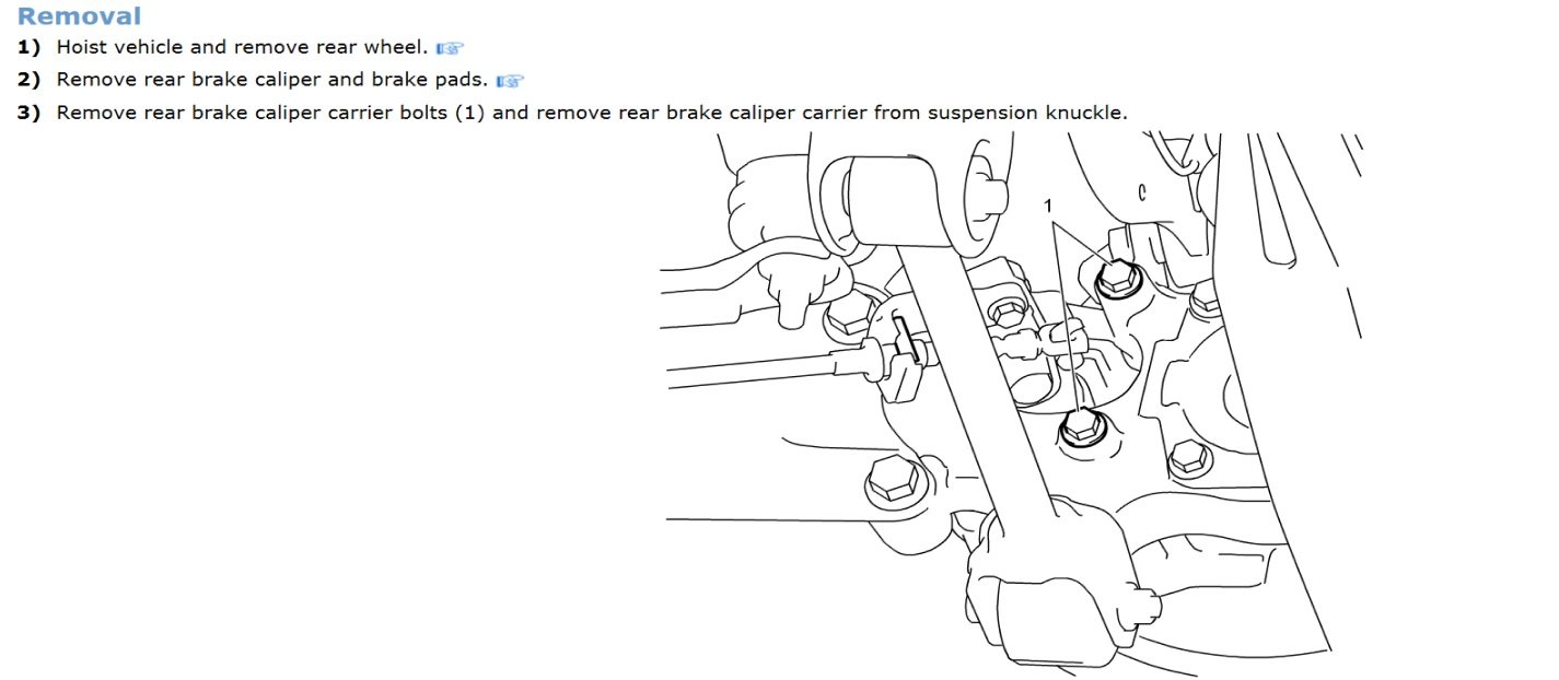

How do I get this off? I've removed the caliper, but need to remove the bracket to get the rotors.
Any help.
bdleonard
Posts: 274
There are 2 bolts on the back side that hold the bracket in place, remove them and the bracket comes right off
probably you need breaker bar to do that
