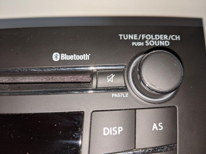

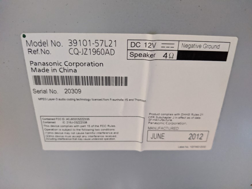

The 2013 SE AWD had a non-Rockford head unit with Bluetooth, which should drop right in. I know because that is what was in my car until I replaced it with an aftermarket Android Auto setup. You wouldn't have the steering wheel controls for the phone functionality (and I have no idea if the microphone exists in the cars that didn't come with Bluetooth), but the other audio controls on your steering wheel should work fine (volume, source, mute, etc) . The part number is 39101-57L21 . For quick photo identification the face plate, below the mute button is PA57L2BasicRef wrote:Hey guys. Brand new owner of a bone stock 2012 Kizashi. Price was right, so were the miles and she's an upgrade over my 2004 Trailblazer. One of the things that almost kept me from buying is the complete lack of any way to stream music from my phone to the car. No aux, and I have the factory headunit with no bluetooth. All I have is the USB in, which does not work with my phone. No matter which option I choose (Mass storage, File transfer etc) it says "USB UNSUPPORTED".

Here are some identifying pictures of the unit used in my car:
- Face Plate.jpg (96.56 KiB) Viewed 5404 times
- Label.jpg (75.56 KiB) Viewed 5404 times
