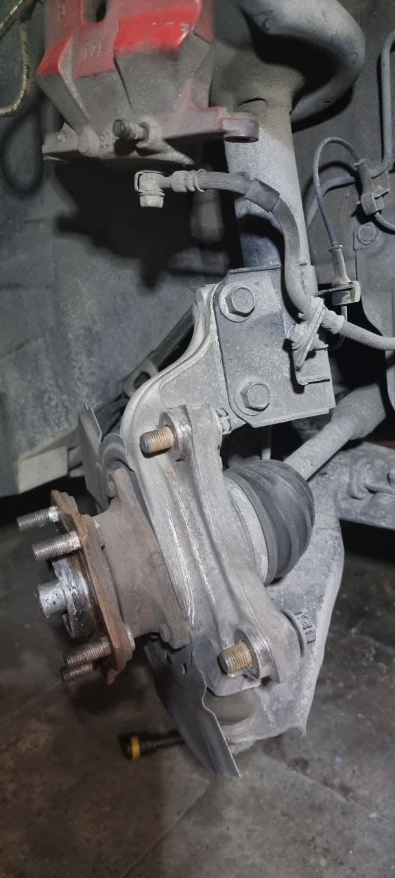

problem: steering shakes when I hit the brake pedal especially when the rotor is hot.

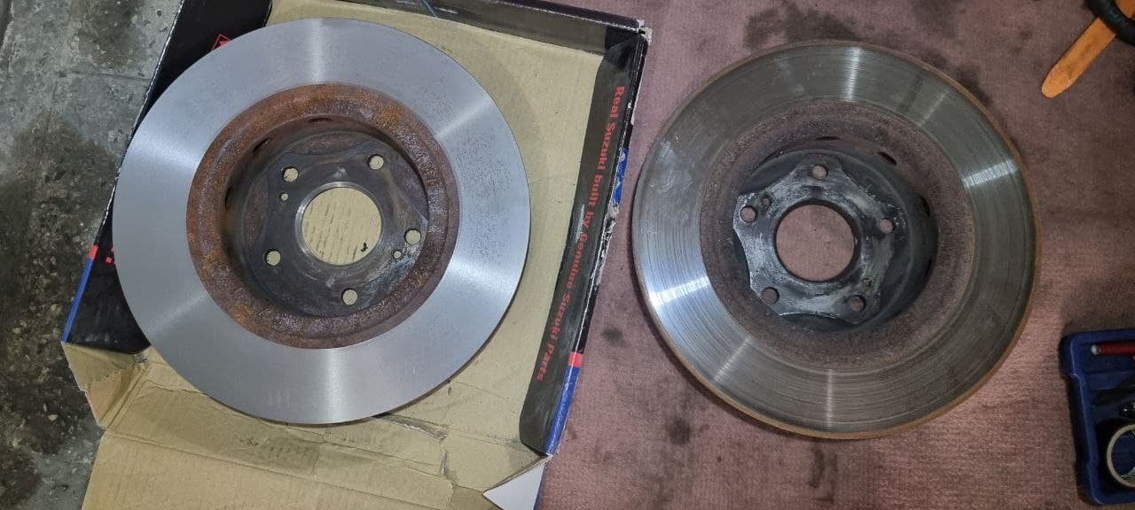

History: last year I bought 2 front rotors (OE) and install those after 3 months in summer I guess, I noticed a steering shake when I pressed the brake pedal I changed the passenger side rotor with the old one, and the shaking stopped. last week I took rotor to shop to repair and resurfaced the rotor then install it on my car with new brake pad also.
I am planning to do the same for the driver's side too.

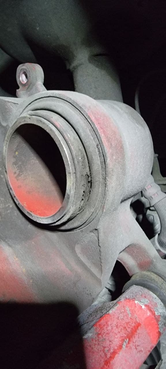

and I noticed the caliper boot is worn but not much so I decided to leave it alone for now.
rotor thickness after resurfacing: 26mm[1.02 in] (24mm[0.94 in] is the limit)

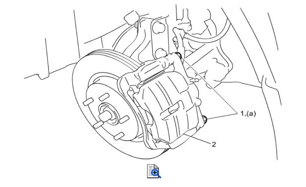

Tightening torque
Front brake caliper carrier bolt (a): 155 N·m (15.8 kg-m, 114.5 lbf-ft)
1 - Copy.jpg (26.11 KiB) Viewed 4296 times
Front brake caliper pin bolt (a): 34 N·m (3.5 kg-m, 25.0 lbf-ft)

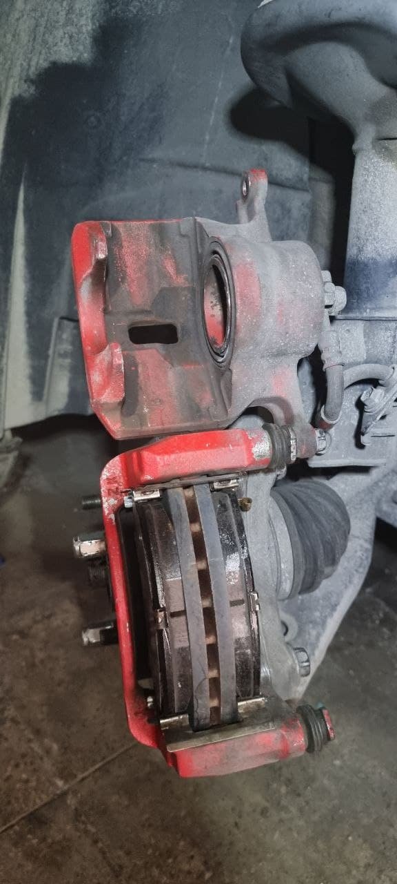

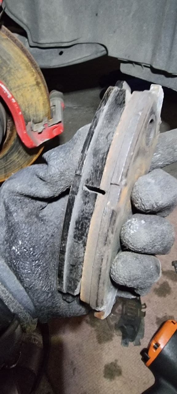

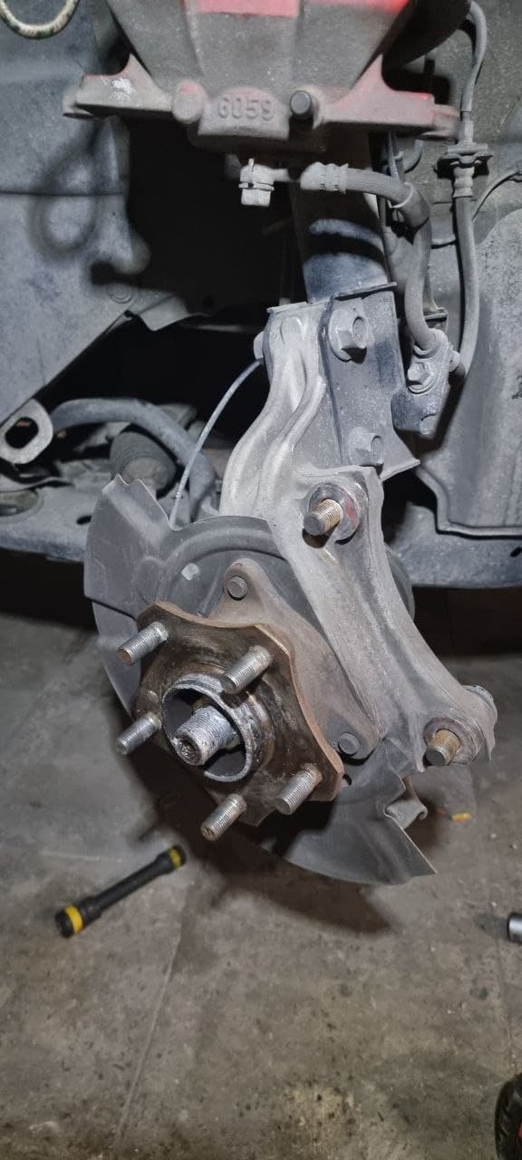

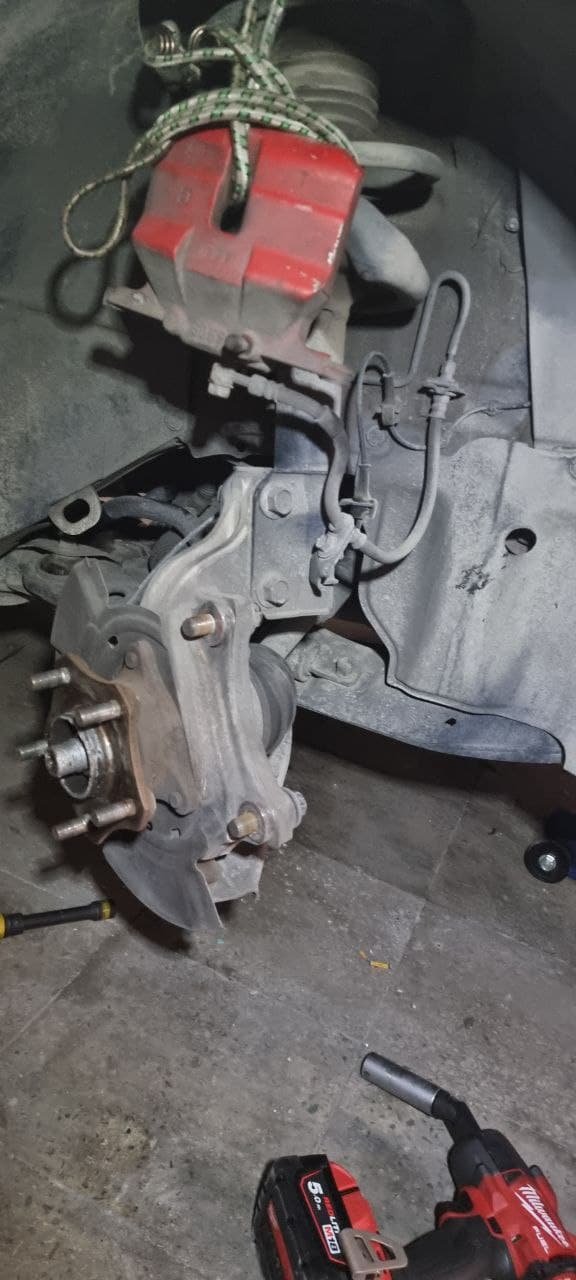

and some pics
