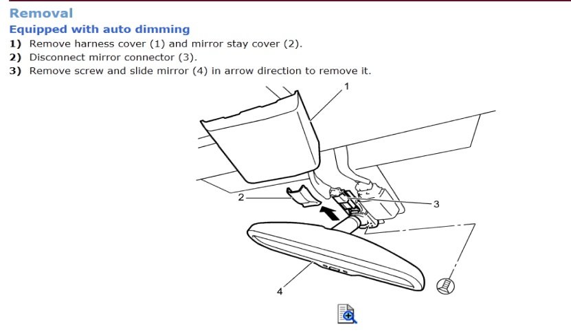

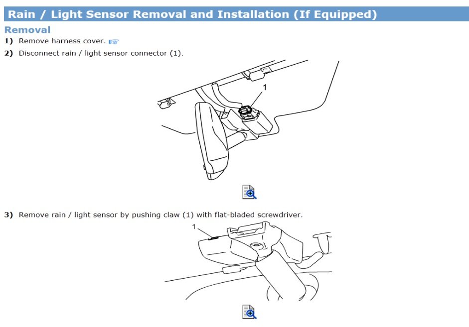

@Klaa$vaaK Removal instruction from service manual:

SAEED_KIZZY wrote: Tue Mar 08, 2022 6:38 pm @Klaa$vaaK Removal instruction from service manual:
Wow thats great, this is going to be easy!
