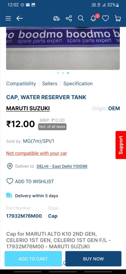

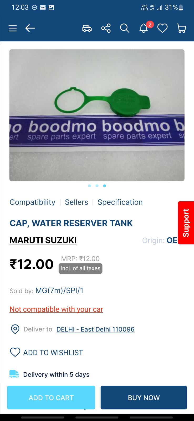

Hey I don't know if this is helpful but from what I've seen this part might work on the kizashi not hundred percent sure but I will be trying this out in the coming week as I also lost my cap and for now am using the cap of a coolant container and it work well but when doing heavy acceleration and rpm upwards of 4000 sometimes the collant spills out and the smell is not good.will update you by end of the week
