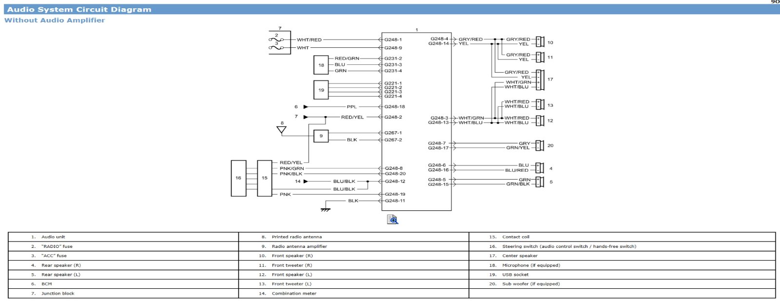

Hi again so today I noticed that boht my back speakers are dead.I have the non Rockfosgate system and used the radio to move audio balance to rear and had no audio coming.I will be getting the doors opened up in coming few days but wanted to know other possibilities for them dying.

Hi,
Remove HU and disconnect G248 connector(big connector) from HU and use simple multimeter in ohm mode and check the 6/16 pin for rear right speaker there should be around 4 ohm or 8 ohm if it open circuit you have blown speaker or wiring problem and should investigate by pulling the door panel out otherwise your HU is the source.
Also, do the same check for the 5/15 pin for the rear left speaker.

Hey thanks for reply I'm going to be honest I'm 19 with very little experience on cars and plus if I break something my parents will make me regret it
. I am confident with a multimeter but don't know any good mechanic close by with whom I'd be confident in opening my HU I think opening the door seems easier as I know that he as done it before once to fix a the window motor so I'm going to do that once but increase it doesn't work I'll try your method.Also is this chart form the html service manual?
