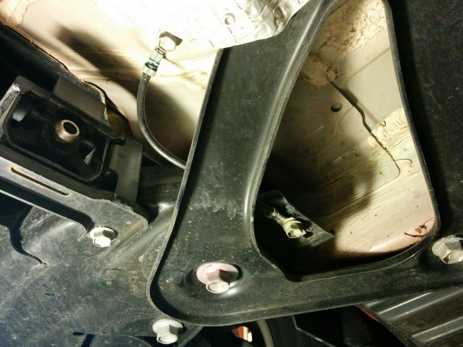

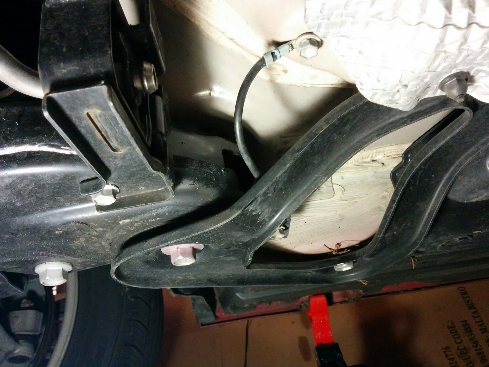

I found this ground point while under the car today. It grounds the subframe to the chassis. No heat shrink or anything protecting the crimped connections even though they're exposed to the elements. Might be worth upgrading
Interesting. Where exactly is it located? I've been under the car a number of times and never saw the ground wire.

bootymac wrote:I found this ground point while under the car today. It grounds the subframe to the chassis. No heat shrink or anything protecting the crimped connections even though they're exposed to the elements. Might be worth upgrading
Great find! This would probably be quite important for us in the salt-prone parts of the world. :o
Judging by the pictures and the ball joint in the second shot, I'm going to hazard a guess that this is on the passenger side just inside of where the front jack point is.
But something tells me you'll need to remove the under trays to find it.
