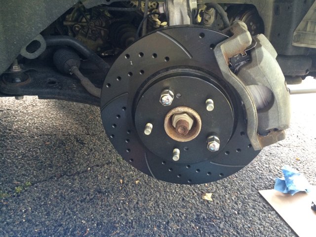

The front center worked fine for me. I used jack stands on the sides. I installed the front brakes and rotors.
I will do the rear tomorrow. Hopefully it will work on the center point since I have a low profile jack. If not I can lift it up on one side, put the Jack stand on and then left the other side and do the same.
I'm leaving the painting for last, so I may just do one tire at a time since I don't need them exposed at once just yet for painting.

Are the rotors completely painted?
