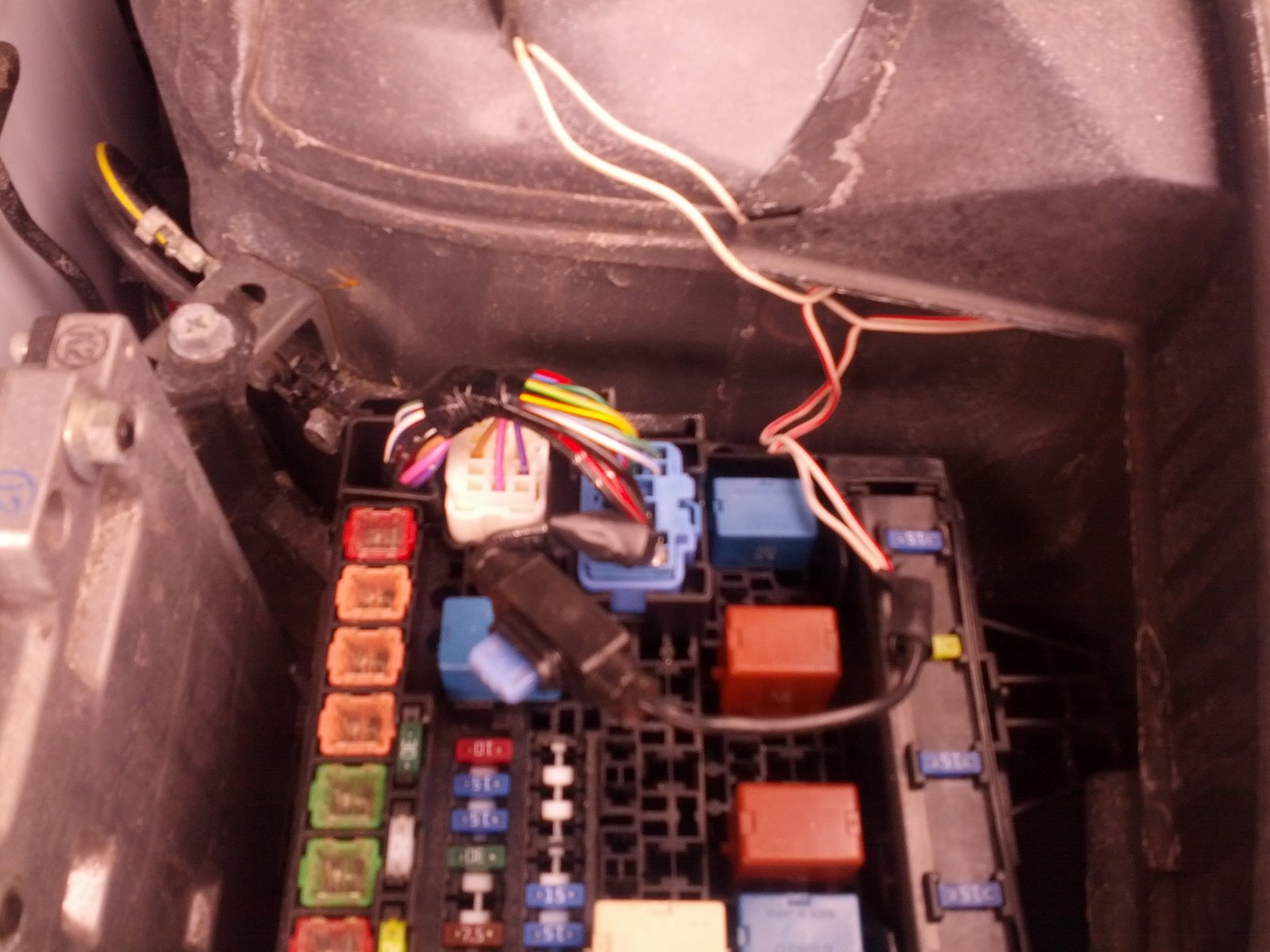

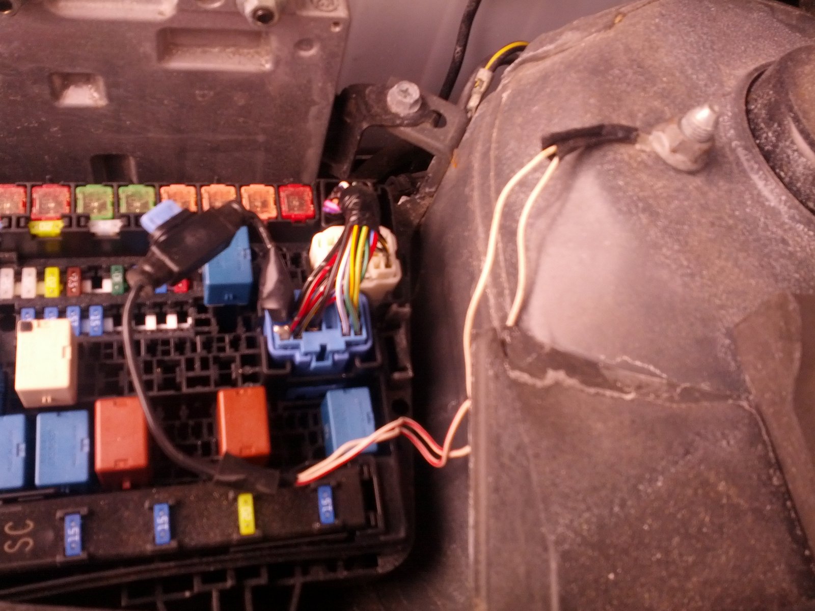

binarycow wrote:Pittsburghjoe, I might be able to deal with the stock DRLs staying on, if I could wire the LEDs to be always on. How did you do it? Keep in mind I'm totally NOT a car guy or an electrical guy.
Sent from my HTC 8x using Tapatalk
Hi Binary,
I'm working all day today but I can open the hood and take a pic tomorrow. It was pretty simple and I'm not a big electrical guy either. If you don't see a pic by tomorrow night feel free to message me direct and pester me until I do it. I'm excited to try the ridiculously long and complicated method of getting the stock DRLs off without disabling the high beams. I hope it works.
Joe
Ok, so it took 2 days but here you go. Let me know if you need any clarification. I know there is probably a better way to do this but I don't know what it is and this way works so try it if you like.
Joe
That looks almost identical to where I hooked my DRL's up to. :)

murcod wrote:That looks almost identical to where I hooked my DRL's up to. :)
Cool. That makes me feel better about my work. Did you ever try that long system of turning off the factory DRLs? I'd like mine off it it works but haven't had time to try it yet.
