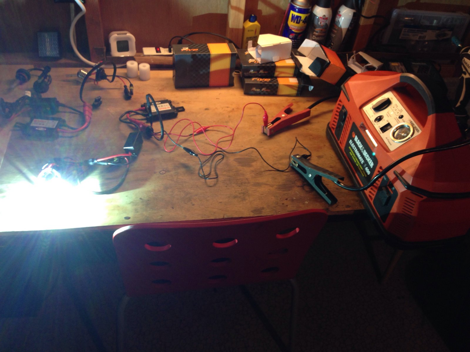

I also tested my old low beam HID system that I had before I replaced them with Morimoto HIDs. I replaced the whole kit when one side went out because I wanted a better kit.
However, with HID kits, you need to determine whether the failure was the bulb or the ballast. I decided to do this once the kit was removed from the car to see if I can reuse the ballasts.
The simple test I did once the kit was removed was to hook it up to a 12 volt jump starter. I connected the positive terminal clamp to the positive wire that goes to the ballast. Negative to the negative. I used lead wires I bought at HFT since the jumper's clamps were too big.
In this fashion, I tested both ballasts and both bulbs and determined it was a bad bulb, not a ballast. I plan to reuse these good ballasts in my fog lights since one of the fog light ballasts appears to perform differently from the other, causing a difference in color output.
Given my bumper is coming off for the LED capacitor harness install, I'm going to swap fog light HID ballasts then as well.
I will discuss these topics more in detail in their respective threads once the installations are done.
