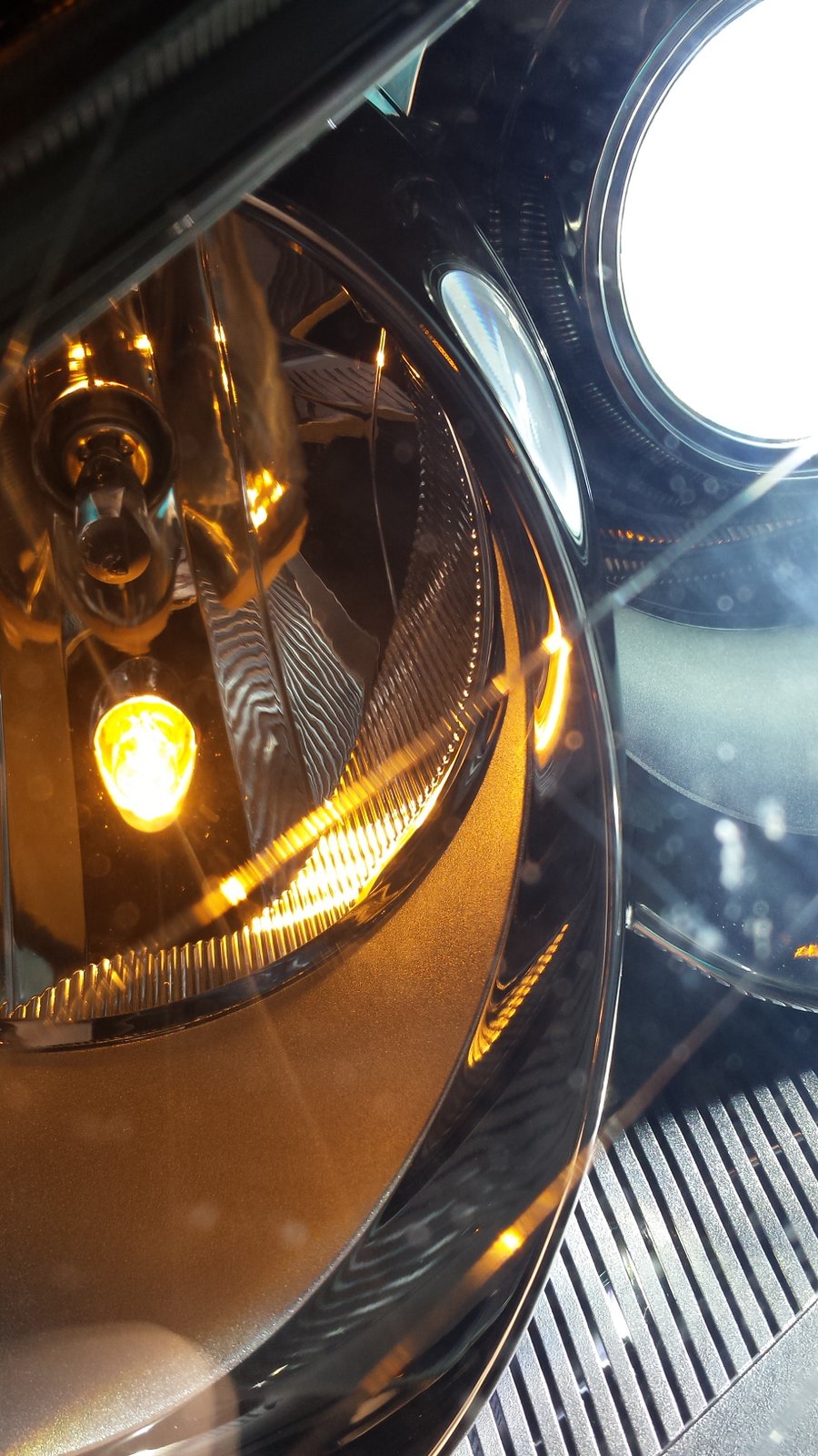

Interesting you say that. Mine does not appear to be set up that way. I have 3 separate bulbs. Low, high, and DRL. My DRL never turn off no matter what combination of low/high/off I try. When the car is on, so are the DRL. Am I missing something here?? You can see my very yellow DRL in the pic. High beam bulb is above it, off. Low beam are on in the right side of the photo.
Sorry, picture posted sideways. High beams are to the left of the DRL in the sideways pic. Low beams are on top.

Well that's different and actually something I want to do. The stock DRLs are the high beam H7 bulbs at a lower voltage.
Did you buy your car used? I wonder what was done to achieve that
