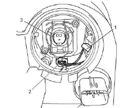

The H7 bulb electrical connector base is sealed inside- surely that's what kizsls is talking about? There's a special OEM plug that is the only external electrical connection and contains all the wires for the headlight's bulbs (indicator, tail, low beam, high beam) in the one plug.Woodie wrote:The factory bulb connector IS outside the housing.
I haven't seen the kits, but I'd imagine the H7 bulb connector would plug into a loom that runs to the ballast and then the HV wires run to the new HID bulb? As mentioned you need to somehow run the H7 loom wires externally to the ballast and then the HV wire back in to the bulb. Sounds like drilling holes would be required?
- Note custom OEM electrical plug on lower RHS of picture.

Yup, you got it right. I have a HID kit so I can tell you from firsthand experience. I did not install the kit (came with my pre-owned car), but I have personally installed a HID kit on my old car before.kizsls wrote:I have a set of HIDs on the way and understand the procedure to remove the bumper to get at the lights, mount the ballasts etc. But there is one thing that doesn't make sense to me...
How do you run the wiring for the bulbs out to the ballasts and then back in without making a hole? I keep seeing people say there is no modification or access hole needed to be drilled for the wires. How is that so if everything is inside the headlight housing?
Common logic tells me that I would have to plug the factory bulb connector into the power input for the ballast, which would have to route outside the headlight housing to where the ballast is mounted and then back into the housing.
Your ballast is unlikely to fit inside the headlight and I would strongly advise that you do NOT try to bake your headlight, break the seals, and open your headlights.
It's much better to mount your ballasts under the headlight via 3M double-sided tape or mounting brackets if the kit comes with them.
You will need to drill a hole unless you don't want the bulb cap on the headlight (not advised). I would advise to drill a hole in the cap to get the rubber grommet in which contains the 4 wires (2 to ballast and 2 from ballast).
Look at these photos of my headlight in the link below. (The tutorial is not for a HID install, but related to the headlight and shows my HID wires going into and out of the headlight.) You will see how it works for my kit which confirms what you thought you'd have to do.
I have also read on this forum that drilling is not necessary, but I don't understand that logic. Unless the entire kit is housed within the headlight, the wires need to run in and out. If you want the headlight to still be sealed (strongly advised) then you need to drill and have rubber grommets around the wires as seen with my kit.
