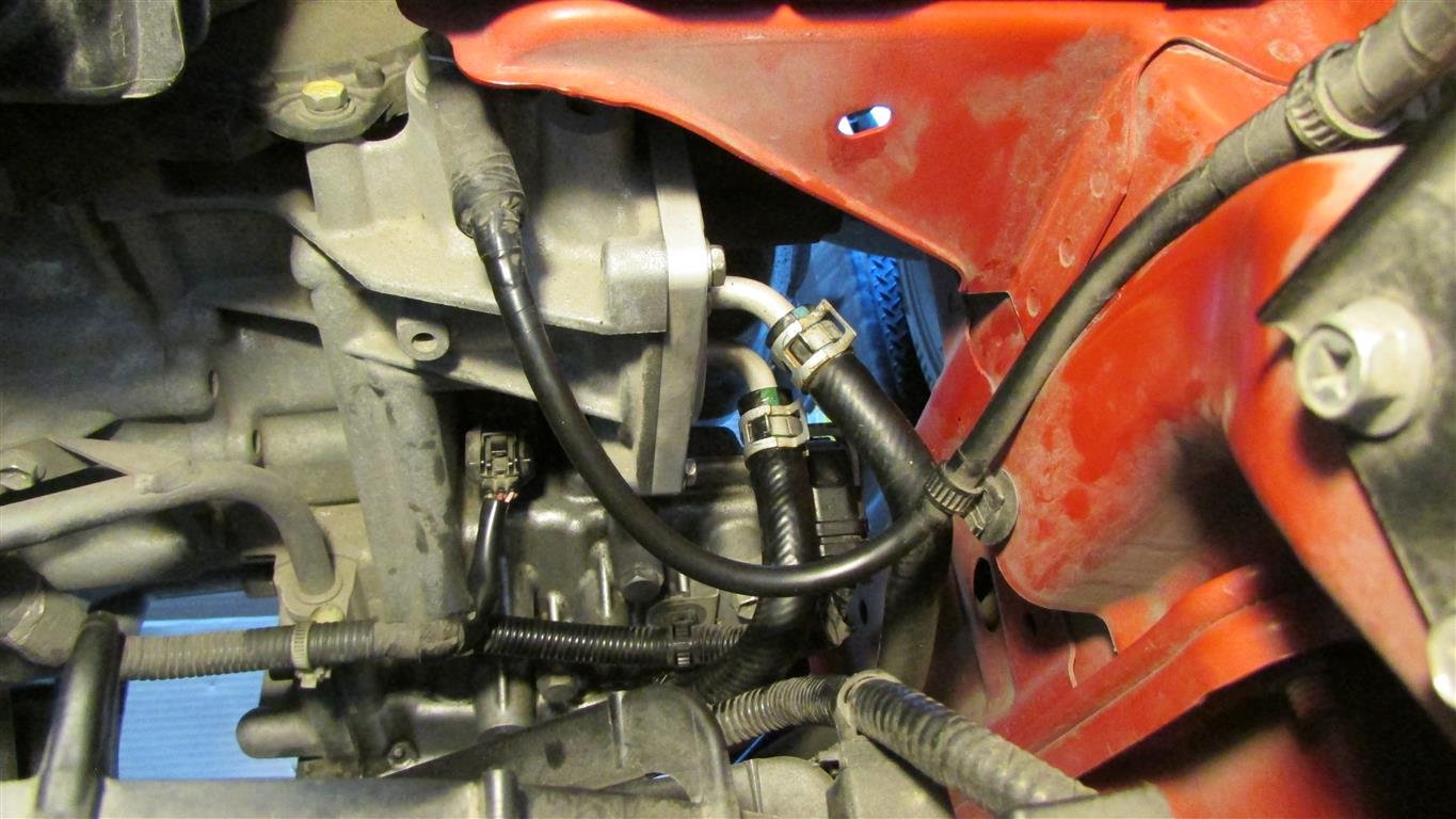

First drain of factory fill. 54,816 miles. Wife drives like a grandma. Same Jatco trans as the Kizashi however, the SX4 is much lighter and less powerful than the Kizashi.
IMG_1793 (Medium).JPG (89.75 KiB) Viewed 17031 times

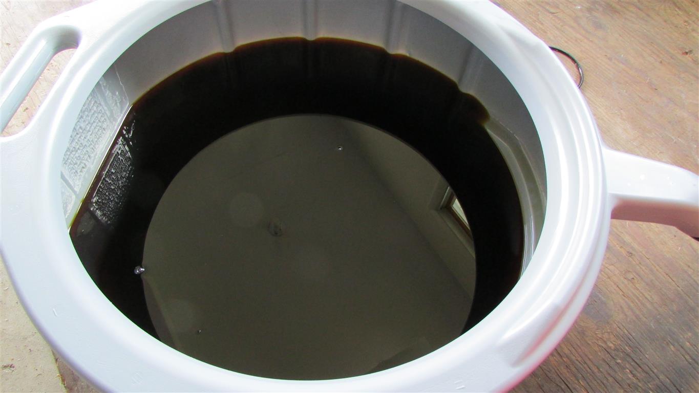

I will say it was much cleaner than the last of the 3 drain/fills I'd done on the Kizashi at ~80k miles last fall. I could see through the fluid as it was draining w/o too much difficulty. More of a pain in the azz to get to the cartridge filter though. Only doing a single drain fill on this one. battery and battery tray had to come out. ECM is attached to battery tray as well.

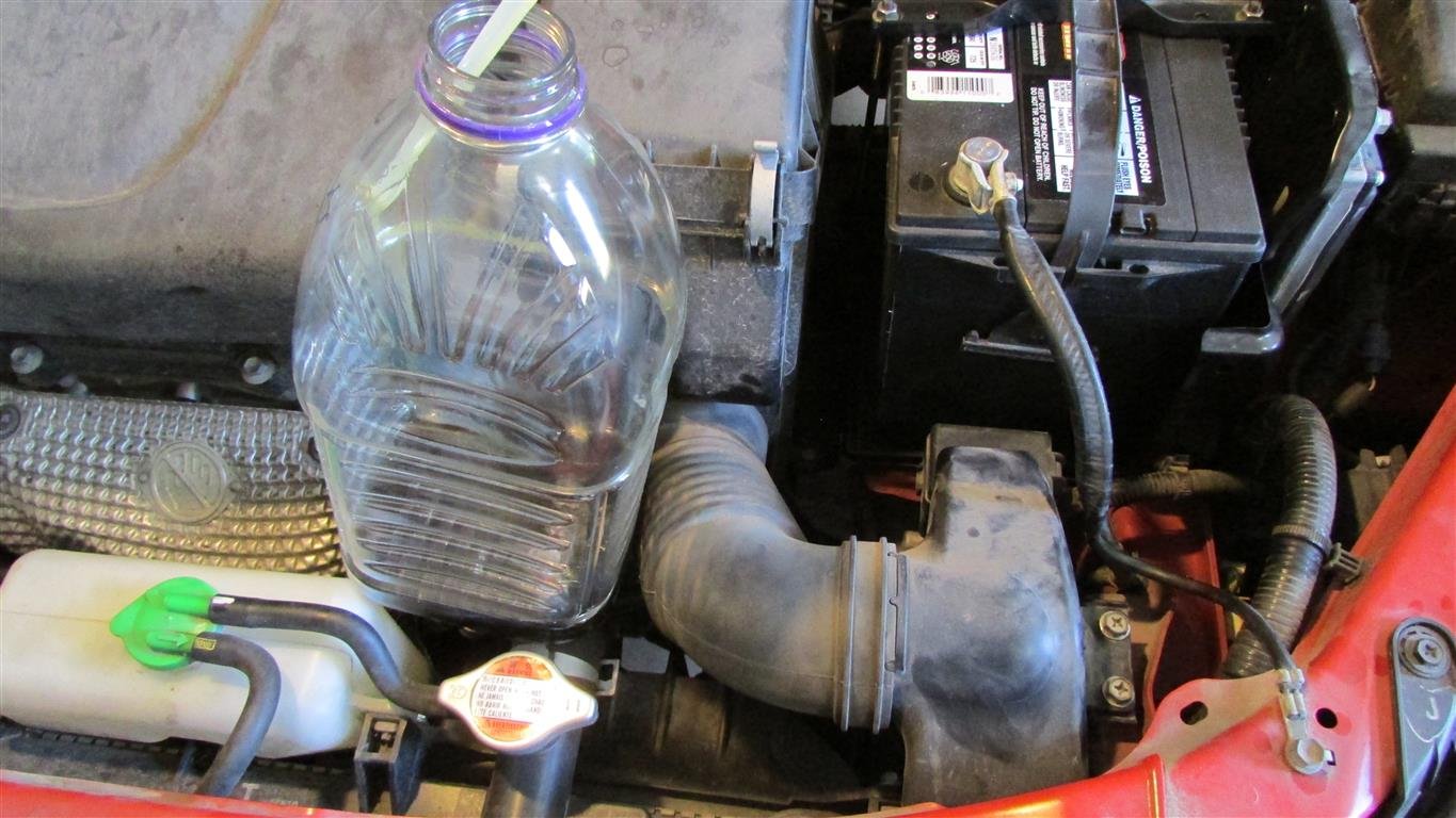

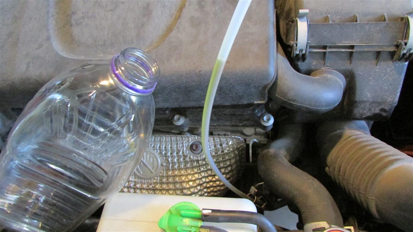

After letting it cool down overnight, post hi-speed / hi-R's / manual shift test romp, it appears I overfilled it a tad bit...setting the level from an overfill sucks...literally.
IMG_1795 (Medium).JPG (141.15 KiB) Viewed 16991 times
IMG_1796 (Medium).JPG (169.66 KiB) Viewed 16991 times
I suppose this is how one can "inspect" the fluid's condition per service manual. I personally prefer just draining it, as this method is painfully slow and really, really...sucks.
