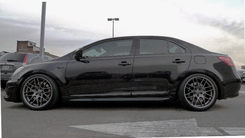

And for the topic at hand:
  • Wheels: VMR model VB3
    Offset: ET45
    Lug: (custom drilled to 5x114.3)
    Tires: Delinte D7
    Drop: Custom
    Alignment: OE spec
    Notes: No pulling. No cutting. No rubbing. (Liners pulled)
